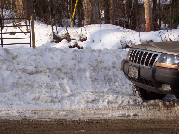

I didn't know the viscosity difference between the two. How about the tranny fluid? About how much does each hold? Can't find my manuals...Thanks. It might get up to 40 here next week. Whoopie....Heres a pic from the end of my driveway today at my cabin..

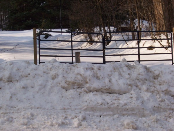

Another....
