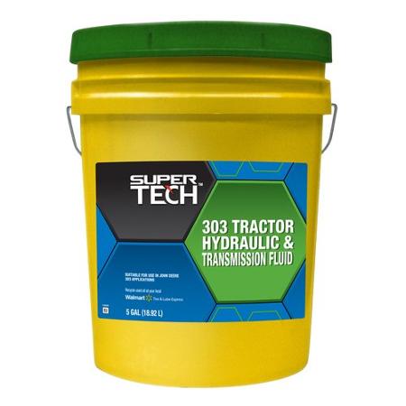

Are you thinking of going cheap at Walmart? They even admit it's not that good.
SuperTech 303 Tractor/Hydraulic Oil - Walmart.com
