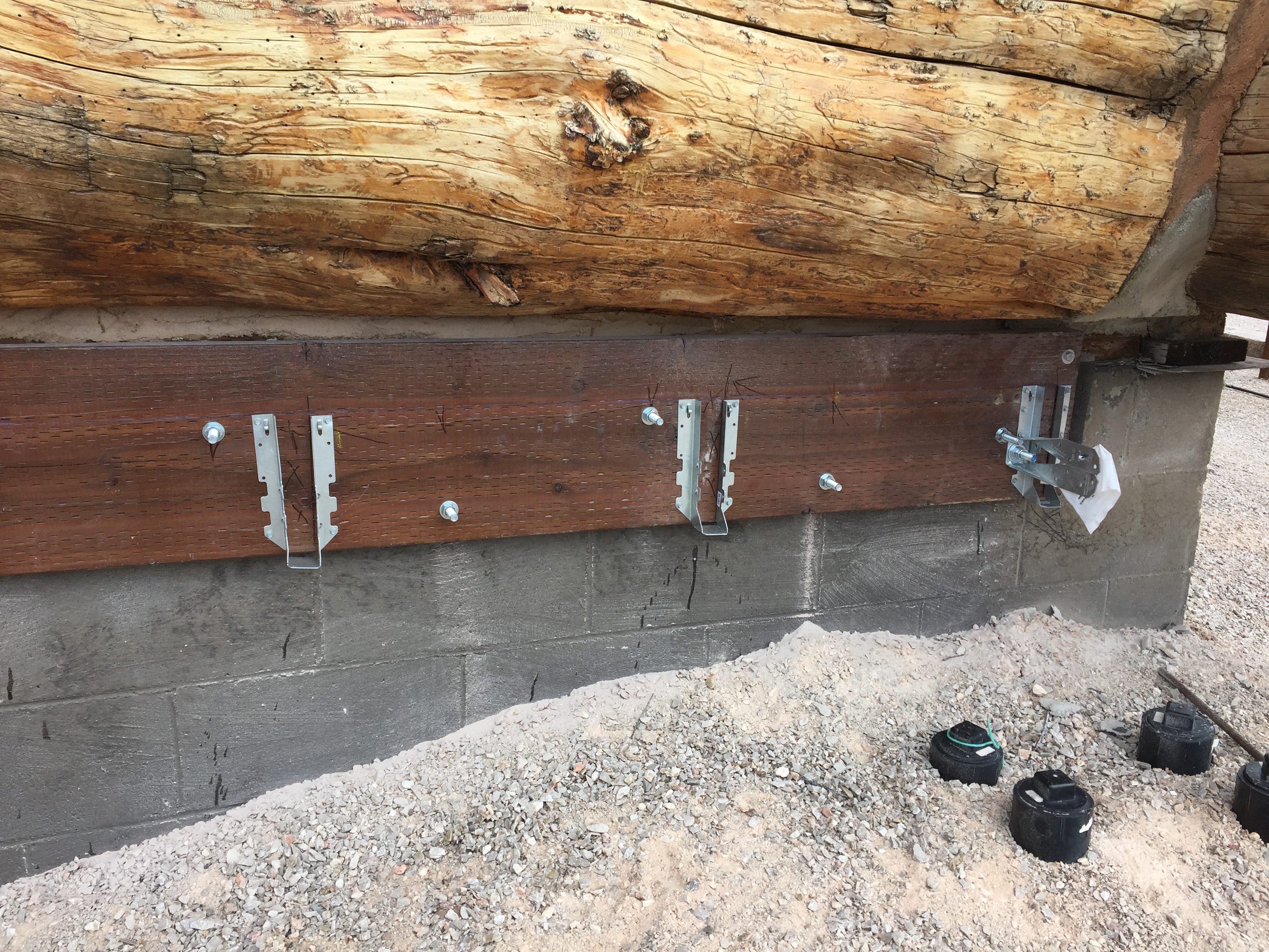

Bo, I was wondering what the extra bracket is for on the far right joist hanger? I don't have a ton of deck experience.
It’s a DTT2Z tension tie. The engineer calls for one on each end of the deck. It requires a through bolt (going through the block) vs. the redheads holding the ledger board. Something to do with shearwall.
Thanks for the education. :thumbsup:

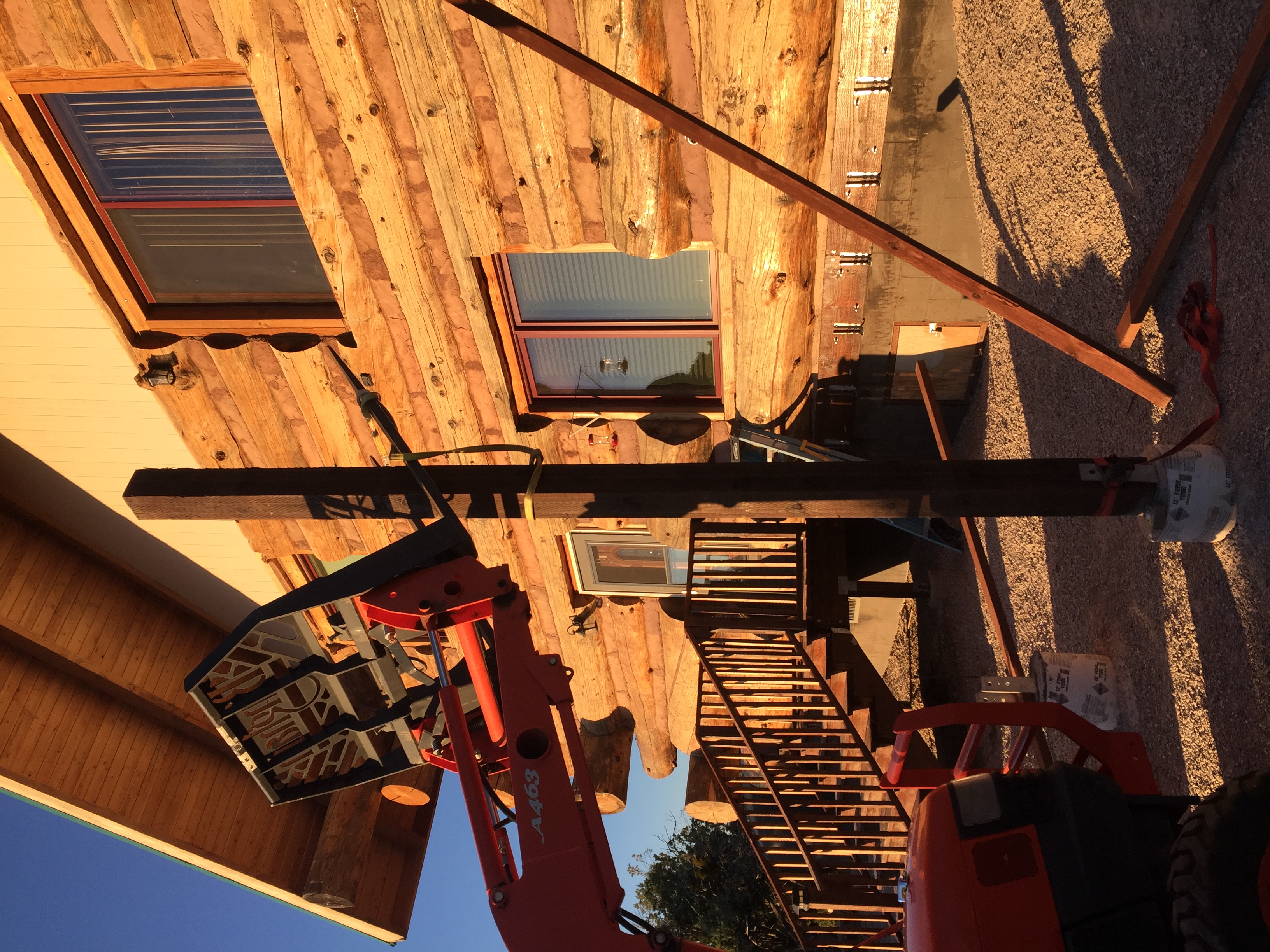

I picked up my 6X6 beams today, and started to set the first one. Easy with the tractor!
I have not secured it at the bracket yet and was wondering if the beam in the metal bracket is fine or should i slip a 6x6 piece of shingle under the beam?
