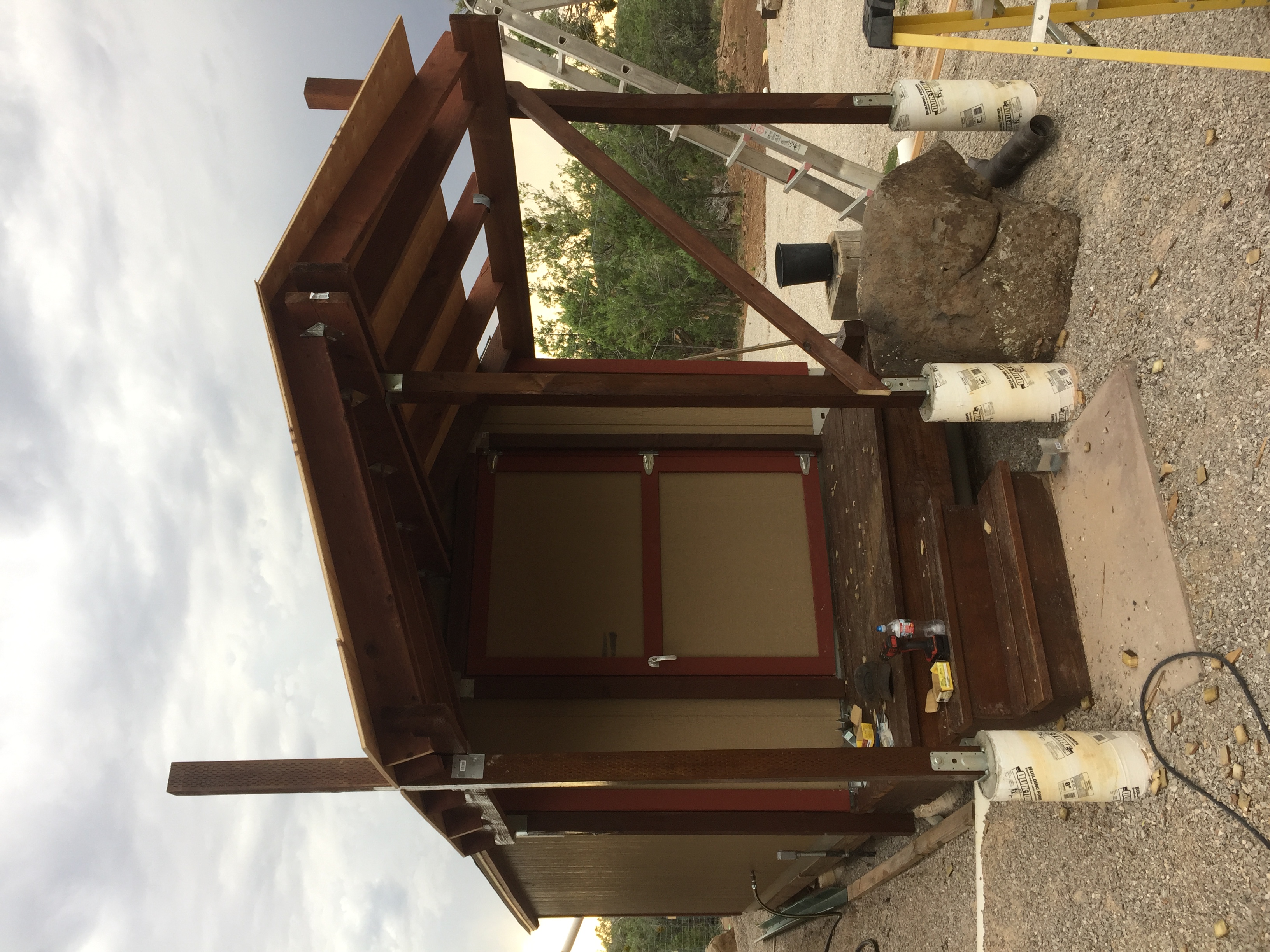

Sidetracked again. I put a roof on the porch of my solar shed. One year I could not open the door due to snow and ice. I have the felt on now and expect to shingle it tomorrow.

Nothing better then a porch to protect a door!!!!

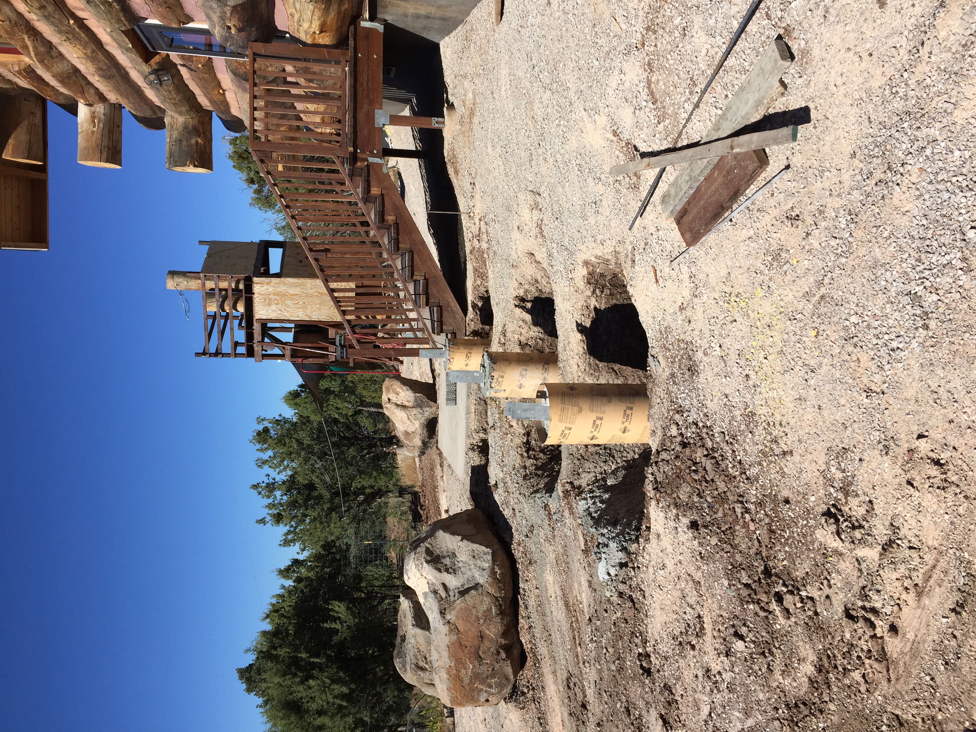

About a month ago I managed to get the footers done for my porch, before the cold weather. I probably will not do much more until March, but it was nice getting this part behind me.

So I'm going to use 6X6 beams to support both floors of my deck, and they will be bolted to the brackets I have in the top of my concrete columns. My question is how best to secure the 1st floor. My thought was that the 6x6's should run all the way up for best strength, but I don't want to notch my 6x6 uprights nor my 4x10 horizontal beam. Then one contractor told me you don't want to thru bolt it either. So I thought about using a 2-3 foot piece of vertical 6x6 on each post and then using a Strong Tie CC5 1/4-6 (or CC66) and setting the 4x10 right on top of the short 6x6's. Then use another Strong tie bracket to secure the 6x6 that goes between floors to the lower deck. But another contractor said I lose too much strength by not running the 6x6 as one piece all the way from the concrete pillar to the 2nd floor deck. Shall I fabricate some heavy duty brackets to bolt onto the 6x6 and have the 4x10 sit on them (and bolted)?

On the question of bolting your 6x6 for support. Look at the cross arms on power posts. these are 5X6 24' Length exposed to weather for years .
I have used these for under floor bracing in old houses where age allowed floor to sag and bounce with people walking
Got them used from power co. that had replaced after a storm and was rebuilding the power lines.
Knot free Spruce.
Suspect you already have a good idea on method . Now the building permit. will this need to be wrangled with or has the inspector been satisfied?
