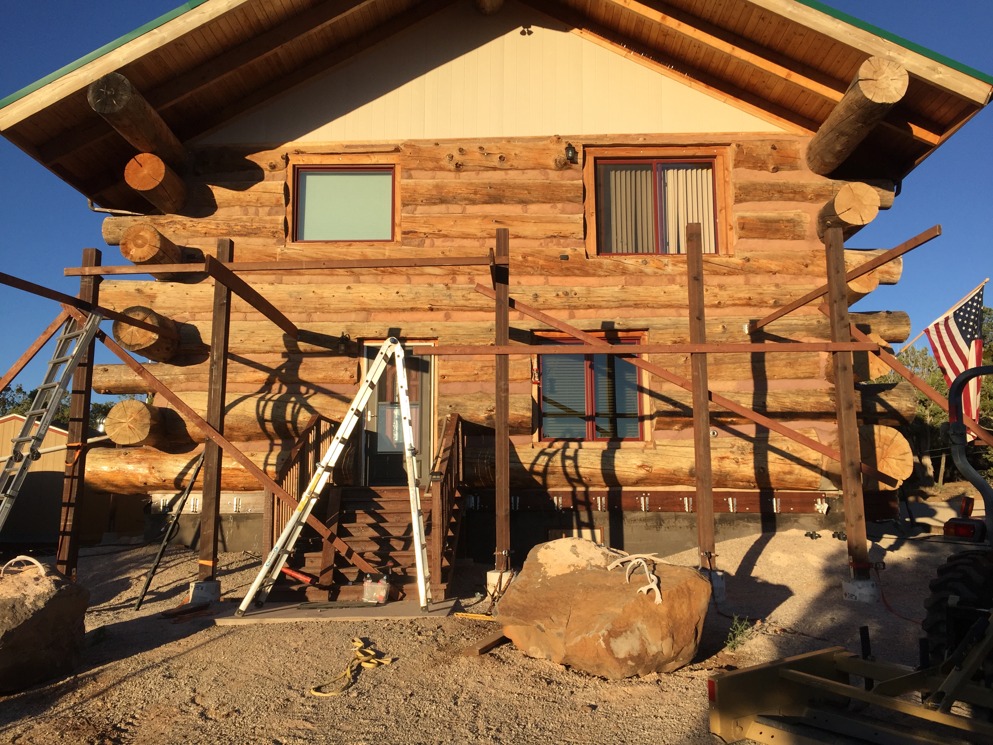

I just bolt them into the brackets. The brackets that I've used all have enough space under the post to allow drainage and air flow, which is the most important thing for stopping rot. What would the shingle accomplish?
   / AZ ranch
#1,132
I have always been told to put a layer of shingle on top of or next to the concrete block before putting PT wood against it. I put some behind my ledger board to keep the PT lumber from reacting with the concrete. I guess the steel bracket provides that separation. Just curious as to whether it would help with the bracket, or actually cause a problem.
Thanks Eddie.
   / AZ ranch #1,133
Leave the gap like Eddie said. It is intentional to avoid direct contact and water/rot problems with the end grain of the post
   / AZ ranch
#1,134
Okay, I will skip the piece of shingle. Meanwhile I got the other 4 upright beams done today. Next is the horizontal 4X10s.

   / AZ ranch #1,135
Posts look good. I think this is going to be a huge, and really nice, change to your entrance. Are you going to notch your posts to hold the beams?
   / AZ ranch
#1,136
I am not a huge fan of notching. I am going to use APA brackets and through bolts. (APA is the ornamental version of the A bracket). Either one is probably enough but I am going to do both. I have overbuilt most everything in the house, why not the deck, too?
