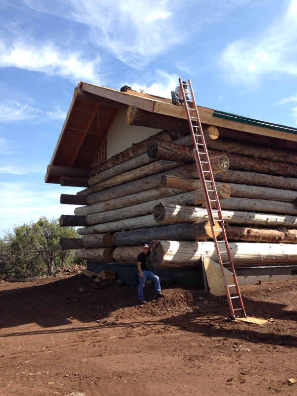

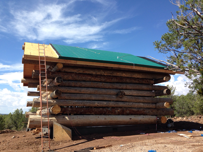

A couple before pics

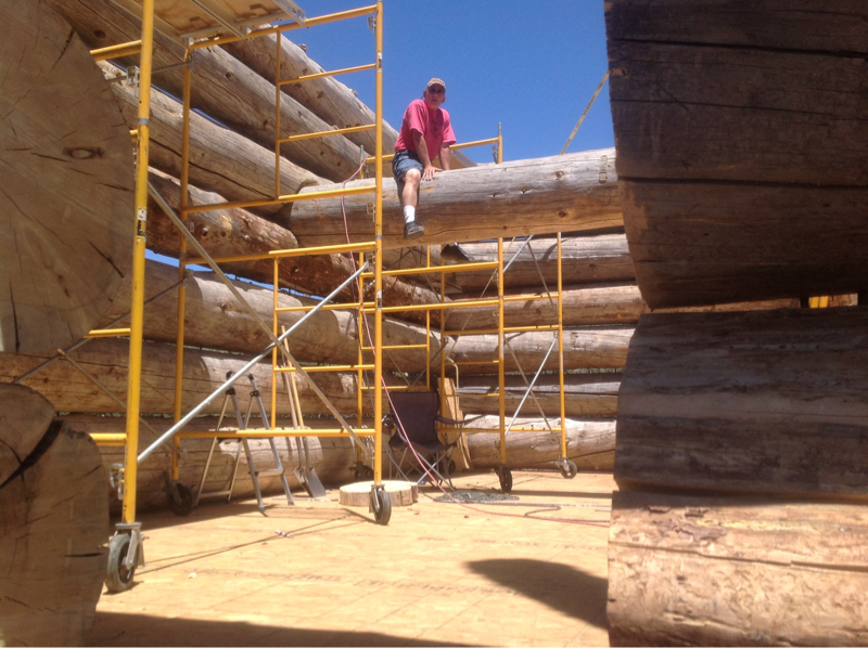

I was able to get one of the 16 foot ledger boards up today. Heavy board, climbing up and down scaffolding, trimming high spots with chainsaw,......
Whew, I am bushed.

Finished the other ledger board and I have half of the joists up. Slow and steady. I am 70 and working alone, so safety comes before speed. No deadlines makes it easier.
