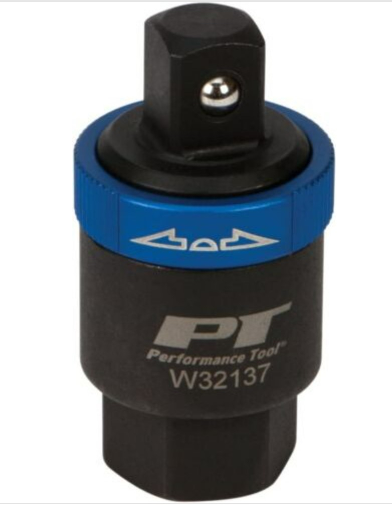

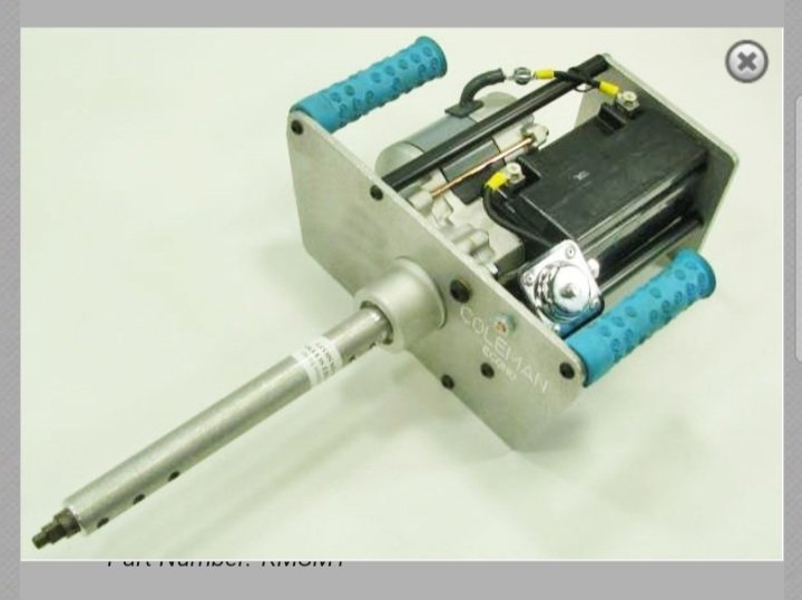

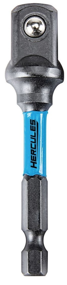

On pull start engines anyone use a ratchet adapter and socket to attach to a drill to start an engine after it sits for a while? I thought of this many times but hesitate to use one if the engine starting at a high speed would somehow reverse the ratchet with centrifugal motion and jam my wrist. I'd rather have 2 one-way bearing models, but I don't have them (if they exist)

I don't believe that would be good. My neighbor builds racing go cart motors and uses this battery,starter,solenoid all in one device. All you would need is the end piece that only turns in one direction.

On pull start engines anyone use a ratchet adapter and socket to attach to a drill to start an engine after it sits for a while? I thought of this many times but hesitate to use one if the engine starting at a high speed would somehow reverse the ratchet with centrifugal motion and jam my wrist. I'd rather have two one way bearing models, but I don't have them (if they exist)
View attachment 782699View attachment 782700
The one I expirmented with just unscrewed the nut that holds the flywheel on.... And yes I was spinning in correct direction to start/run....
