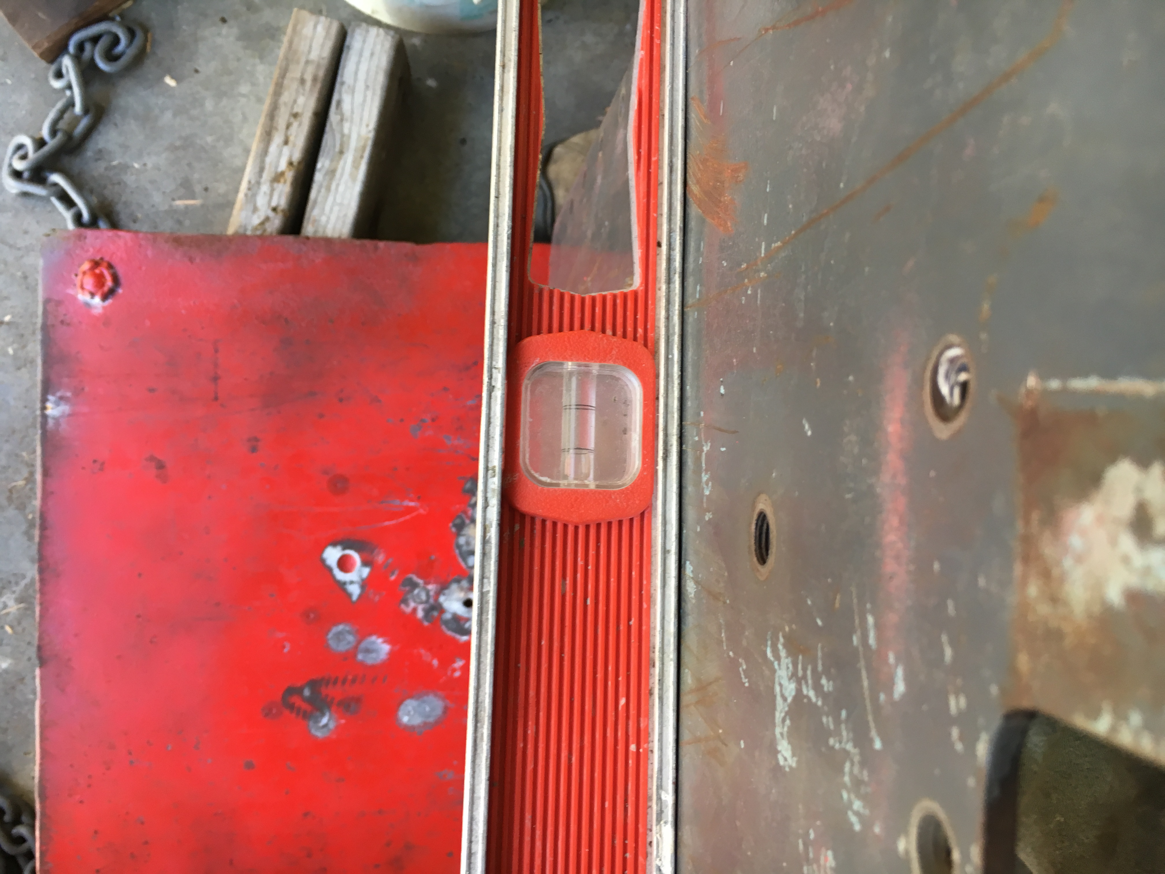

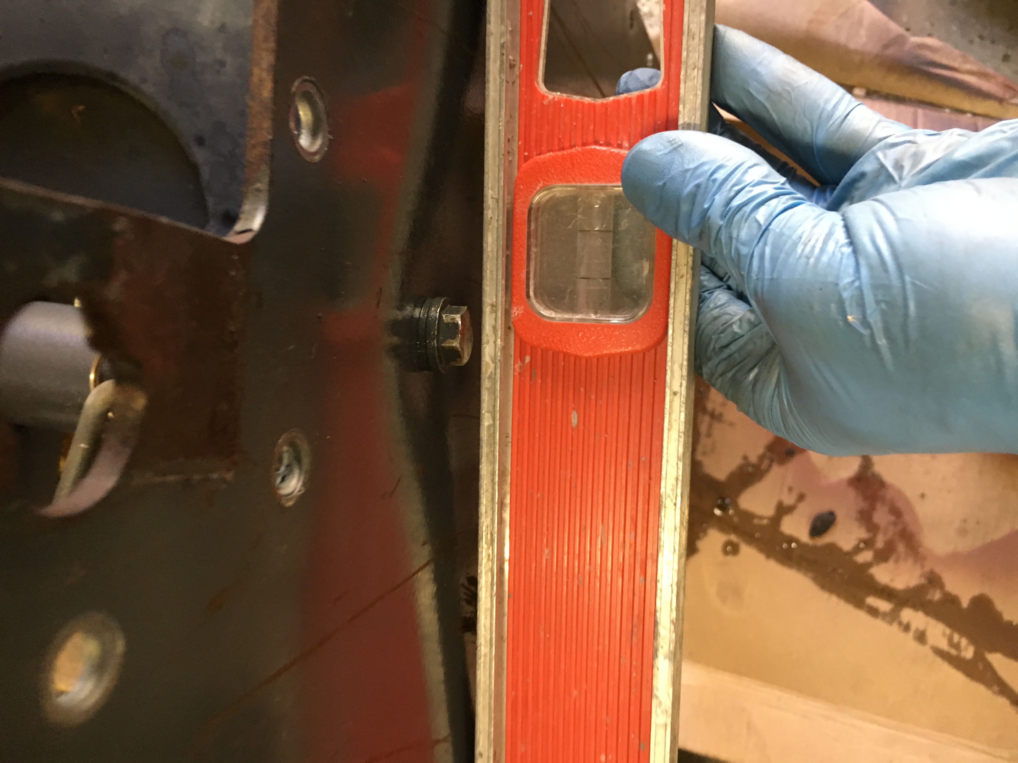

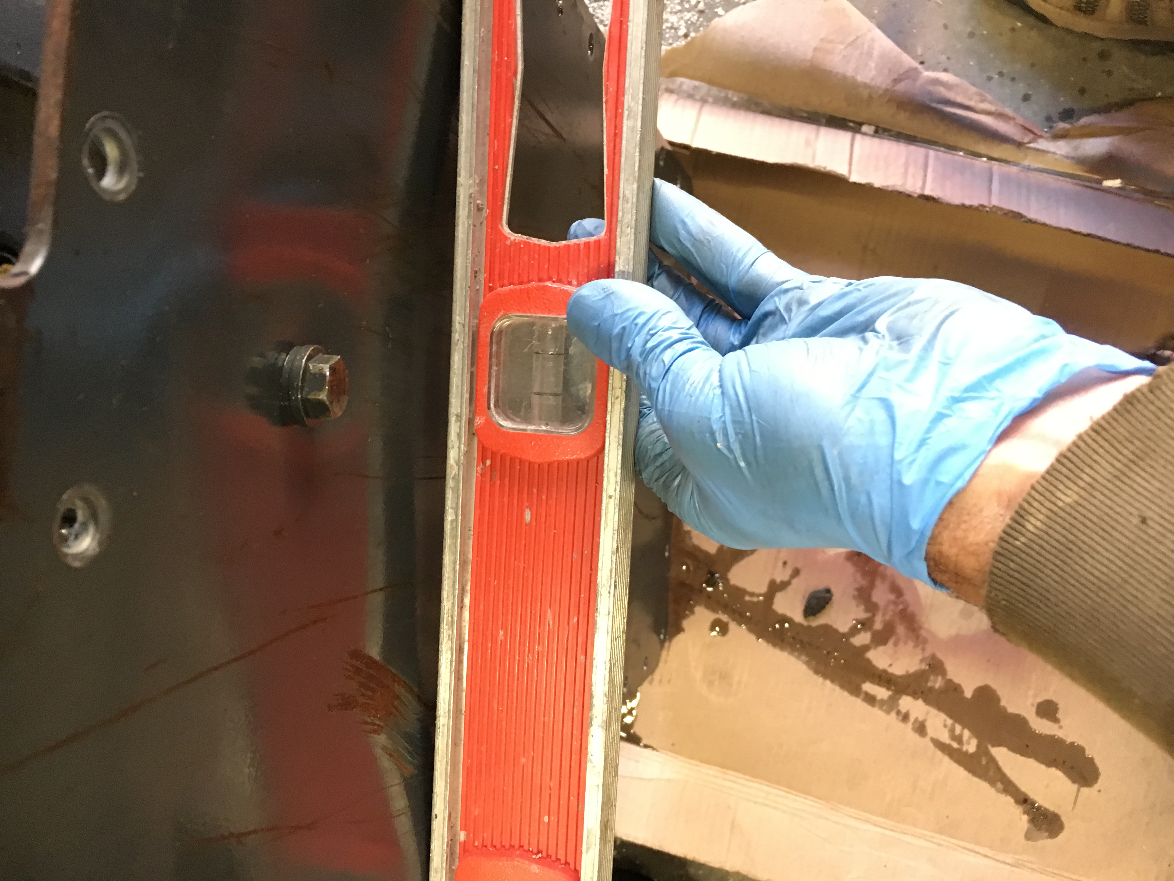

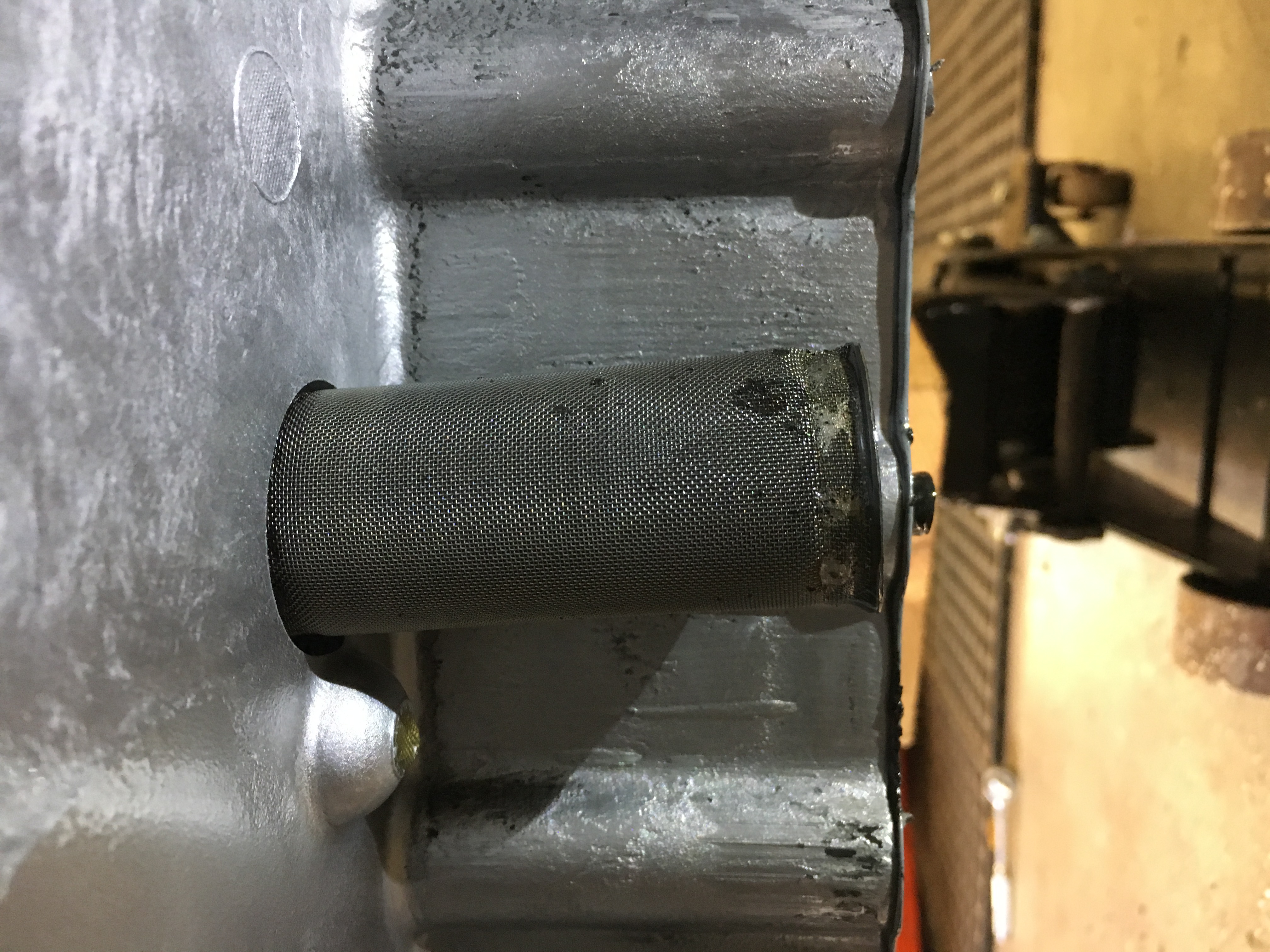

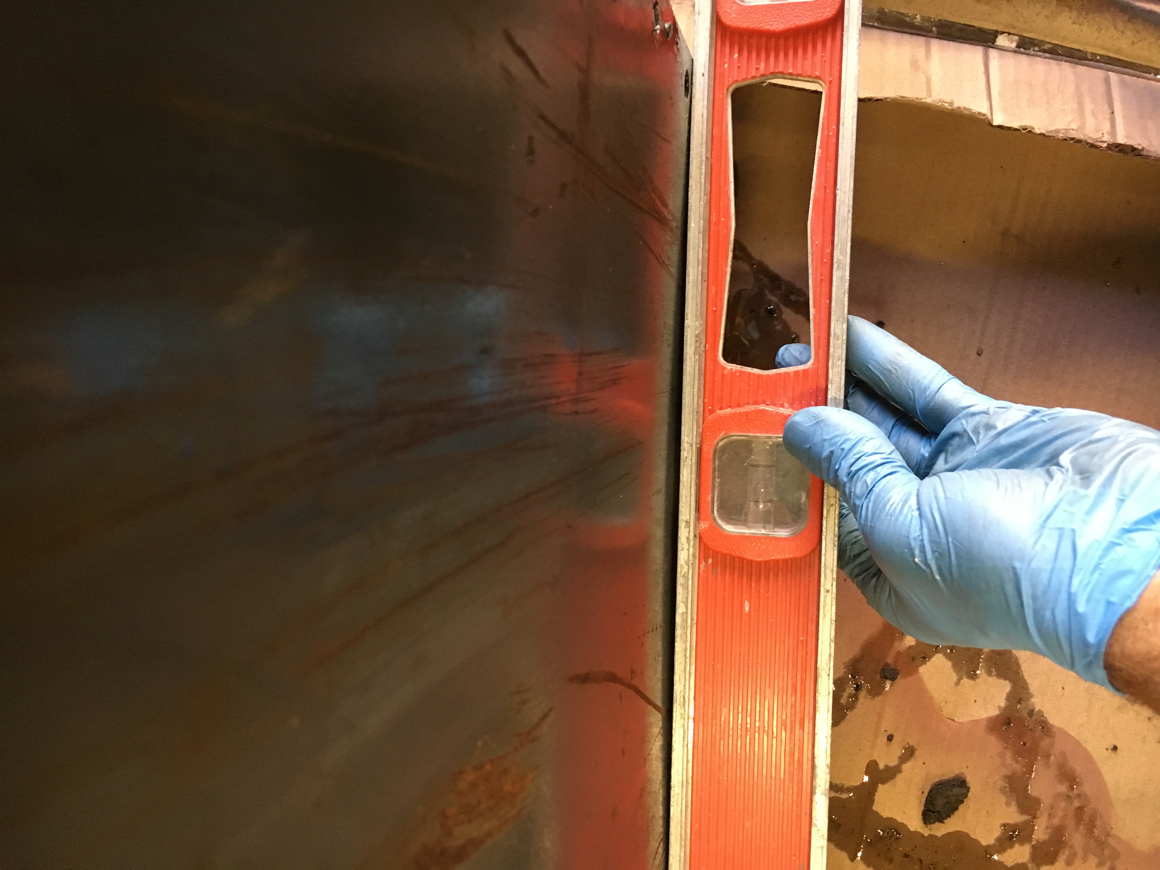

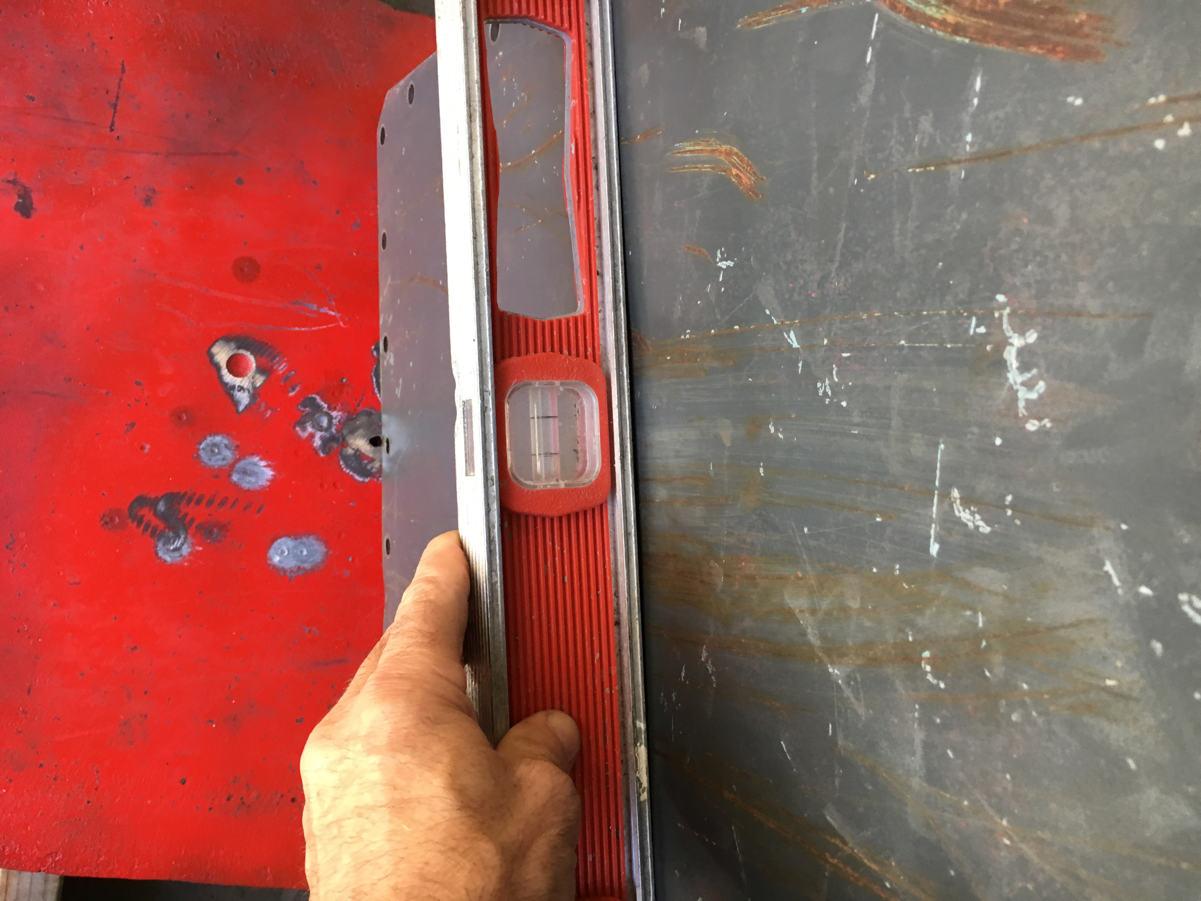

Few months back I ran over a large rock that fell out of my bucket. Turns out it bent the hydraulic oil tank bottom. So today I straightened it. It was dented in about 3/4 of an inch at its worst spot which happened to be at the drain plug. 63E6D84D-9C02-445B-B4AD-50BA88DF1833.jpeg7799EDBC-5E90-42EF-A040-AF0A7E262881.jpegDCFF93CE-D25F-4569-896D-3E8A09A9D590.jpeg39A690F5-A8E8-49B4-BE63-C1EF5FE08265.jpegEA118436-D202-4EBF-AB07-495BD8AE9CCA.jpegEC15FF35-E406-4B81-8760-576B86EC6634.jpeg
Cleaned the tank and strainer while doing so. No large pieces of any kind in the tank just a film of gray on the bottom. Nothing real bad.
