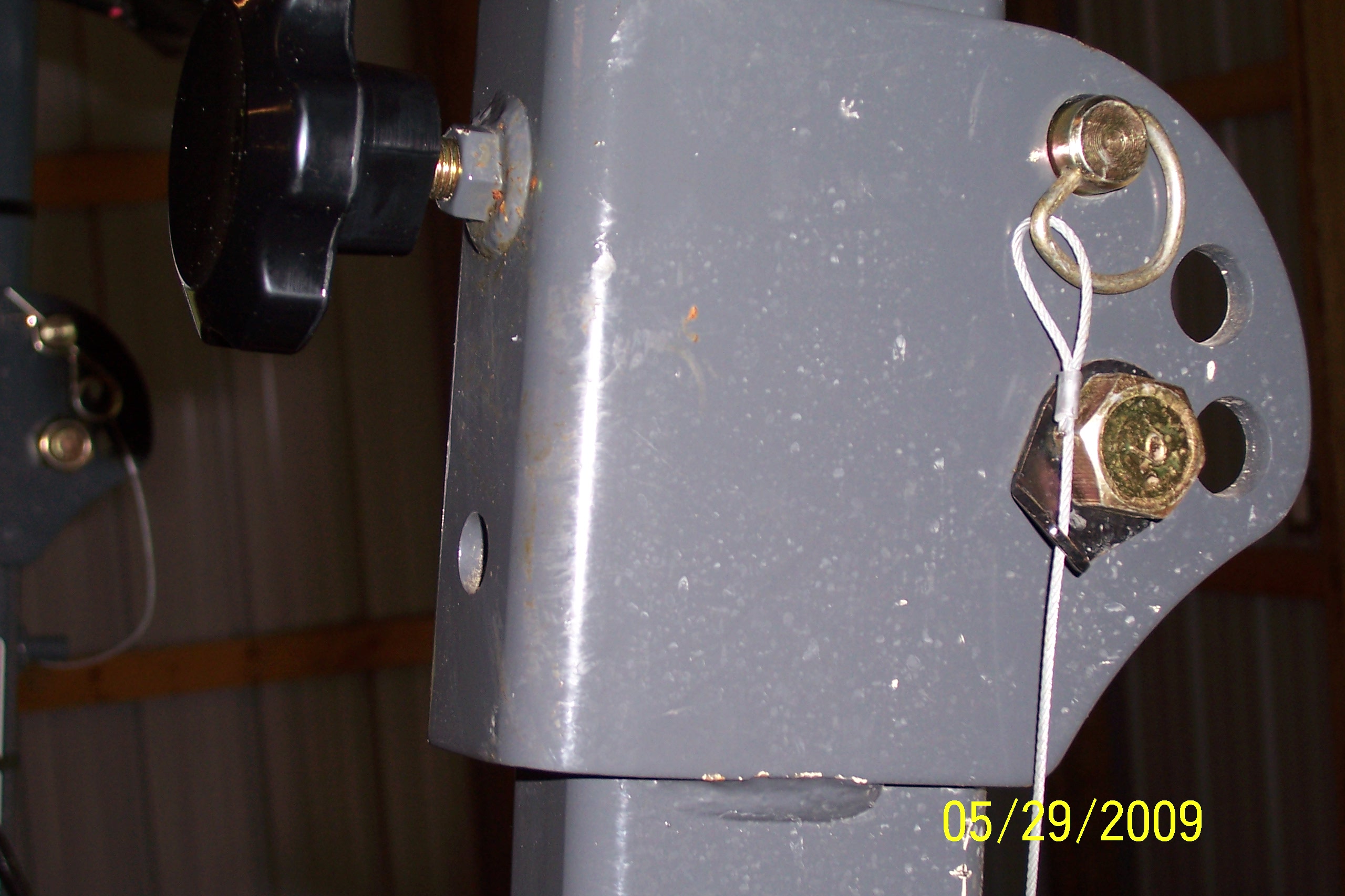

I took delivery of my B2920 the other day and am very pleased. Looked it all over yesterday for places to put extra lighting - as I couldn't see much while moving snow with the loader at night. I noticed a threaded nut welded to the rigid part of the ROPS and another hole just below. It would be a good place to mount extra lights - any idea what it's for?
   / B2320/2620/2920 owners... help ID a ROPS feature #3
Its for keeping the ROPS from rattling when its in the upright position but there are folks that have mounted lights there. You may want to check and see but I know on my 2920 it looked as if if I was to mount lights there they will be pretty much at head level and when you turn to look backwards there would be a pretty good glare. I mounted my on the top cross bar with them on the inside of the ROPS, they are high enough that they are not in my eyes when I look backwards.

For some reason they don't come with the tractor, but should. I ordered a pair to stop the ROPS from rattling.

I know this is an old thread but it is relative to the question I have. Does anyone have a part number or "official name" of the black plastic knobs that are discussed and pictured above? I recently purchased a B2320 and the ROPS rattling is ruining my seat time. I looked over the parts breakdown on the Kubota website but never figured out what these are called. Thanks for any help, Jason

http://www.tractorbynet.com/forums/kubota-owning-operating/144860-b2620-what.html#post1677254

Thank you so much Sir. Just exactly what I was looking for. Thanks again, Jason.

Just today I was thinking about that rattle and wondering what size bolt I needed to stop it. Then here comes this thread with the answer.
I love this place!
I think I'll see if McMaster Carr has any threaded knobs in metric. I like that idea better than just a bolt, easier to loosen or tighten if need be to get the pins in and out. Might be cheaper than Kubota, might not.

Late reply, but for anyone who's cheap (like me) you can just put a regular bolt M10 1.25 pitch metric thread sized and that works too.
