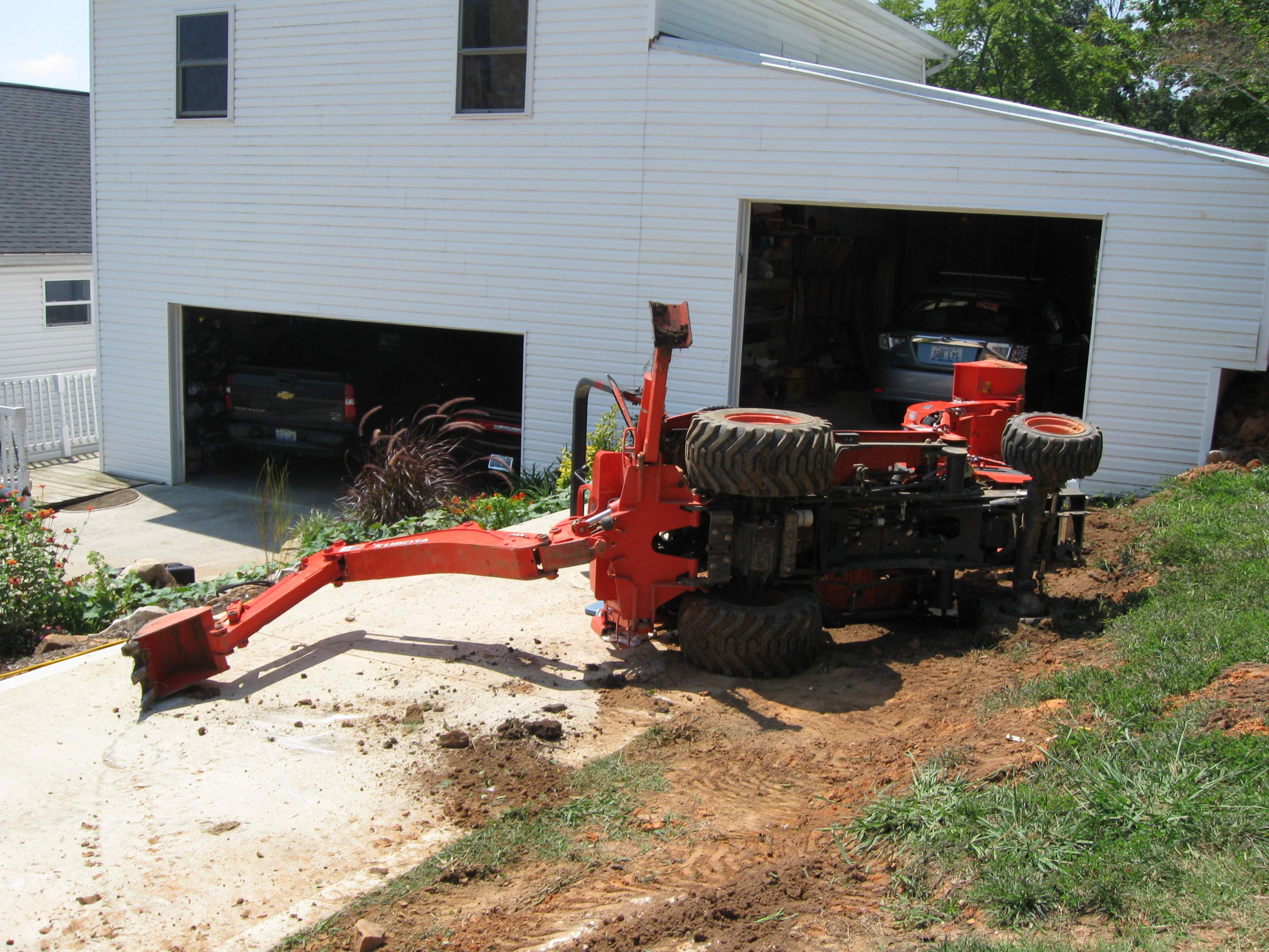

Have to get used to the ROPS idea going around low branches. I asked a delivery guy if he knows anyone flipping their tractor over, and he told me just recently a guy put his new tractor on its side. It was like a slow motion, no injuries, no damage, except a broken blinker light when they were pulling it back up.
   / B2320 Advice #24
Can happen in a heartbeat or half a heartbeat.

JOHNTHOMAS, would you share the story behind that picture? I suspect the loader was fully loaded and all the way up, as it shows.
The BH was in normal position at the time it went over. I dropped my front bucket to the ground and was getting ready to back drag with the angled front edge of the bucket to peel off the edge of the dirt cut to make it a slope and when I pushed the FEL lever down I was on my side. Done similar jobs hundreds of times but it only took once to be at that tipping point.
FEL and bucket were moved after going over, yes, very foolish. Hooked chain to side and truck was up hill and pulled it back on it's wheels and not even a scratch on the machine but still lingering fear.:shocked:
