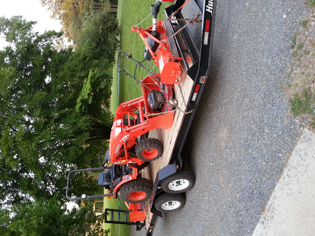

Yea I may buy used if the right deal comes along. Not a lot of 4 footers out there mostly 5. Ill keep looking... the bush hog brand seems to be the toughest. for u all that like pics here's on of a b2320 moved to its new home. The trailer is brand new but its a friends they were nice enough to let me borrow it.

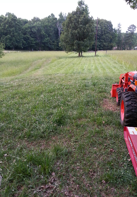

Went with a hardee brand panther 48" really is a good looking unit. More robust thant the howse. Bush hog was 1500.00 howse 740.00. Coulda maybe went a taste bigger but 60'' would been pushing it for my small tractor. It'll take me long but a little at a time and I have lights to cut at night.
