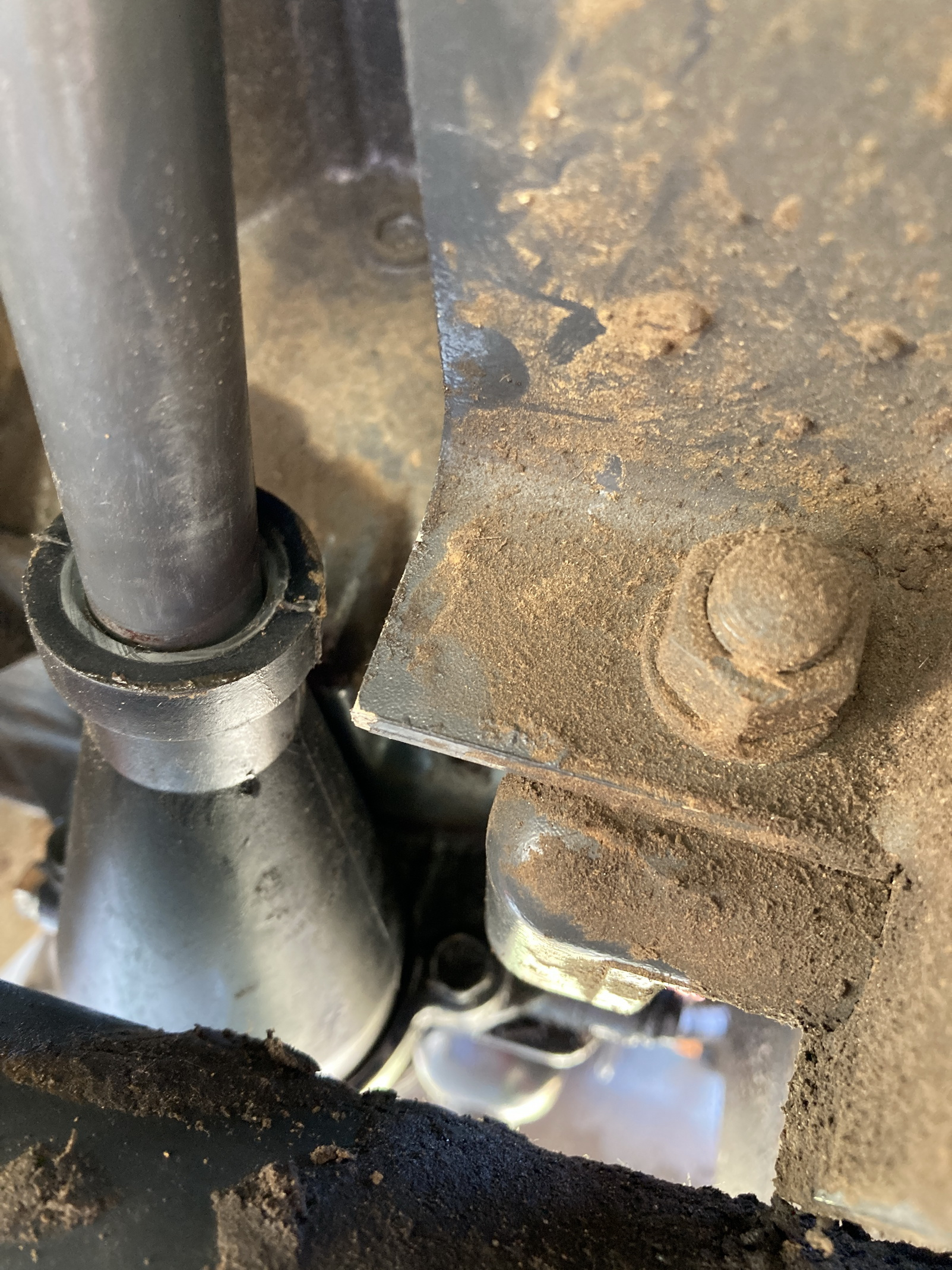

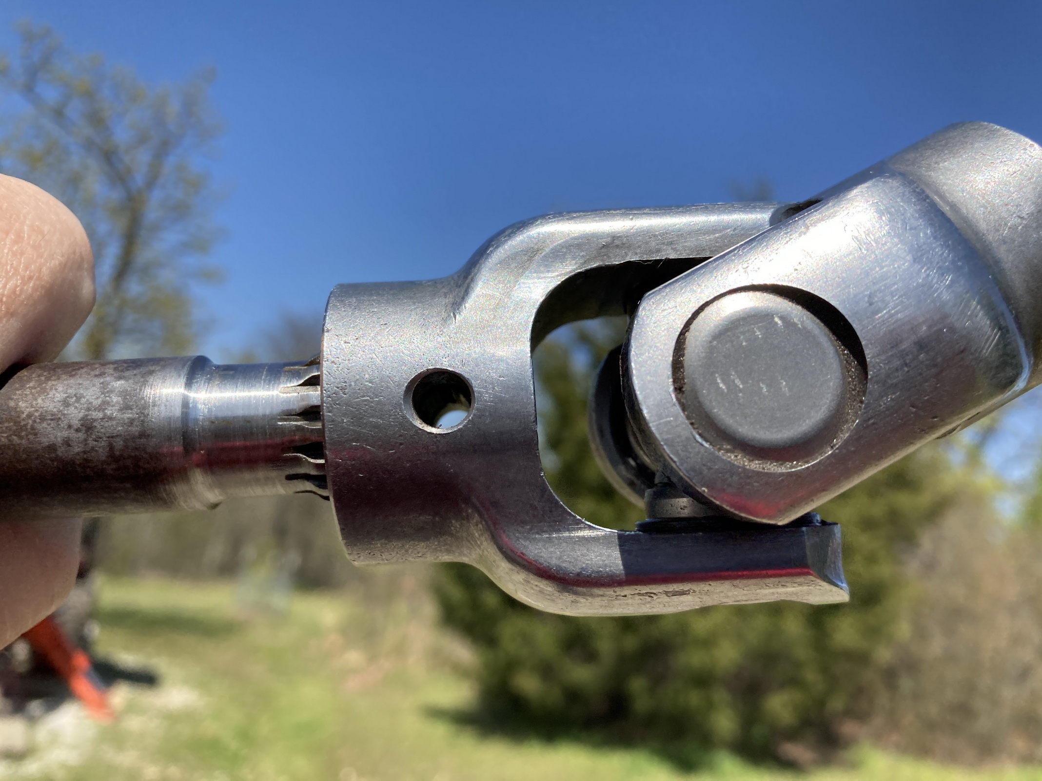

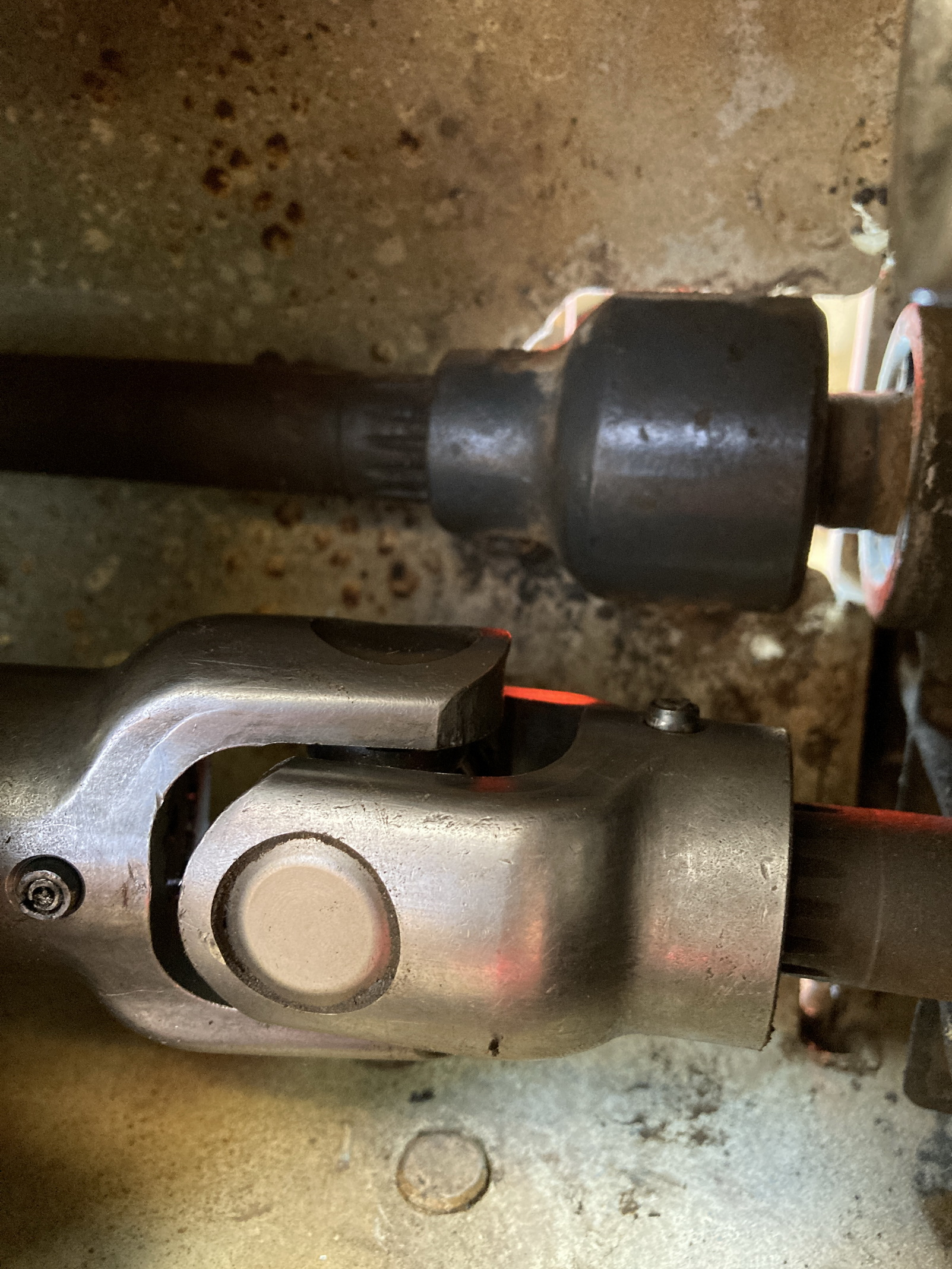

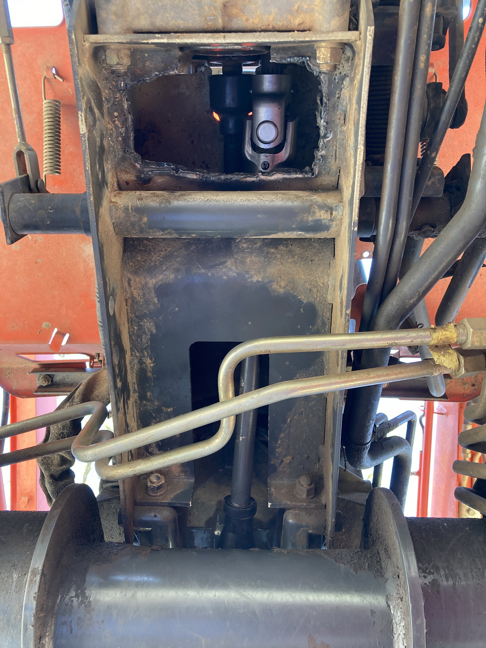

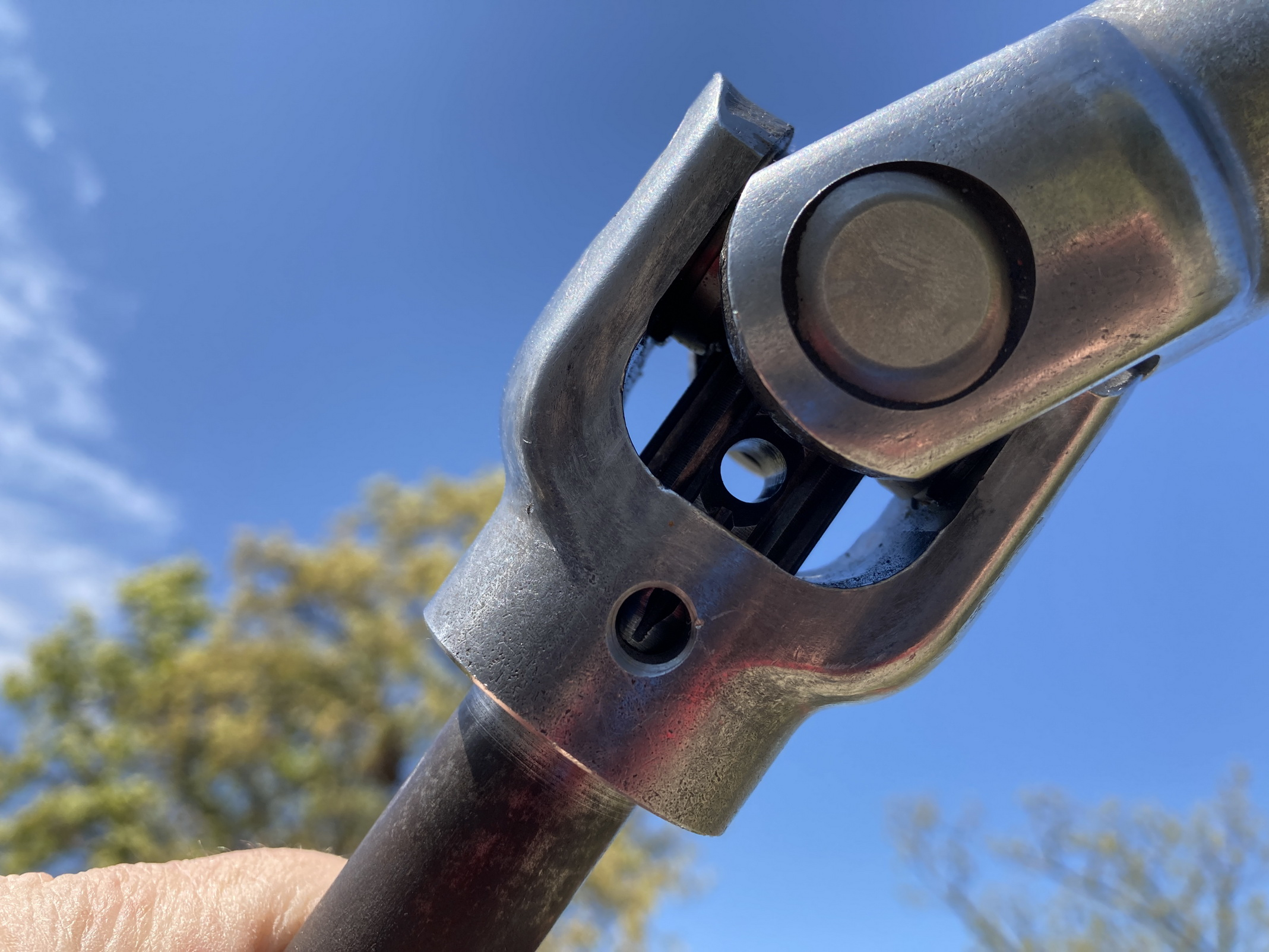

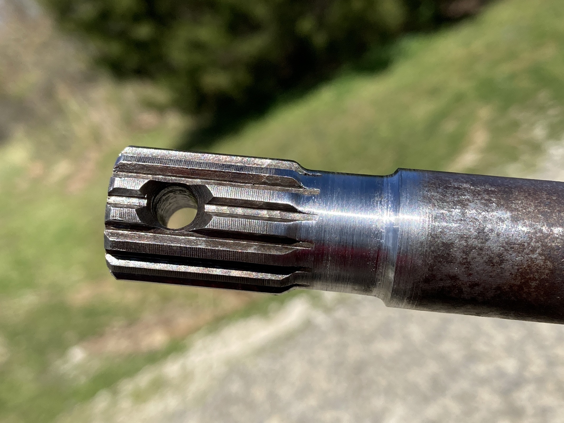

After removing a little material from the raised spline back a half inch, the new U-joint installed easily.

Well congratulations. That is a most innovative repair. I sure do like it when the repair ends up better than the original.

Very nice work there, and wouldn't it be nice if Kubota thought ahead and put a access cover in that area and did what you did to the splined shaft to allow for R&R without splitting.
What in your estimation caused the fracture to that U-Joint? Seems like that would take a lot of torque to snap something that rigid - at least you didn't have a broken shaft coming out of the case!

Thanks for your support. I hope to show how two simple mods can impower the person to find better ways of repairing our tools.

Unfortunately, money comes before honor, at least for now. I can see this all reversing right know. This U-Joint is the weakest link in the train. Which is good engineering practice, that is to sacrifice one so that the rest will go on. This U-Joint for the four wheel drive has always been engaged for the 799 hours it has been of service. The failure was due to high stress and loss of lubrication. The U-Joint had failed sometime ago and was making some not so nice sounds. I am also very thankful it was such a simple repair. When you walk away from the FEAR, False Evidence Appearing Real, you cam open yourself up to the infinite possibilities. Which in my belief is to connect with the divine.

Sam, if you wind up splicing the shaft, be sure to keep the u-joints in phase when welding back together.
EDIT: I see that you got it fixed. Very inovative job. Now to grind the plasma cut smooth and fab a 3/16" cover plate, drill and tap the original, and bolt on.
