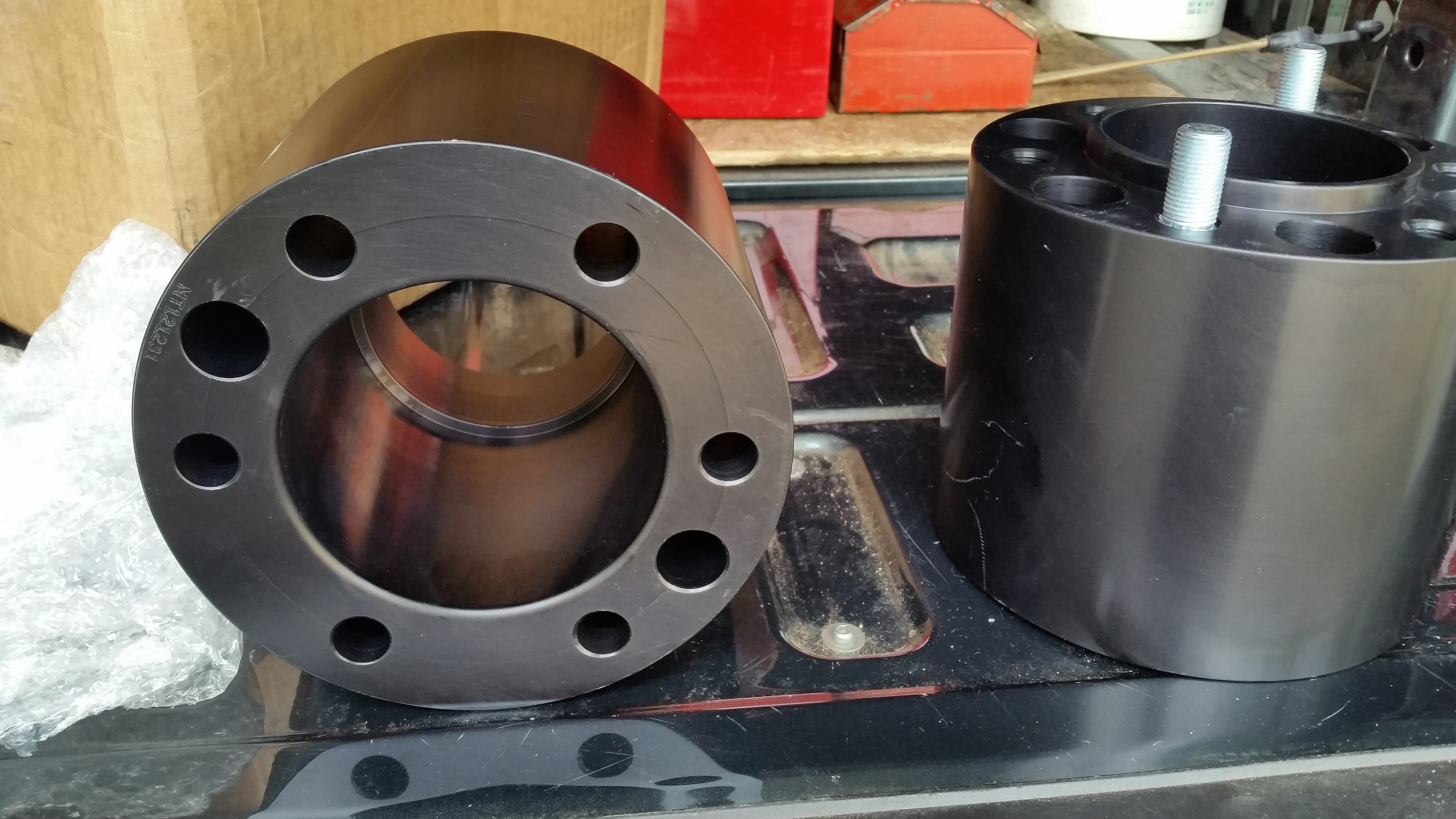

I bought Kubota spacers from the dealer--added 1.5" to each side. I needed the space to allow for tire chains.

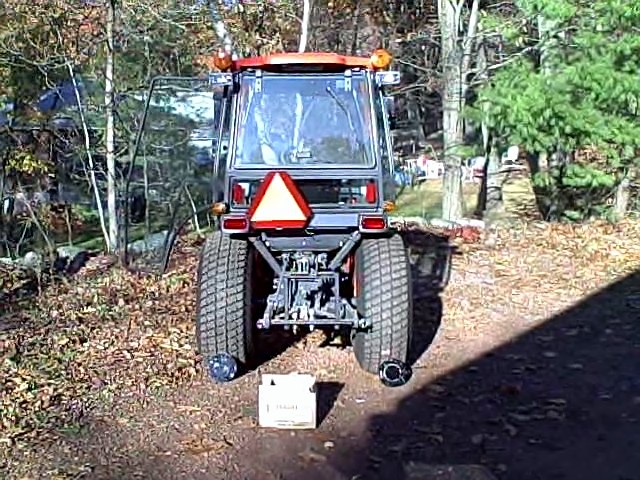

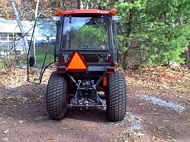

I have a bit different perspective: 1) I have no idea why you would not use both wheel spacers and filled rear tires. Whatever that is needs explanation to be credible. 2) Kubota has never recognized the portion of their user base that sometimes needs to operate on steep ground. Therefore they have never made their tractors with enough available rear wheel spacing. Just look at Deere, New Holland and Massey for contrasts. 3) I use Bora brand spacers, 6" each side, on my B2150. They are very well made, exact fit. The co. is very knowledgeable fo the idiosyncrasies of Kubota. They made the difference between a machine being skitish to unusable on a 40% slope to one that is very comfortable and safe doing so. They cost me $520 for the set of 2 spacers & I have never regretted the investment. 4) In shopping for the Bora spacers I also looked at Bro-Tek and Hansen. I think all of them are good. Some design use welded steel, amounting to 2 round plates with tubes in between. Others including my Boras are solid aluminum billets that are machined to fit the task.
Mine are 6" per side which is about as much as you can get. They are NOT compatible with the mid-mount mower by the way !
Here is a set of steel ones on an L3400.
These are my Bora's on the B2150.
