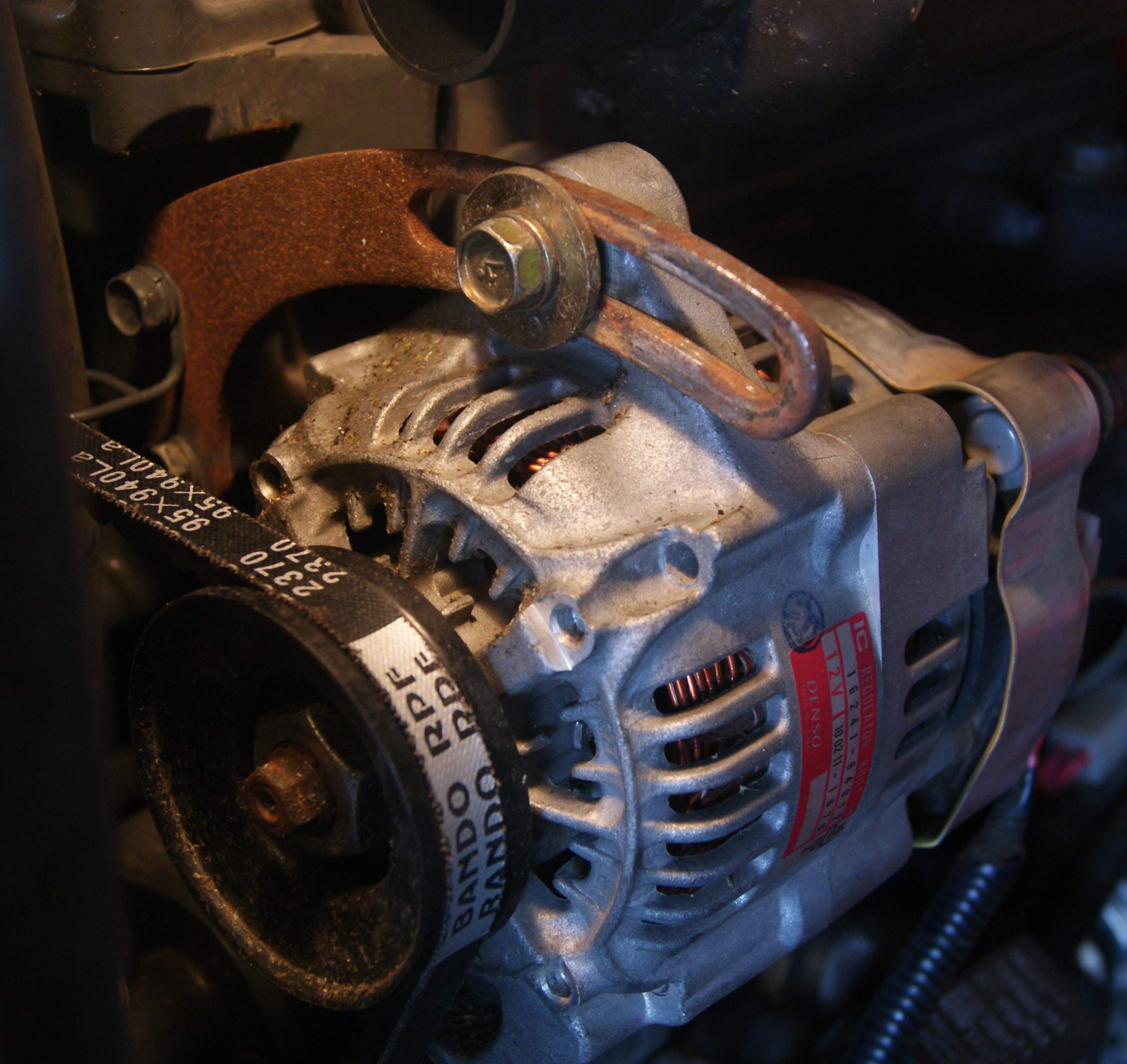

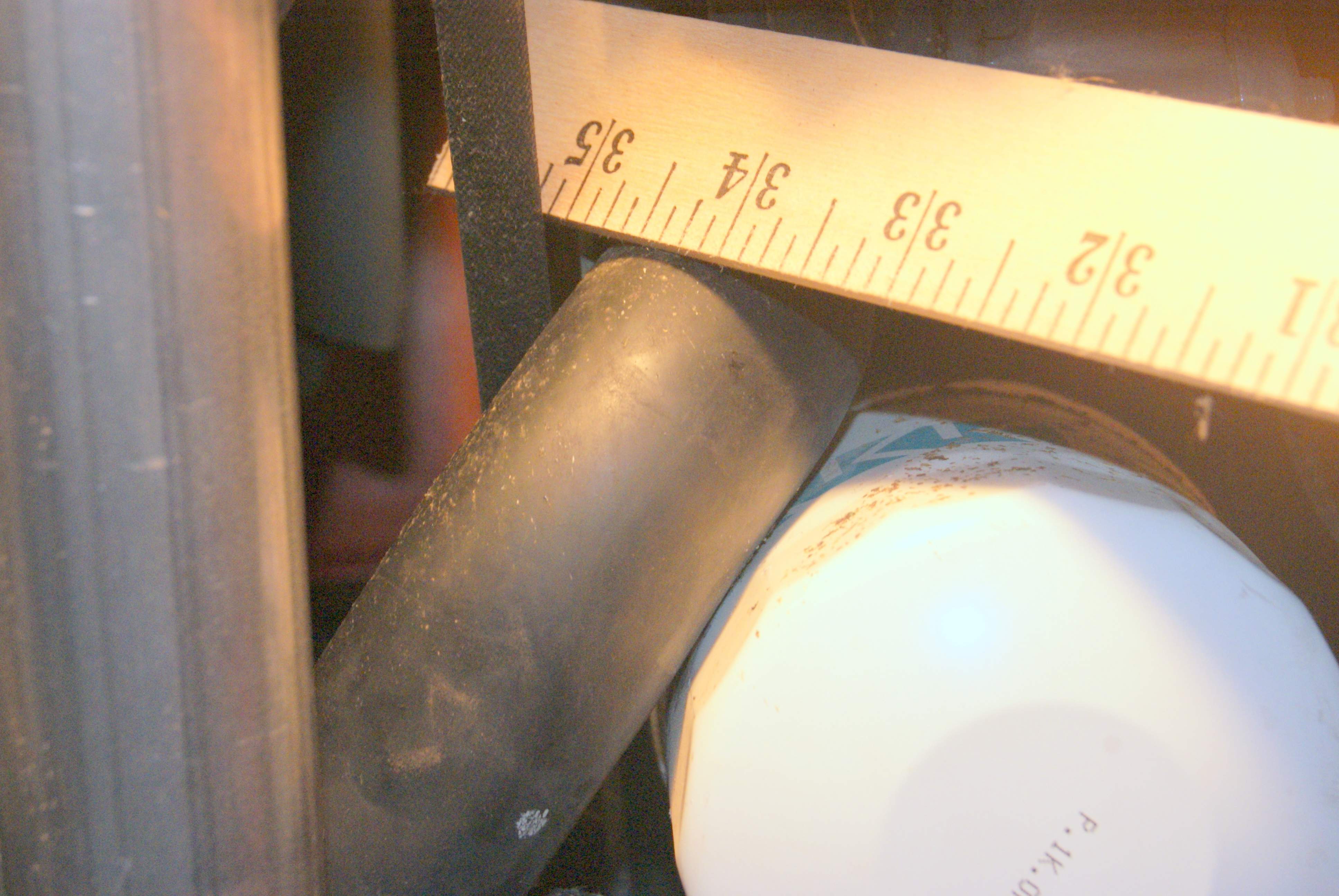

I called my dealer today and spoke with the parts department and service department. They both claim to know of no problems with the 40 amp alternators on the B2X20 series of tractors. My machine went out of warranty in October, so no help there. As best I can figure, the belt may have been put on a tad too loose and allowed the belt to "slap" and rub on the radiator hose. I tightened the belt today and placed tape over the rubbed spot and ran the tractor several hours, and I see no new rub spots, but it is awful close. The next problem is that the alternator has no more adjustment to tension the belt, dealer say belt stretched, get a new one. OK, but in 120 hours? Am I really going to have to swap belts that often?
After examining closely, I have the following conclusions;
1. The belt probably was too big to begin with, I ordered the right belt to see, but I am thinking I need to go a bit smaller in order to have the alternator tensioner near the center of adjustment.
2. If the belt was smaller and the adjustment was more towards center, the angle of the belt would be such as to allow more clearance on the radiator hose.
3. The 40 amp alternator kit was probably poorly engineered and the belt supplied should be a hair shorter for use on the B2X20 series tractors.
I plan to follow up and with Kubota USA and see if they even care, but I would love hearing from everyone else to know if their machine is wrong or right. I have attached a couple of photos showing the clearance as best as I can, it is a tight fit.

I am just running the original alternator, not a 40 Amp. I'll have to see if I can remember to take a picture tomorrow. Mine looks nothing like the picture with the oil filter in it. I don't even see the metal plate that keeps the hose out of the belt in that picture. The clearances are close in there. When it is done right there is only about 3/4" of clearance. After getting this fixed, I doubt it is a common problem. Looks like they had a new guy or the guy had a bit too much sake the night before and didn't tighten down the hose shield properly.

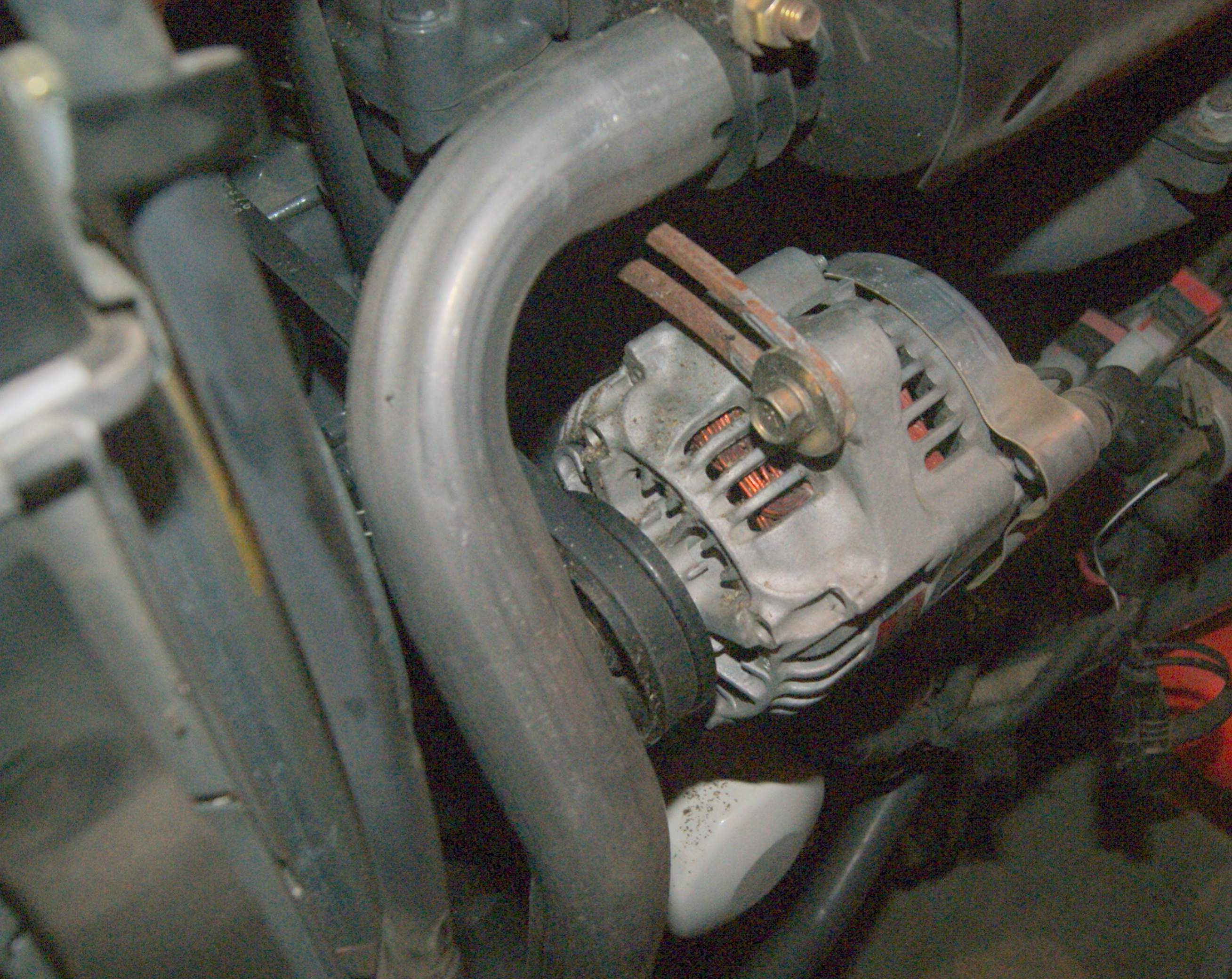

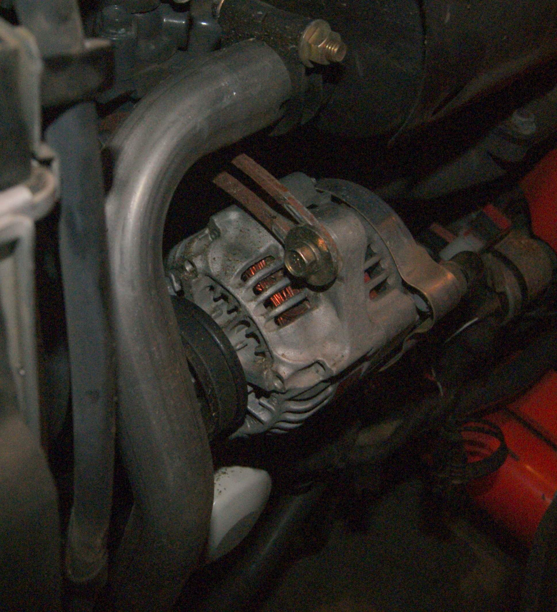

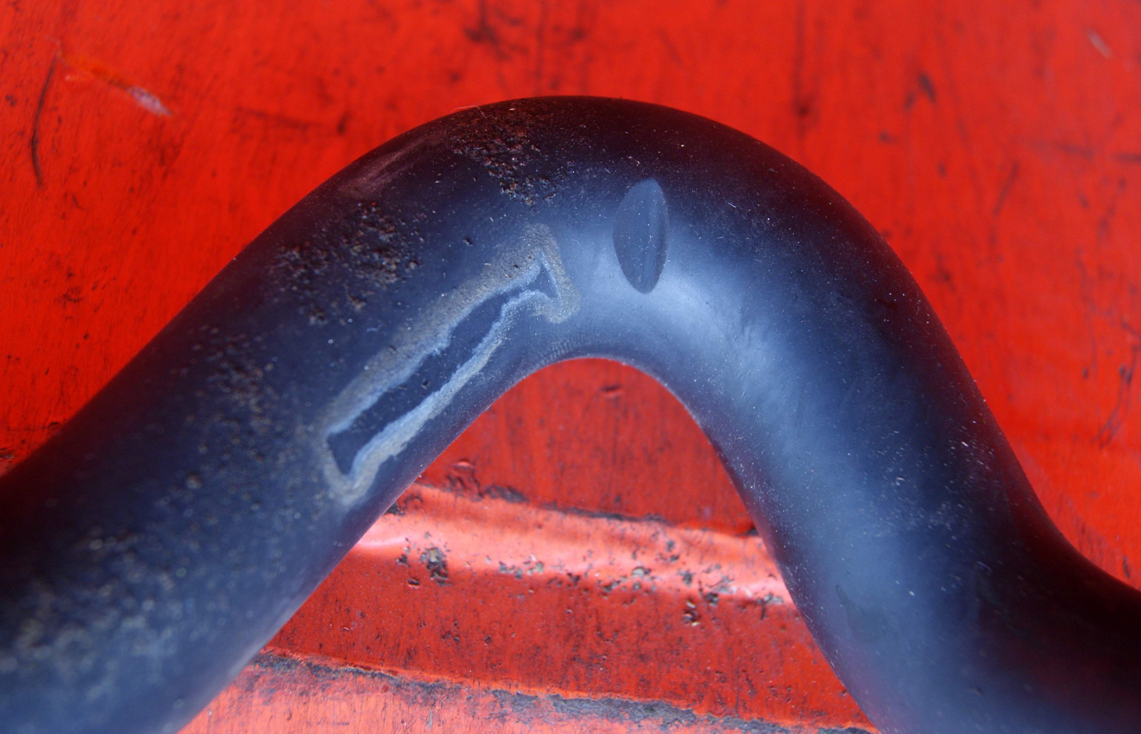

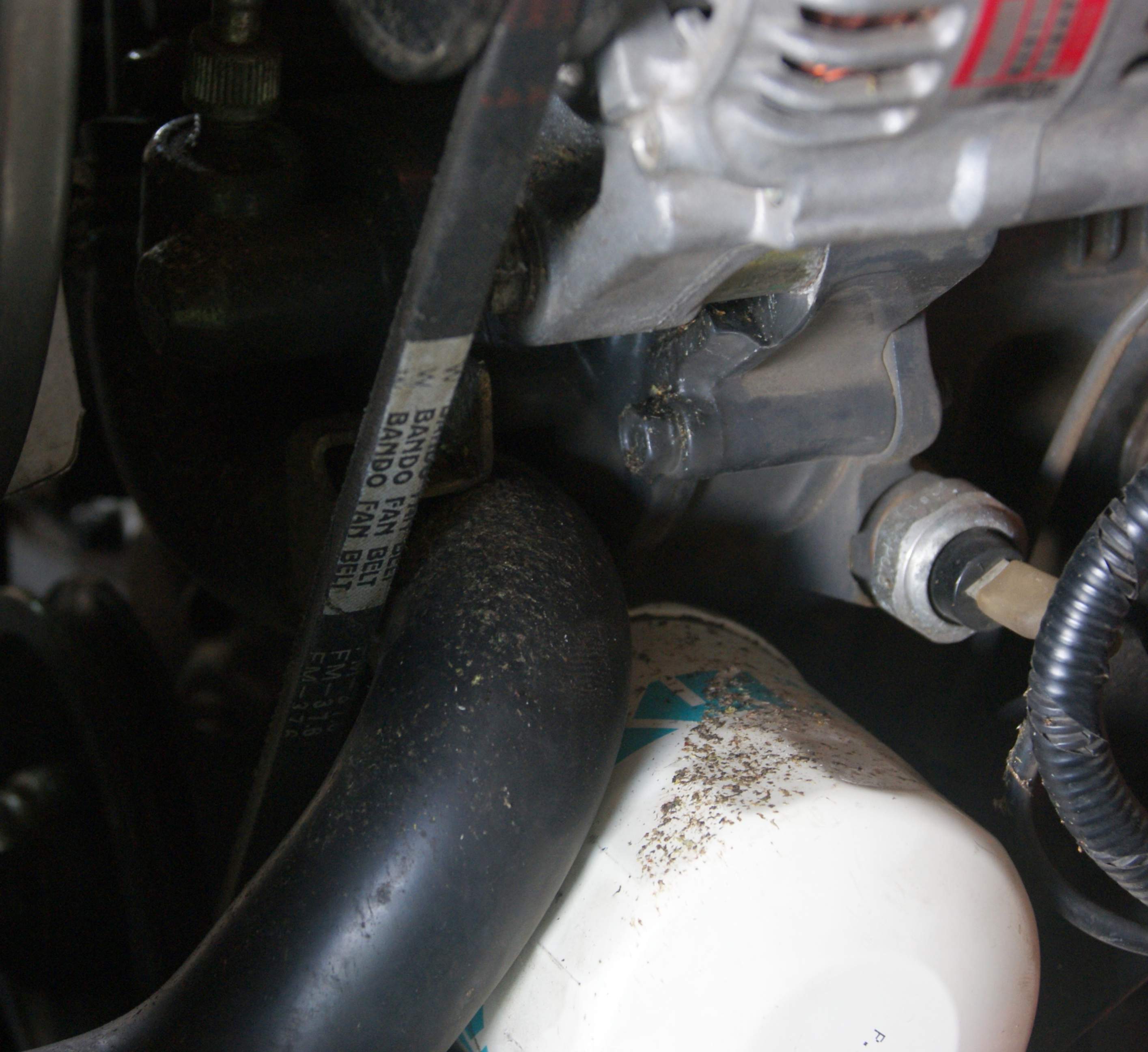

Here are some more pictures of the before and after of my B2320. I ended up putting a 37.0 belt on instead of a 37.6. The .6 made a huge differance in how is fit. My dealer is not being very helpful in this matter, but I did send them detailed pictures and am waiting to see what they and the Kubota rep. have to say. I don't think that it is acceptable for a machine with 150 hours to have a belt that is at the at the maximum adjustement point and rubbing on the radiator hose. I did try a new belt at the dealer's recomendation, figuring the old one streched? hmmm it was at the max. adjustment when delivered to me, but the new belt was the same thing. Kubota speced too long a belt I am thinking. I will keep people posted as to an outcome. I would like to hear from anyone who is or is not having problems with this and dealers who might be on here as to problems you have seen and how you would handle this for a customer who has a tractor with 150 hours and three years old.
