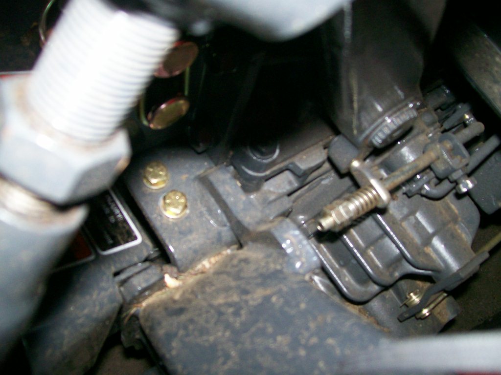

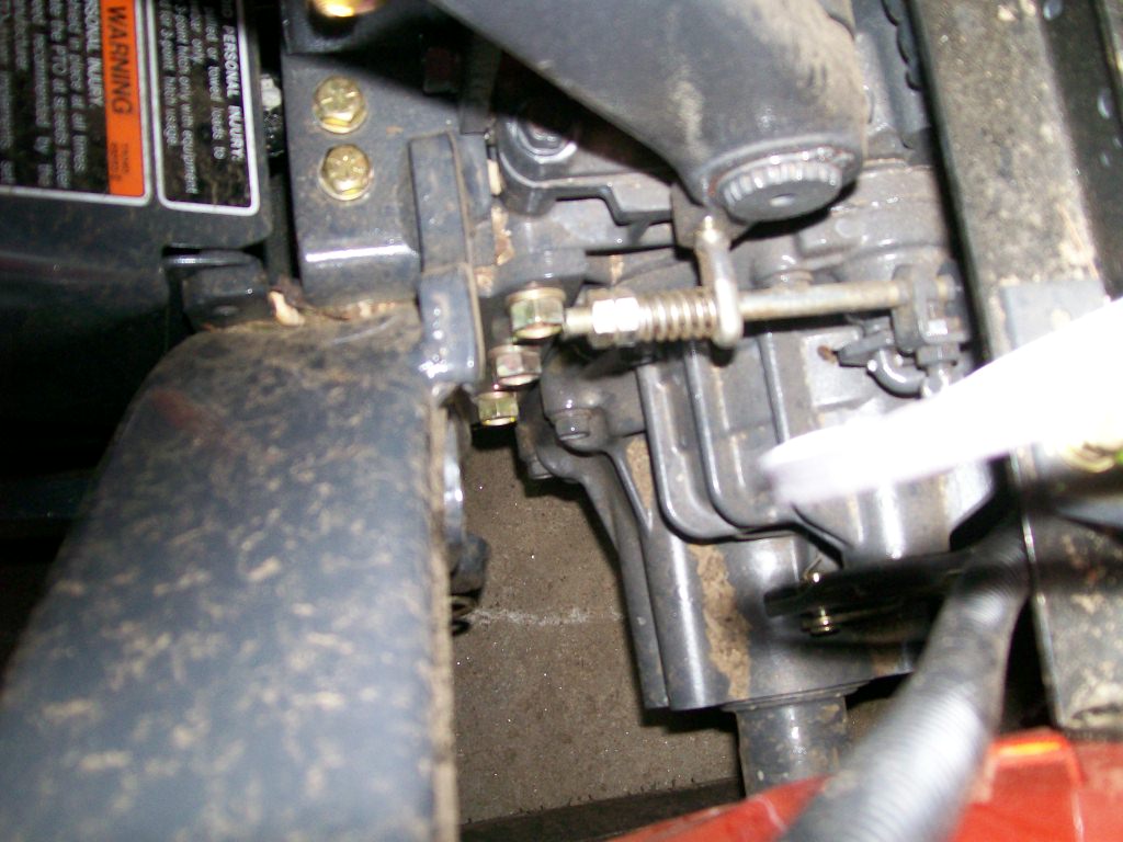

There is a mechanical stop on the 3pt hitch control rod that can be set to limit how far the hitch will drop, and I find that worth setting if I'm going to be doing a bunch of brush / rough cutting. It is a sliding stop on the operating rod.
Thanks for the info, I will have to try that.
