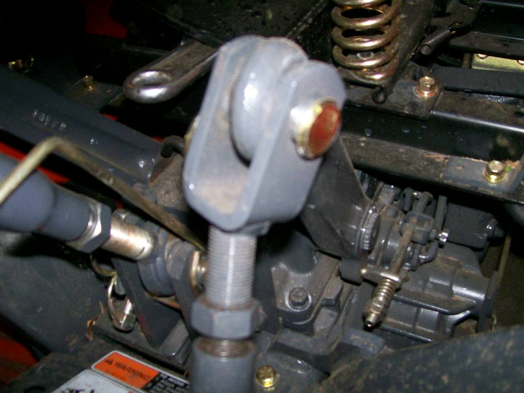

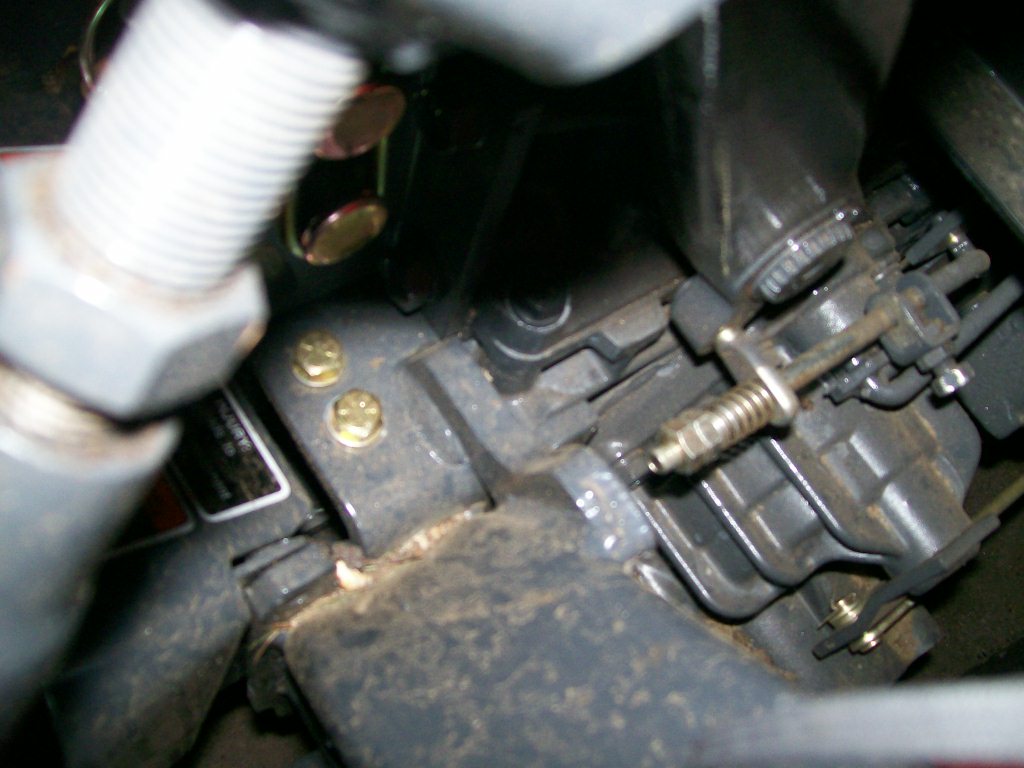

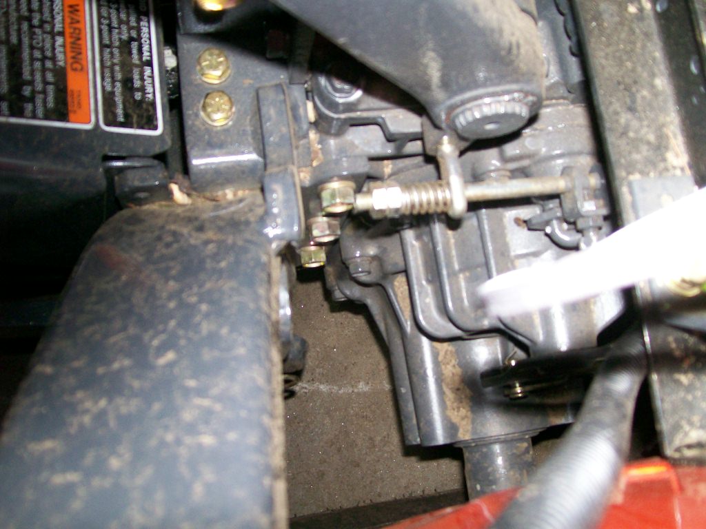

There is a mechanical stop on the 3pt hitch control rod that can be set to limit how far the hitch will drop, and I find that worth setting if I'm going to be doing a bunch of brush / rough cutting. It is a sliding stop on the operating rod.

Thanks for the info, I will have to try that.

Yes, thanks Chuck for posting that again. You sent it to me last October and for some reason I could not seem to find it in my computer. Will probably be mowing this weekend if we don't get too much more rain today.
