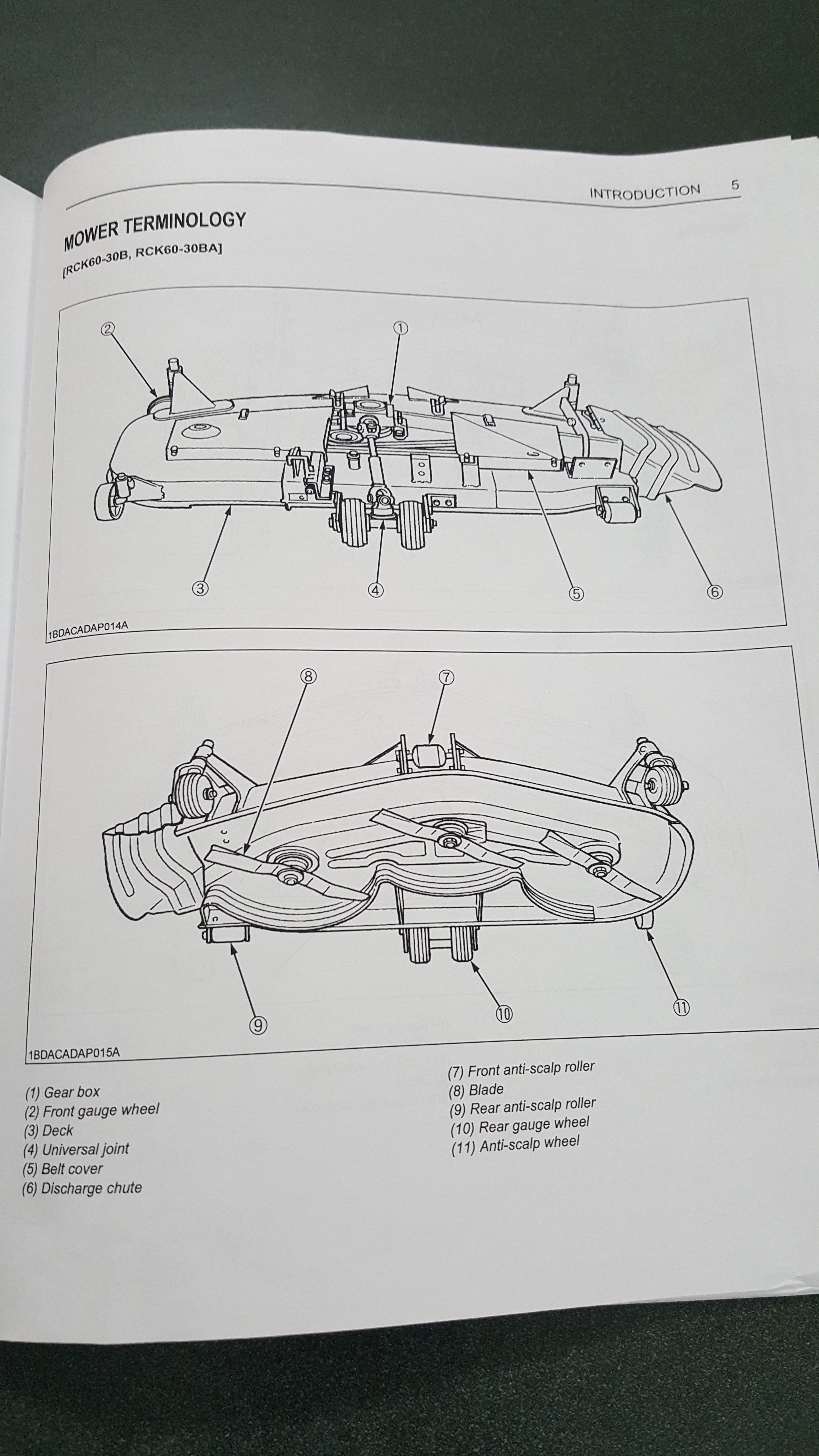

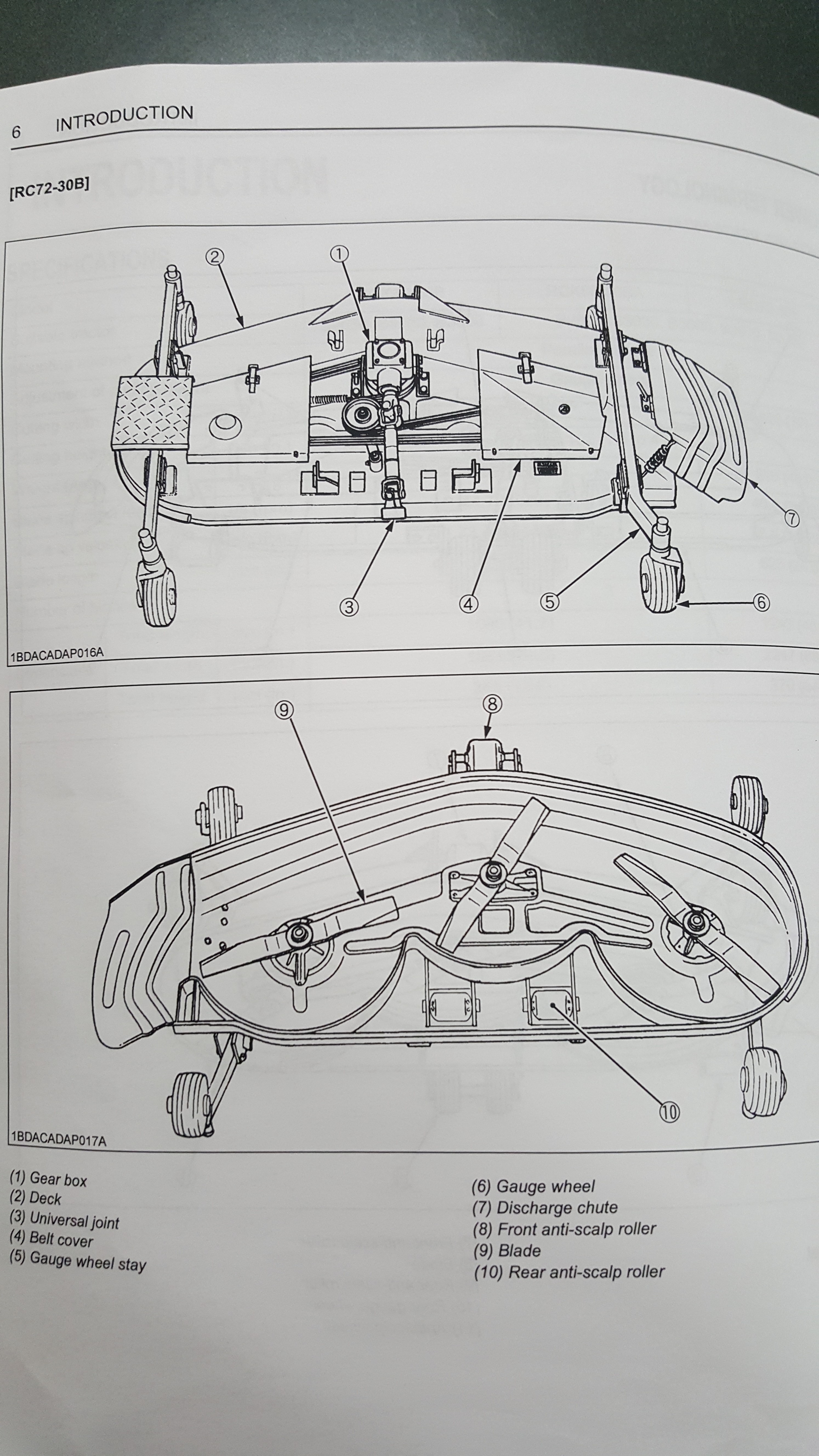

Rkidd - I was looking at your pics over on the "No more MMM back pain" thread. Just so I have it straight, the 60" deck has castering wheels at the front corners, non-castering wheels at the back corners (that you can turn 90 degrees for removal), and the center gauge wheels on the back, correct? Does your friends 72" deck have just the four castering wheels on the corners? Sure wish there was more info on these things on-line.
   / B2650 MMM install? #24

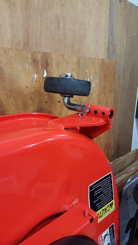

Scott F. Thats pretty close. The 60" deck when mowing rides on the 2 front castering wheels in the front and the gauge wheels on the rear. The right rear has an anti scalp roller and the left rear has the anti scalp wheel that are about 1/2" off of the ground when mowing. To remove or install deck you drop and turn the left rear anti scalp wheel 90 degrees which there is a hole in its shaft for. The right rear roller stays as is. Lift the rear gauge wheels all the way up so they dont touch. The unit then balances and rolls out on the 3 wheels. The 72" does just ride on 4 castering wheels. One in each corner. I will try to get some pics out of the manual tomorrow and post.
   / B2650 MMM install? #25
Scott F. Here are the pics of the two decks out of the manual. Any other questions let me know. 20160407_004818.jpg20160407_005036.jpg
