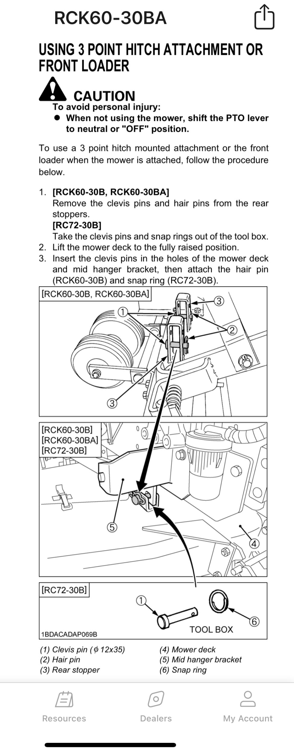

I have to raise the 3pt almost all the way up and then slowly lower it down about an inch - this gets the bracket holes close to lining up, at the same time i use a floor jack to raise the edge of the deck a little bit until one side goes in. Then off to the other side.
   / B2650 MMM Pin Up #12
I have seen somewhere, someone had an extension added so their pinning holes were much lower. Do you have those? With mine, the back of the mower hits the stoppers but the front isn’t up enough to line up the holes. That’s why I need to manually lift it to make the holes line up.

Pin up should be seamless and doable in seconds.
Confused here. Are you attempting to pin up the MMM or the lifting mechanism once the MMM has been removed. Two entirely different procedures but both are discussed in the mower owners manual.
You may not be able to pin up either if the mower was not properly installed and adjusted. Again procedures are in the manual.
SDT
Do you have the pin-up instructions!?!!?!#$^%!@#$ - I've having a heck of a time finding it online! Seems like it would be simple.....seems... TIA!
   / B2650 MMM Pin Up #19
As previously mentioned, you need the Mower Operator's Manual and, maybe, the Mower Installation Manual.
Doubt that you will find either online but your dealer can get such for you if he is willing to be bothered.
   / B2650 MMM Pin Up #20
I have the B2650 operators manual, the work shop manual and the MMM 60" manual + parts list.... I'm not finding anything about "pinning up" the lift arms as of yet.... :/ just happed across it in a couple forums where people talk about it with no documentation....
