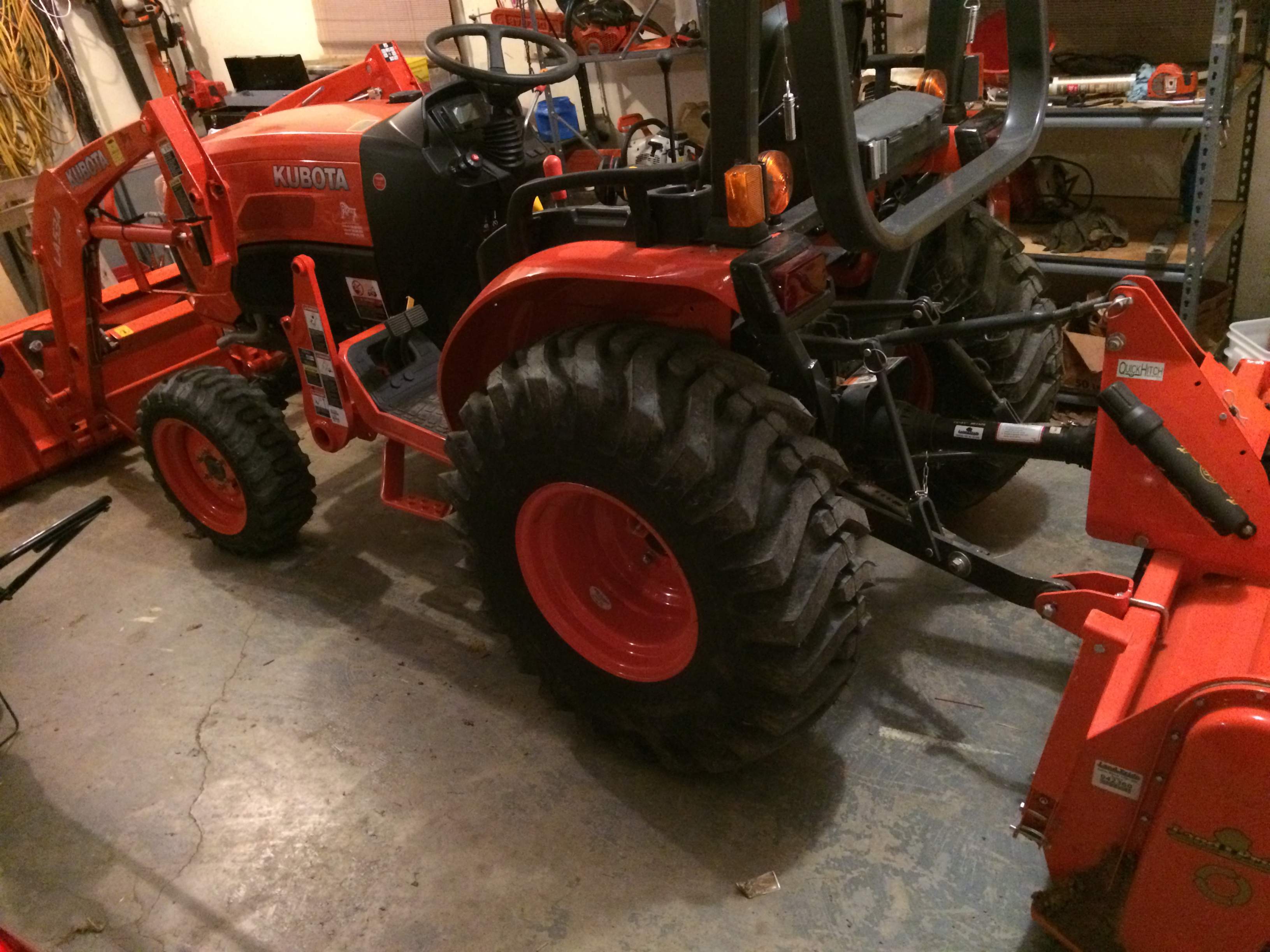

LA534: Very smooth response. Far better than the B3200 that I had. :thumbsup:
Fuel consumption: With 10 hours on the tractor since new 05/15/15 it has used less than 5 gallons of fuel. About 4.5 gallons. About 7 hours cutting brush and heavy weeds with a Woods BB48. About 2 hours tilling the "garden" with a LandPride RTR1258.
Position Control: A huge improvement over the 1/4 inching valve on the B3200. Pick the number on the control, put the little knob at that setting, and your can raise the 3pt hitch and then lower it, and it goes back to the same level. No looking over your shoulder to see if the implement is too high or too low. Set it and forget it.
3 Point Hitch: I am so use to the turnbuckle style lower links, that the lower links with the pins are somewhat of a pain.
Positioning the tractor to the implement is easier, due to the stabilizers not moving. But trying to get
the holes to line up on the lower links is not as easy as just turning the turnbuckles. I am just not used
to them yet.
Electronic dash: No gauges. Little bars to look at and try to figure out how much fuel you have, or how warm or cold
the engine is. :confused2: And they are hard to see in the bright sun. Gauges, like on the B2301/06 are far easier to see.
My neighbor remarked on how quiet the B2650 is.
I really don't care for the treadle set up on the hst. I am use to the
set up on the B3200, with the peddles close to the platform, and more room for your shoes.
This tractor starts a lot easier, and I don't get the choking exhaust fumes like on the 3200.:thumbsup:

I had the 48" from the B3200. In 15" grass the 2650 handled it with no problem. The blades on the bushhog are not real sharp, so I took it easy to get a halfway decent cut. It still looks like a hay field, but that is the mowers fault not the Kubota's. I believe it would handle a larger mower with no problem. I was only running at about 2100 rpms.
The dpf and price of the 3350 kept me from being interested in it. I was actually looking for a somewhat smaller tractor, compared to the B3200. But the 2650 is the same size or a shade bigger than the 3200.:confused3:
HJT
The RTR1258 is a good match for the 2650. I had originally made a deal on a 1250 that was supposed to have been a demo. It was pretty well beat up, so I opted for the new 58" tiller. It more than covers the tracks of the 2650. I had the skids set low. The tractor was in mid range, and it ran the tiller with no problem. With the tiller lifted, the front end is light.
Split brakes came in handy:laughing:.
I was somewhat skeptical of the pto clutch. On the BX25 when I engaged the pto, it was a sudden start up and a shock to the tractor. The 3200 had a clutch, that you could ease the pto into operation. But, with the 2650 clutch lever, you can ease the pto into gear at idle with no shock to the tractor.:thumbsup:
