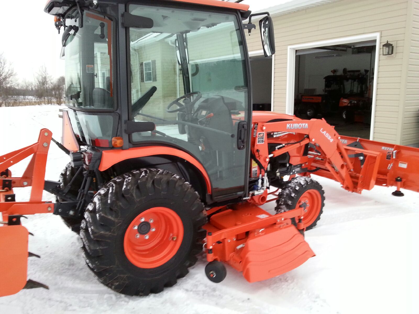

Newtattoobob
Can or would you post some photos of your qa blade. Is it spring loaded?
   / B2650 snow removal options #28
Yes its spring loaded, its the kubota one. I'm not sure of the model but I will find out and post some pics.
   / B2650 snow removal options #30
Here is a couple pics of the plow when I first got it.
