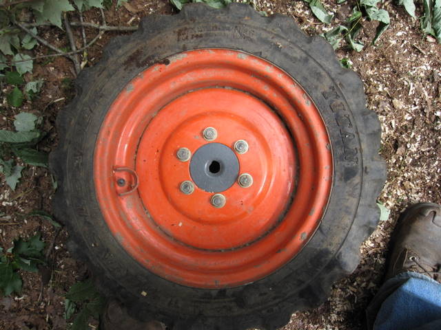

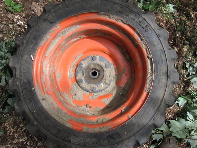

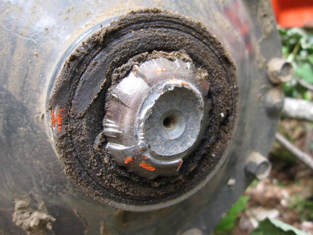

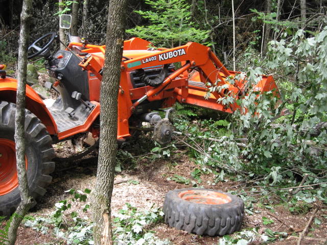

Well my first words weren't Merry Christmas! I was pulling out a tree and had my wheel cocked to the right and ...thunk... it snapped right off at the bearing.
The tractor is quite a ways down in the woods and I am going to have to fix it myself. Can anyone give me some advice on what I will need and how to go about repairing it?

That's some bad luck, sorry that happened to you! Maybe you could get back to the house by lowering the bucket to help support the front end. Then slowly travel in reverse using the loader as a crutch. Might work and might not, but if it does then you are closer to your tools to repair it or load it up for a trip to the dealer.
A shop manual and parts book will help you out a lot and are not terribly expensive. Good luck!

Thanks, that's a good idea but it's pretty far down in the woods. I'll be fixing it there when I find out what I have to do.

Should be able to take out the ring of bolts and then take the hub and broken shaft to a work bench. Should only be one snap ring holding things together. You might need a puller for bearings but not sure.

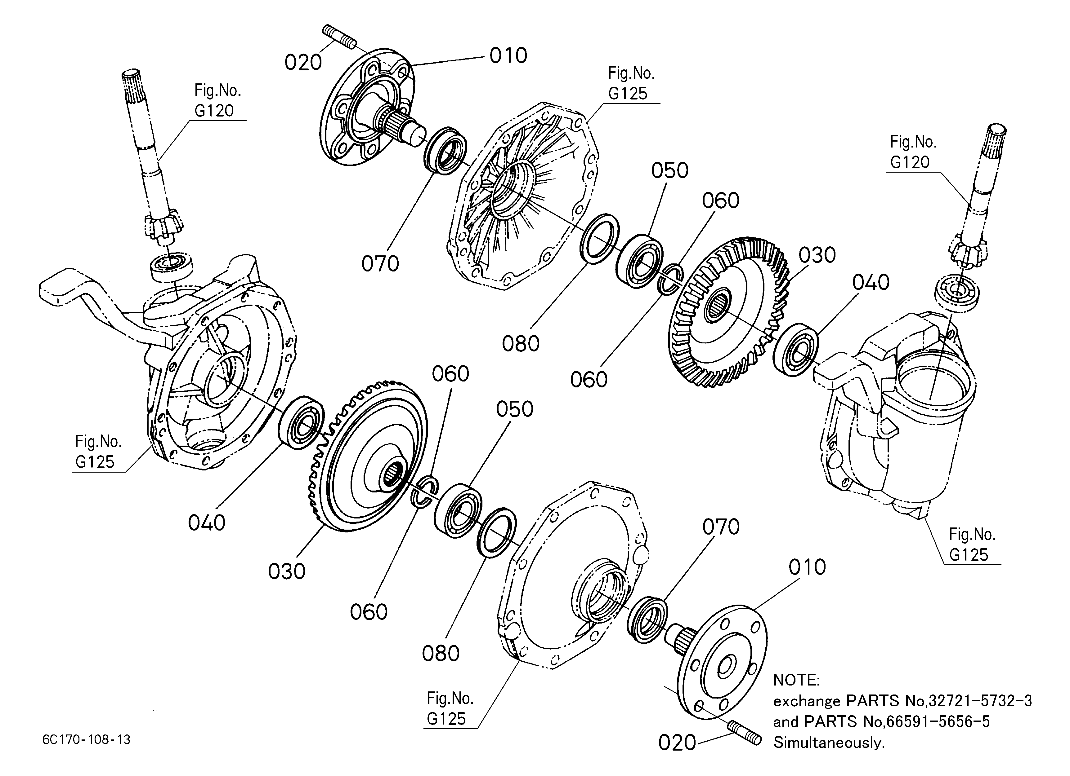

Here is a view of the axle components.

I would fix it on site. Bring a pan to catch the oil and replacement axle oil. Looks like part #60 holds the stub shaft in place. Bring along a can of penetrating oil for the housing bolts and take your time. Stripping a bolt or twisting a bolt head makes for a long day. :laughing:
Dlabrie ... The pic is most helpful... is there a gasket to seal the housing or is RTV used?
/ B2910 front wheel snapped off!
#13
That is what I though I'd do.
I have no idea! What's RTV? I have never done anything like this and was hoping some one could tell me what to expect, if I need any special tools and how to go about it.

Looks like the axle and the hub are hollow at the location of the break. AND, that access to the hollowed area can be made from outside the wheel. I'd try to put the wheel and hub in position and drive a bolt or tapered pin in it to secure the hub in place while you nursed it home.

Use the bucket to raise the front end, drive a wooden wedge in between the axle and the frame on the unbroken side, raise bucket and drive tractor out of the woods.

Now that is a clever idea! I have, however covered it with a tarp while I wait for the parts to be shipped to my local (40miles one way) Kubota dealer. They said it wasn't a bad job to do and I didn't need any special tools. I am going to also replace the 2 bearings, seal and holding clip while I am at it. The one thing I didn't ask about was if there was a gasket in the housing.

I had a B2910 several years ago that this happened twice to me. I was away from home while it happened. Believe it or not I had to tack weld it back on to get it loaded back onto my truck. It worked well but I had the pucker factor while driving it up the ramps to load. The first time it happened it was under warrantyhe second I had to pay the dealer the labor for doing it. I no longer have a 2910 but do have a 3030.
