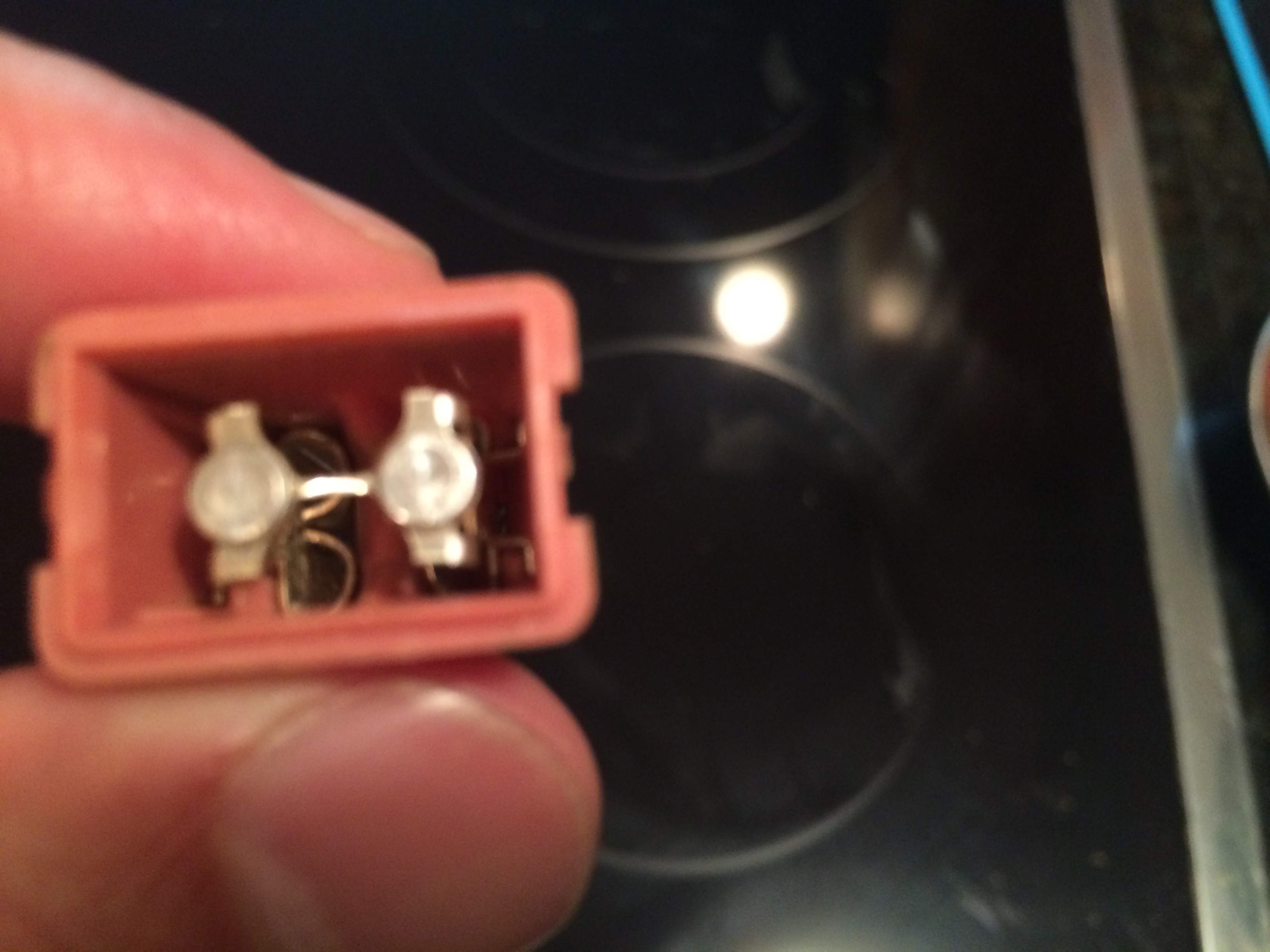

just to 100% confirm my electrical system ignorance....Is this slow blow fuse blown? I would expect the metal part to be blown but maybe it would be the glass tubes below? I can't really see in there and I don't want to force it in case it is not broken. if so do I need to replace the entire thing or just the element inside. I need to get my electrical game up to speed but I am hoping to get this going so i can use it for the weekend!
also to jump the fuse do i just use a jumper cable from the positive terminal to the starter? I don't want to srew something up because I am in a hurry

The best way to determine if a fuse is blown is to put your ohmmeter on the Rx1 scale, and see if the fuse is shorted or not. If the fuse is shorted it is good. If the fuse is open it is bad.
A fuse is nothing more than a piece of wire. It is a piece of wire that is calibrated to heat up and rupture and open up and not conduct electricity at a given current load.. Any wire conducts electricity, but depending on the size of the wire can take quite a lot of electricity before it gets hot enough to melt and rupture and open up so that it does not conduct electricity any more. If you wan to to watch a wire act as a fuse, remove your positive battery connection, and connect a piece of 24 gauge wire from the battery post back to the terminal you just removed from the post. Then turn the key to start and watch the wire disappear in a puff of smoke. Wow. instant fuse:)

Fuse looks good.
A fuseable link is not a fuse of that type.
It's built in a wire, or sometimes the wire itself, over amperage will "blow' this safety "fuseable "wire' link.
Yeah, donn. That's the "Master Fuse" 30 amp that I have on my B2620. Your's looks good to me, but if you had to replace it you get a whole new one.....probably at Kubota since it looks unique to me. Where your problem is is still a guess to me. So happy " Labor Day".

the picture of fuse looks good but need to check continuity to verify those fuses don't have a way of probing with test light but they look just like ones that Ford trucks are using they have a mismatch of fuses should be able to get these from parts house different colors indicate amperage I wish I could remember what they are called.

My slow burn (some call it main) fuse was fine. I did a lot of investigating and ended up getting a new battery which solved the problem. I don't now how cutting the positive cable messed up the battery but that solved the problem. Thanks for the help everyone! I did buy a volt meter and a continuity tester and I need to get up to speed on that stuff before it bites me
