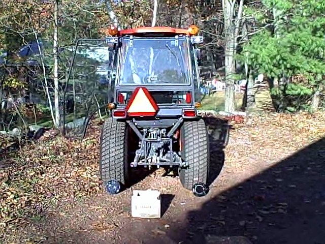

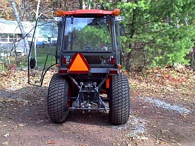

Do you have spacers on your wheels or do the chains fit without them?
/ B3200 Chains...... #13
I needed spacers. I bought the 1.5 inch ones from the Kubota Dealer. They ended up giving me a bout 2" clearance for each rear wheel. Here are the before and after pics.

Do these spacers put any additional stress on the axle?
