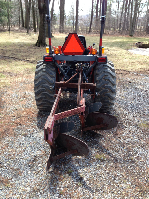

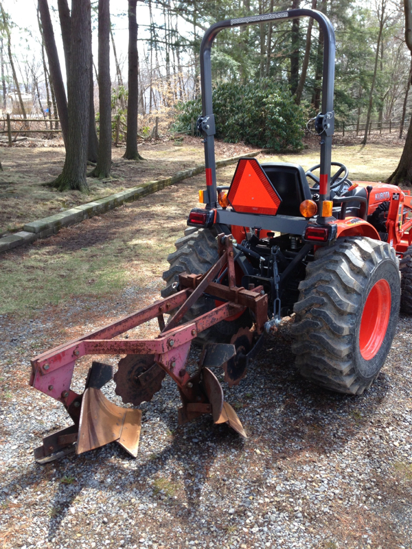

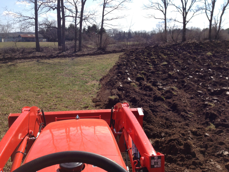

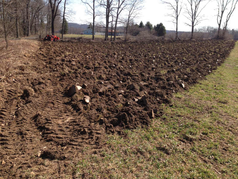

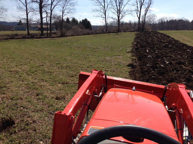

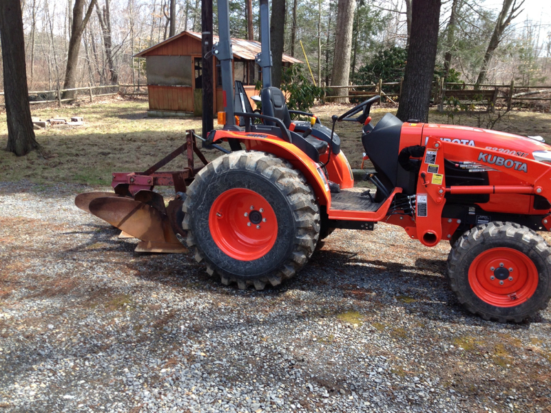

My B3300SU pulled this rented two bottom plow rather effortlessly through somewhat tight and boney northeast PA soil. Quarter acre took less than 1.5 hours to plow and it was my first time ever.
