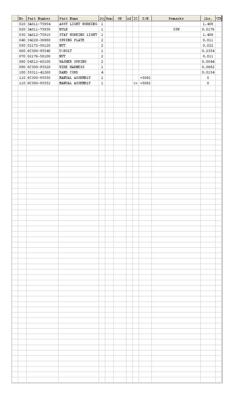

Absolutely. Price is around $70 for the u-bolt and bracket. In other words, the complete kit is a better buy.
