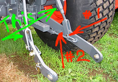

Wondering if there is a way to adjust the 3 pt arms so that they will go a little lower. seems when using the box blade it is just a little bit too high. I looked over it tonight but did not see any obvious adjustments?

Move upright rods into the front holes in the lower link arms..

Your lift links that connect to the lower arms have multiple holes and you can lower them that way!
/ B7800 3pt minimum height #8
THIS marks the lower lift links Art is talking about. You want them in hole #2 on both sides. That will lower the arms significantly.

Ditto. For those who wonder Kubota designed the front set of holes for maximum height/drop range, and the rear set for maximum lifting power. The bigger Kubotas have 3 sets of holes for this same purpose.

thanks to all for the reply... I'm a little embarrased that I over looked this, I was too focused linkage...
