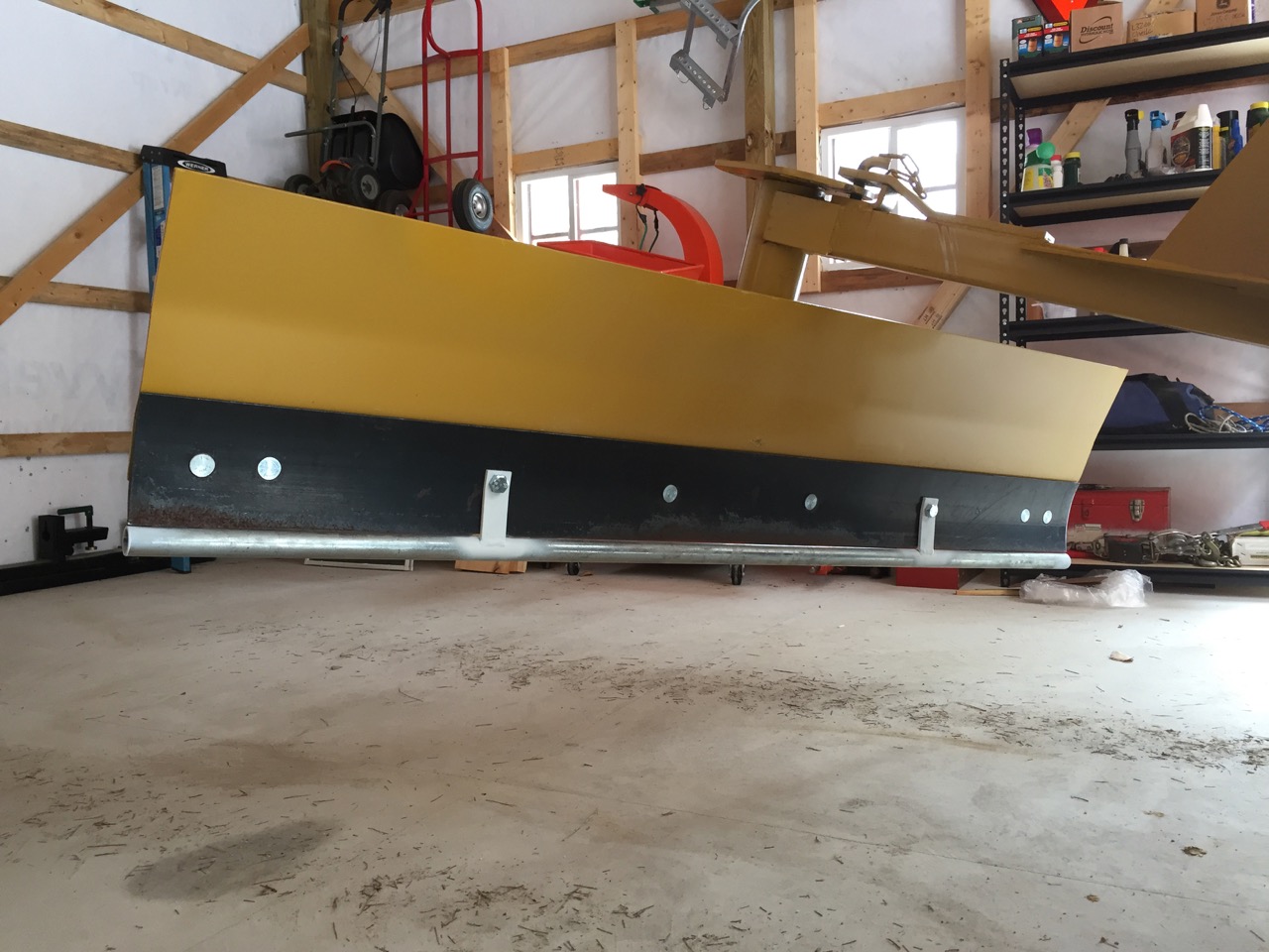

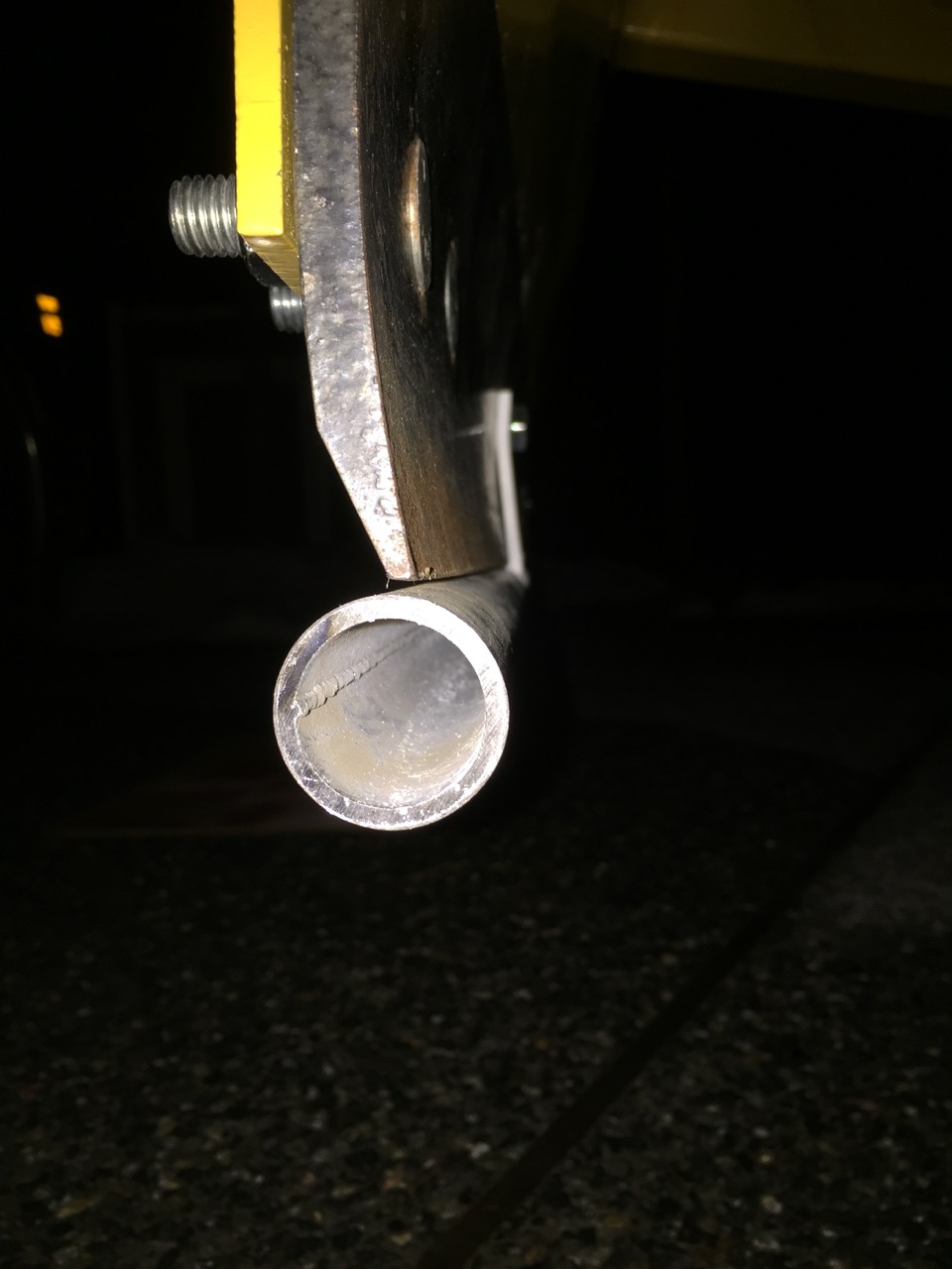

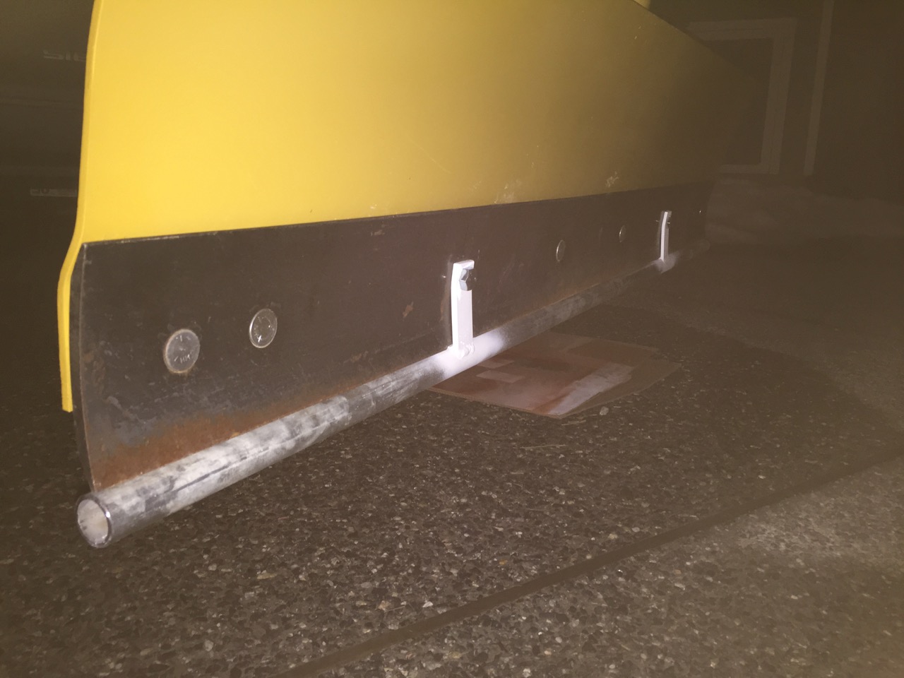

I壇 love to see a photo of the pipe on the cutting edge. I use the rubber horse stall mat between the cutting edge and moldboard trick. Works well but could dig a little deeper.
Looks funny after I plow. The rubber works like a squeegee to keep the cutting edge out of the gravel (1000 ft). Snow on the drive is as smooth as buttercream frosting!
You know I tried the horse stall mat and it worked OK, but I didn't like it as much as the pipe so I went back to that. I think both are good solutions though. I felt like the pipe scraped the snow better when very cold and disturbed the gravel less when warmer/wetter. Here's a pic of my setup -- I did it this way to make the pipe easily removable for summer use (although I haven't done anything but snow clearing with this rear blade in a couple years).

Thanks for posting the pics. I've been wondering how to attach a pipe, now I have a plan😁

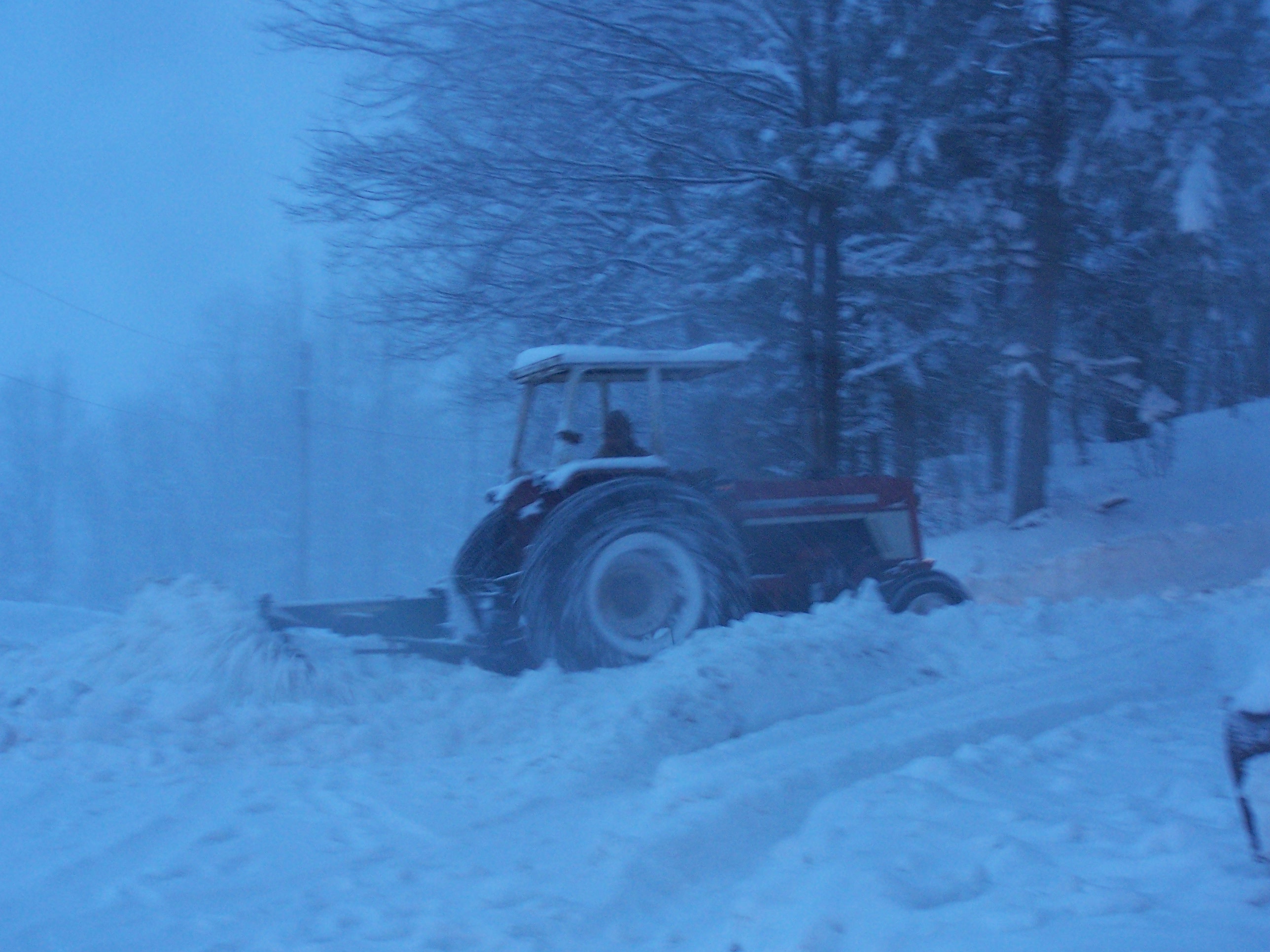

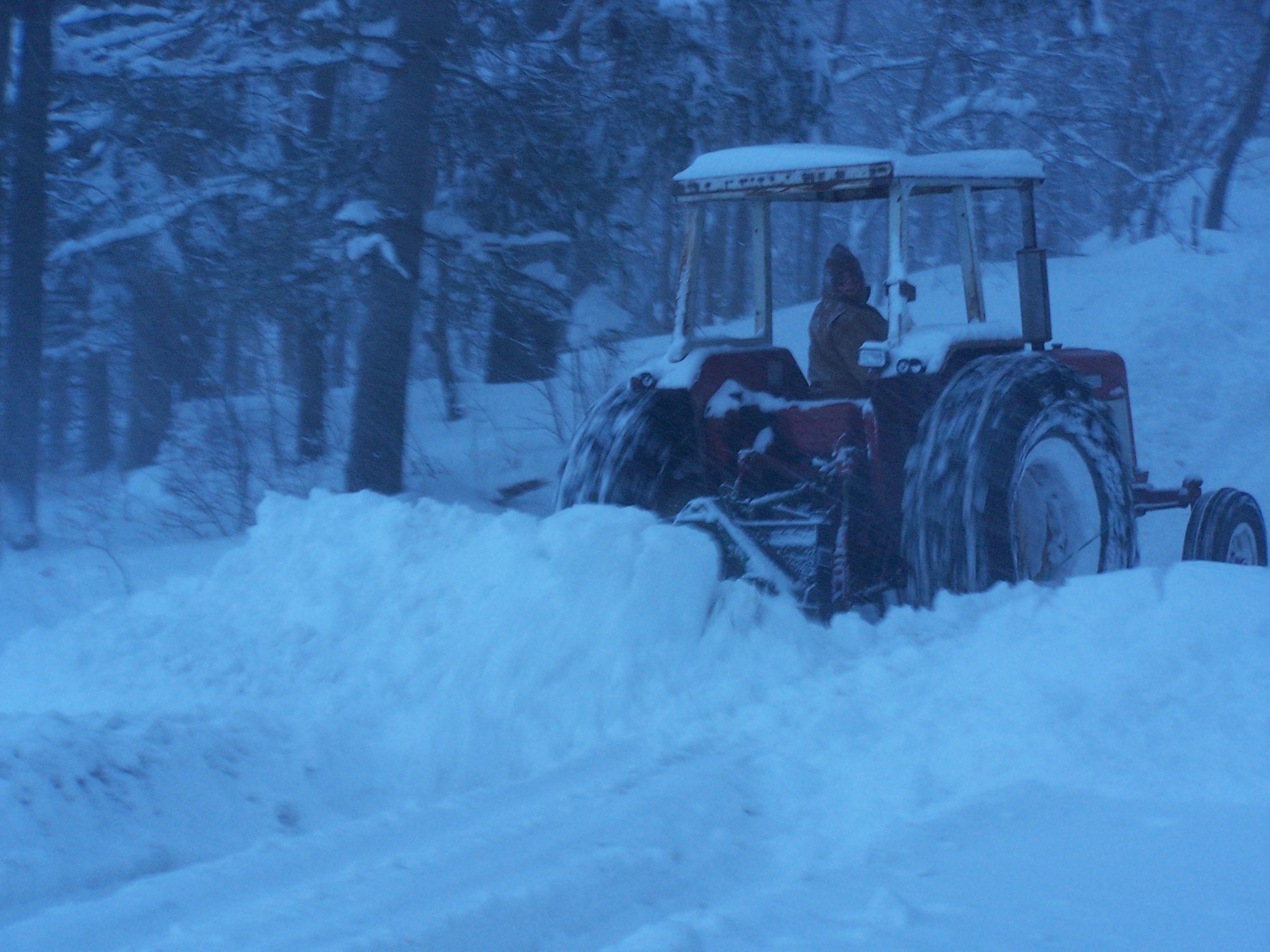

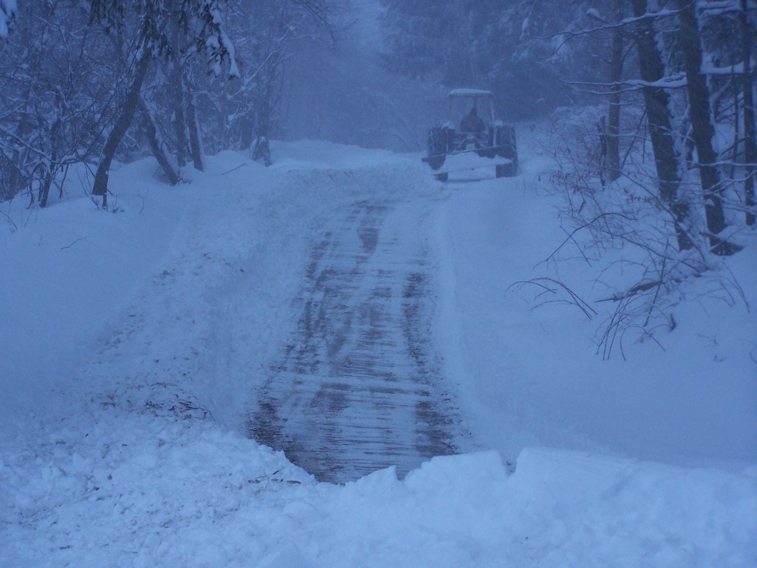

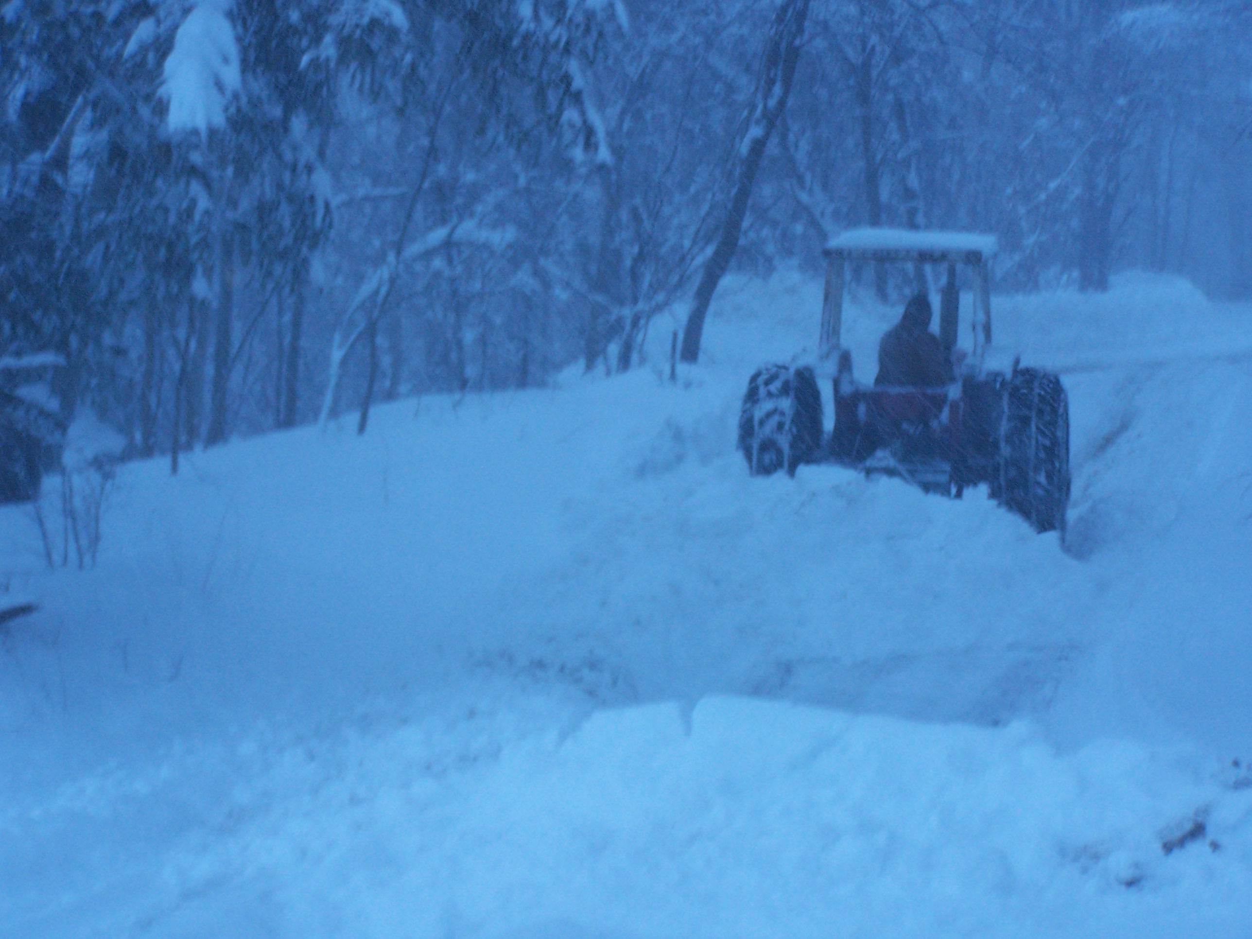

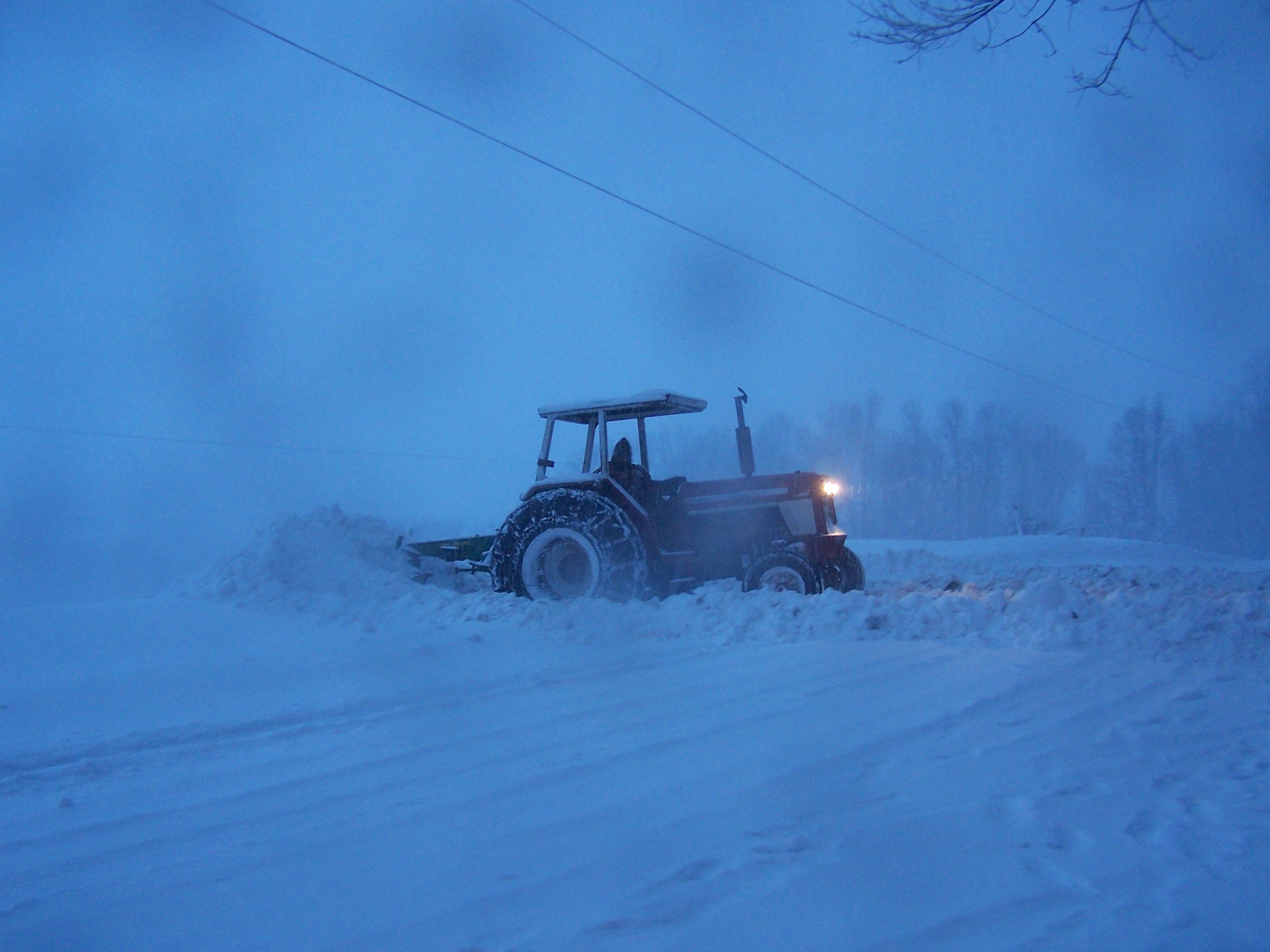

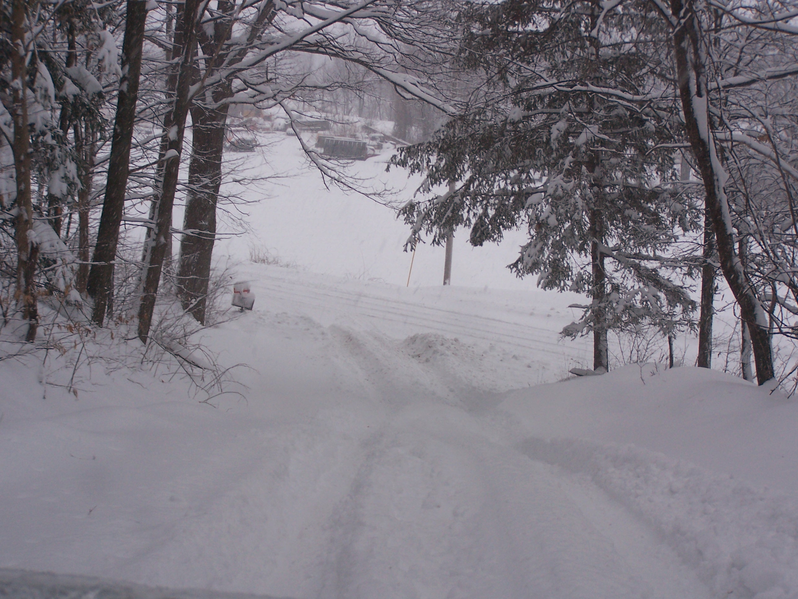

I used a back blade for a lot of years moving snow. I like the pipe idea for until a driveway gets froze, once mine got froze I'd scrape it as clean as I could. Parts of my driveway I would drive forward rolling the snow off to the side parts of it I'd spin the blade around and push it, some places sideways some straight back. These pictures are from several years ago.
you can move quite a bit of snow with a back blade.

Thanks for the pics! I had a wet snow this week and the mat smeared as much snow as it moved on the concrete. I may have to give this a try sometime.

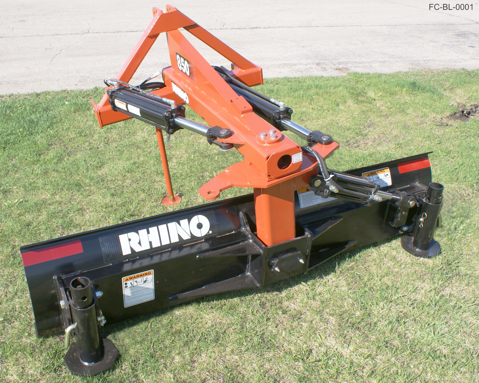

Some blades (e.g. Rhino), they just put a second hyd. cylinder connection 180 degrees apart from the other. Just pull the cylinder pin, rotate blade 180 and reconnect. Maybe there's a way, a will, and a welder that can do same?
So what's the consensus:
Should you "reverse" the blade so that it is oriented to plow-push backwards? I've always heard not to do this since there is no trip function and 3 point hitches are made to pull, not push, i.e. you risk damage?
I can definitely see an advantage of being able to drive away forward from the pile in the path you just plowed in reverse, and not be trapped.
A tip I learned was for plowing on ground that's not totally flat is to pull the "tilt" pin, or set the equivalent hydraulics to "float", so that the blade tilts/ floats and follows the contours of the ground. -Of course I discovered this after spending $800 (in parts) to add the second hydraulic function before buying the blade. Oh well, still handy when ditching dirt. Hmm, maybe the cylinder is correct length to relocate to the "offset" function, which would be handy when trying to "reach out" next to buildings and fences.
