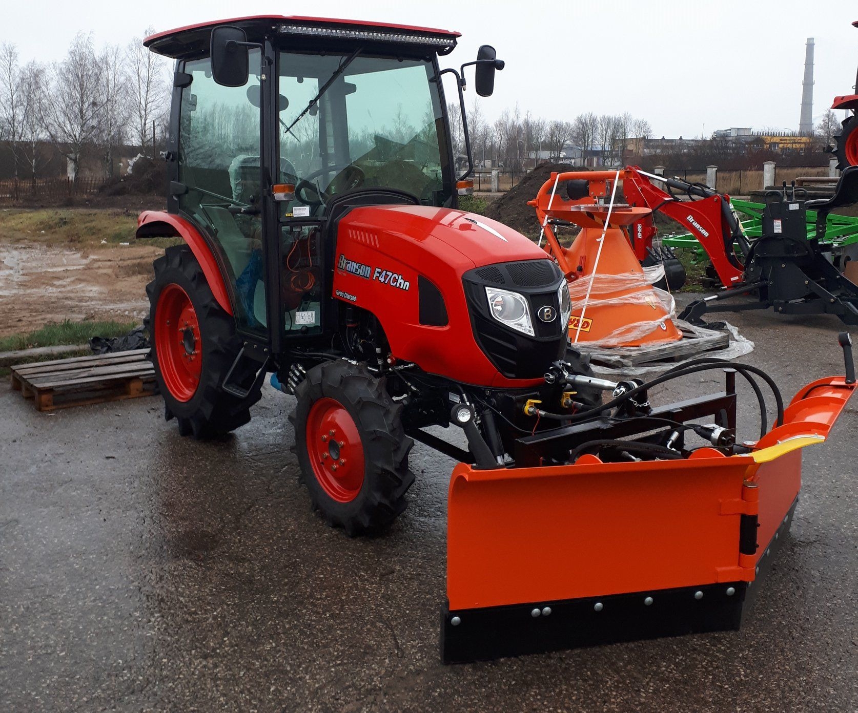

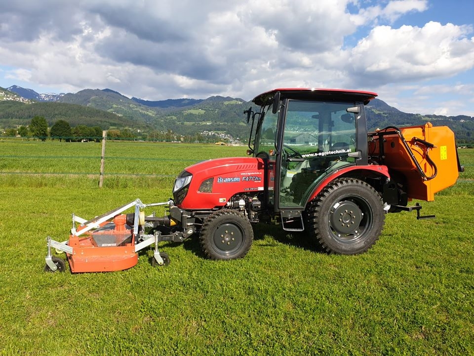

Inspiration

Make sure you have sturdy cross bracing on the front mount linkage as you can bend the lower links going around corners. At a previous job the owner user a blade directly mounted onto the 3ph and bent the lower links(sideways) . There are no stabilisers on his front 3ph. Also he was blading dirt not snow.
   / Back blade on front 3-point hitch -- Good idea or stupid? #7
I wouldn't try it. A plow needs to be able to float (and NOT by using the FEL "float" position). It would be way too Rube Goldberg. If you want to have a front plow here are much better ways to do it.
