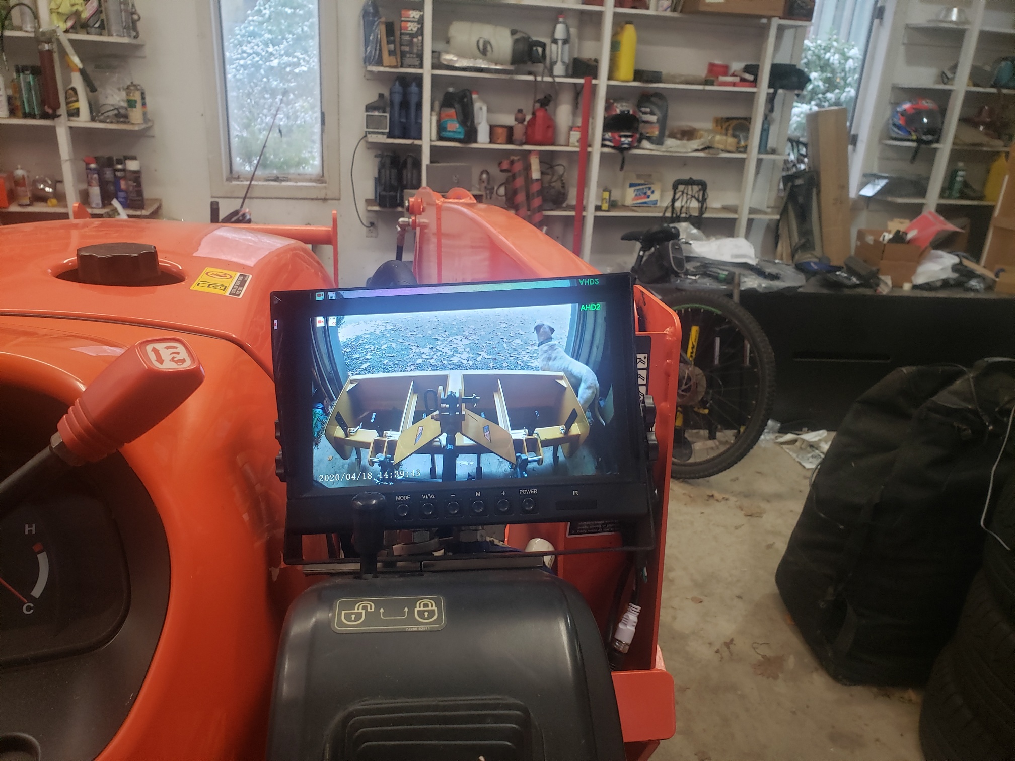

Roy I installed an inexpensive monitor / cameras package from Amazon - Amazon.com: 9" 4Pin IPS HD SD DVR Recording 2CH Split Car Rear View Monitor + 2x AHD 1:DP Reversing Backup Camera For Bus Long Truck Vehicle Waterproof 12V-24V: Beauty
The monitor is NOT rated as weatherproof which is no problem for you in a cab nor for me as I'm a ***** and don't go out in the rain. The monitor is 9" which I find is a good size. Both the cameras it comes with are mounted in the rear. One faces downward towards my implement the other straight back. I can easily see how full the box blade is or how much material the back blade is moving as well as using the second camera for backing up. I ended up ordering a 3rd shorter cable rather than the 15m one.
Downsides -
In the sun there is glare, may not be an issue for you. I mounted mine in front of my joystick:
I am thinking about fabricating a shroud around it. In the winter low sun time its an issue. Not sure how its going to be in summer. When its cloudy or the sun not directly behind you its fine.
I wish the camera angle was smaller. You can see the distortion in the image. It takes some getting used to judging distances with this wide of an angle.
Pros - after 2 cervical fusions it has reduced the amount of times I'm twisting in the seat.
Inexpensive, a little over $100
Complete kit includes everything, makes for easy install (as I said I replaced the 15m cable with another 5m one)
Last week it helped a lot using the back blade to plow the driveway.

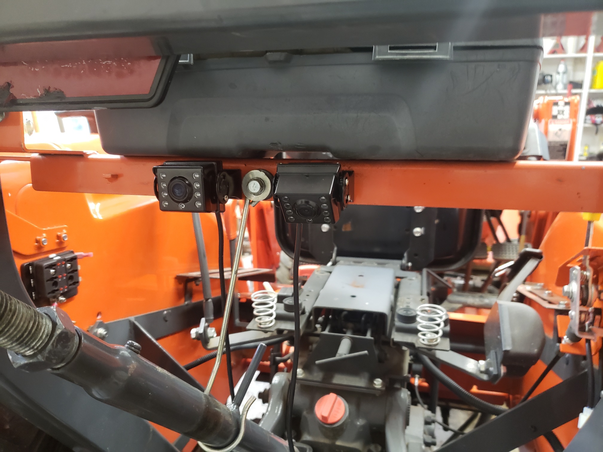

I bought the same set as Ctgoldwing. I don't have mine mounted yet but it seems to be a nice set. I did test it to make sure it would work. I'm still working on the tractor it's going on so couldn't mount it yet. With dual cameras, it allows you to select either for display or do a split screen of both cameras. It also records if you want. And the screen is 9". The 12v power is routed to main display. The included cables handle the video and power from/to the cameras. There's no extra wiring for the cameras.

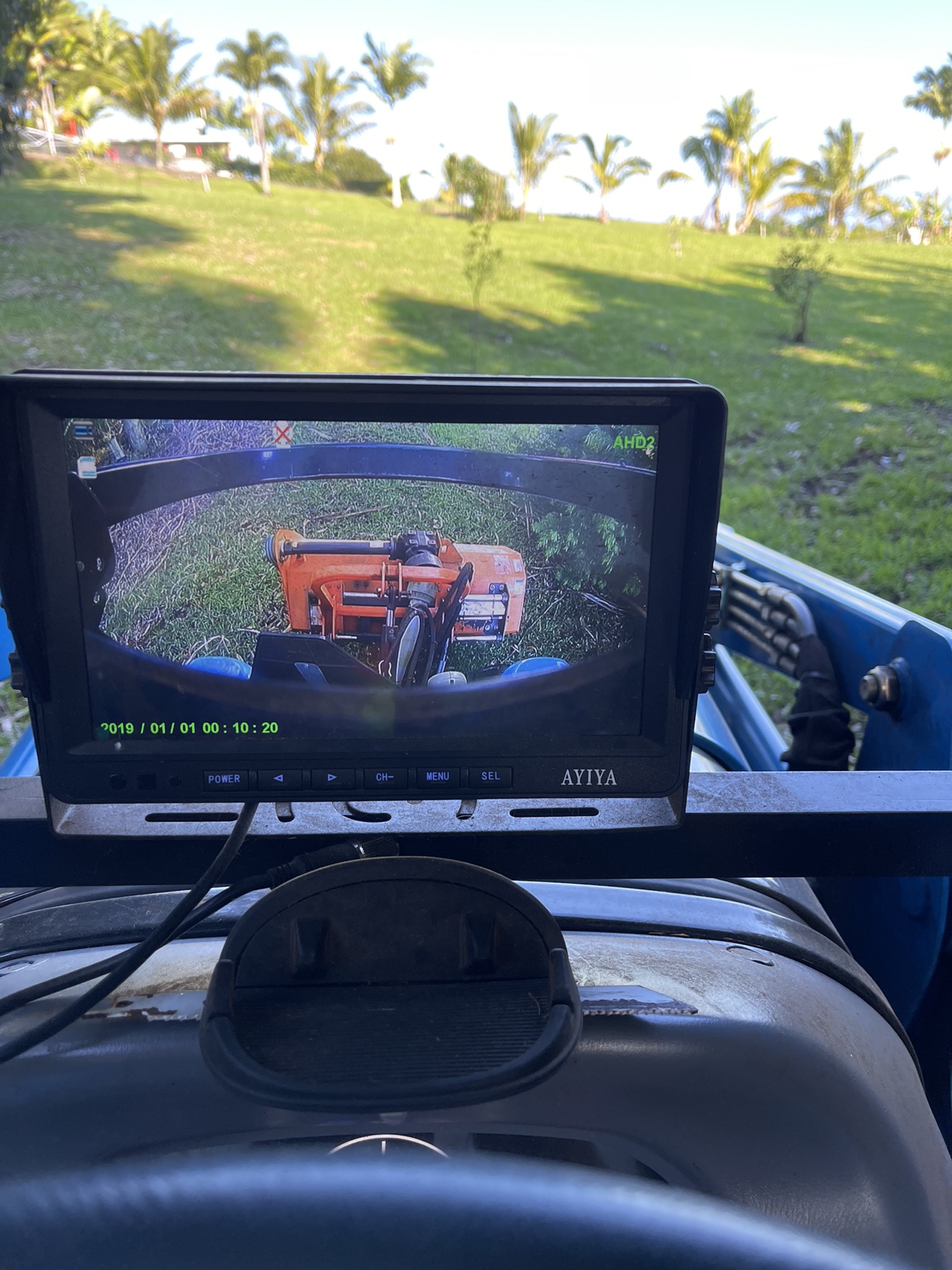

There are a whole bunch of them on Amazon and you don't have to spend a lot. There is a long famous thread here on TBN titled something like "backup camera for under $50" that I followed and used to install a backup camera and bucket camera on my tractor. I spent about $12 for each camera and $25 for the screen, piecemeal. If you can search to find that thread, read through it (at least the first few pages) and you'll learn a lot.
One thing I noticed is that there are a range of brands that all have the same cameras and screens. Some are a lot more expensive than others, but it's the same stuff. So look carefully at the pricing and products, and don't get ripped off! For a single camera and single screen you should be under $40-50 for sure.
What I like about the $12 camera and $25 screen is that if they get damaged I won't care -- cheap enough to replace. So far they have been working fine after 4-5 years, but it will be cheap to replace if something goes wrong.
I bought the same camera and screen for my last truck (for the same prices) to make a camera to watch the cargo bed and trailer hitch when I was driving down the road.

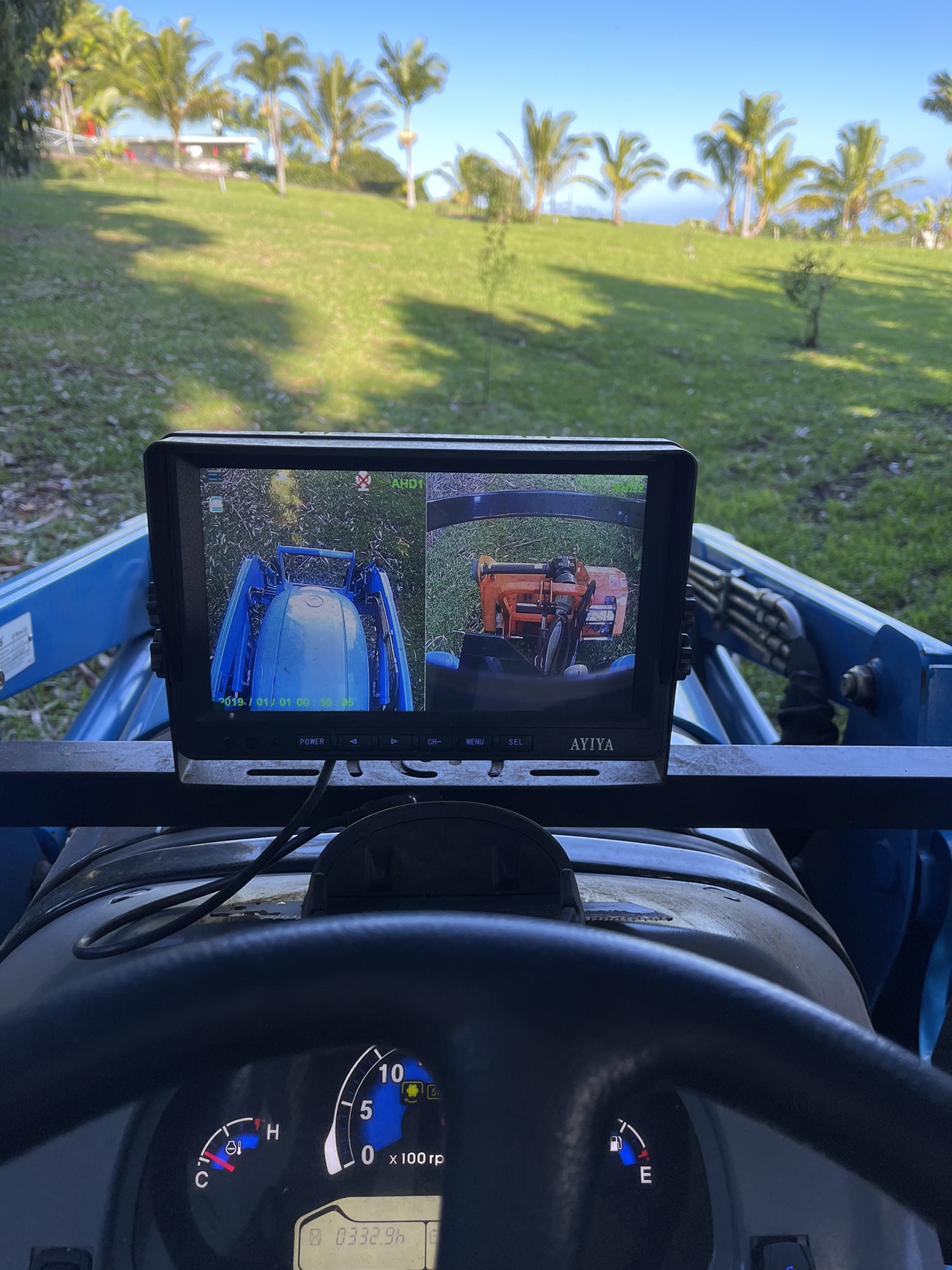

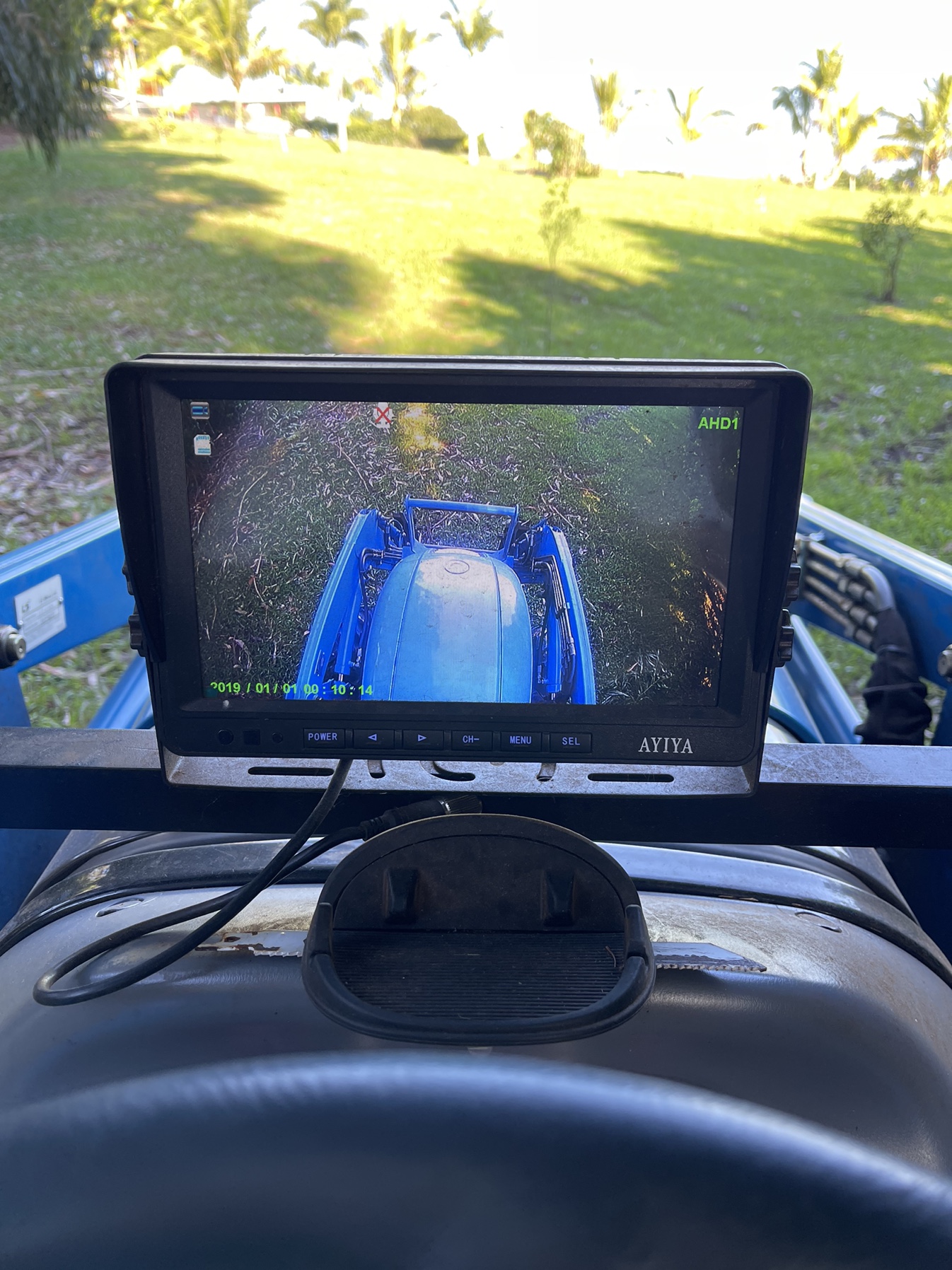

Interesting thread here. I was looking at a camera a few weeks ago.
What I've been wondering is whether a 4 or 5" screen is large enough to be useful. My cab is a soft cab on my BX and I take it off for summer. I was thinking about mounting the monitor from the roof so it would be out of the way. I had spotted a 7" monitor setup with camera for about $40, but it had a couple bad reviews. Need to look at thread s219 mentions.
/ Back Up camera #14
Ray, that might be ok just for general observation, that is close to my split screen view. But even 1080 resolution and full screen doesn’t replace actually looking for me. Still useful and saves my neck a bit.

CTGoldWing,
Do you have pics of where you mounted your cams?
Thanks, B.
