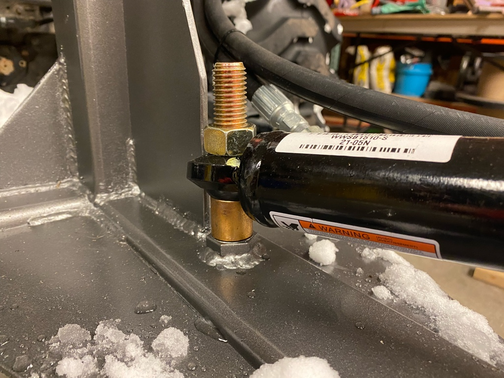

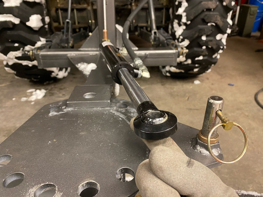

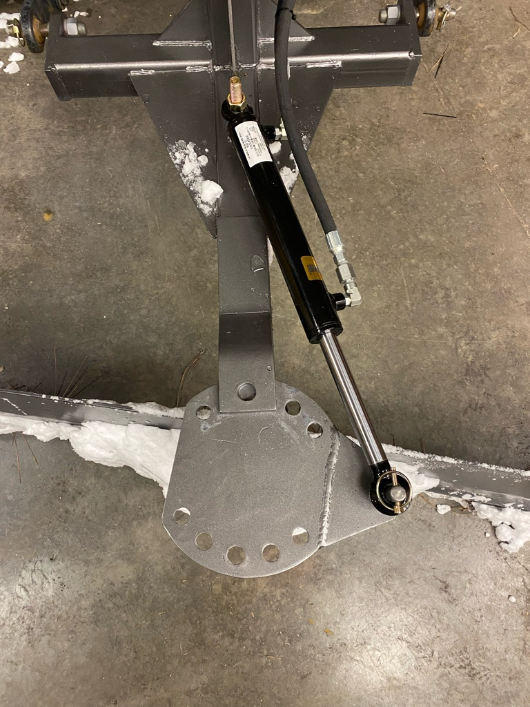

Anyhow, I was tired of jumping on & off my tractor to make angle adjustments on my backblade so I went and added a hydraulic cylinder! I had to cut off a portion of the bracket up front (at the base)so the 10” stroke cylinder would sit in the optimum position. It’s configured so if I need to rotate the blade 180°, I can just unhitch the rod end, swing both the blade & cylinder to the opposite side and refasten. Took it out today to plow snow and it worked very well but when adjusting the angle, I had to be light on the valve or it’ll jerk around so I’m planning to add an adjustable restricting valve to slow it down.
Bolts are 3/4”, spacers are brass to position the cylinder higher to allow free movement in full travel. Cleaned it up & repainted to make it nice again.

9-12229-10 1.5X10X1 DA HYDRAULIC CYLINDER SWIVEL EYES 119.50
It wasn’t easy to find the right configuration since I wanted the base to stay fixed on the centerline and had to find the sweet spot for the other end so it would replicate the same configuration as if I was doing it manually. My measurements were literally down to the 1/16th of an inch to dial it in just right.
Hoses were customized to length by Spokane House of Hoses. Just wished I had factored in a spot for the restrictor valve.

Rather than mounting an adjustable restrictor valve, I'd just throw in an $8 restrictor fitting from TSC: https://www.tractorsupply.com/tsc/p...restricted-orifice-8mp-8fpxr-tsc?cm_vc=-10005
It'll thread in line with what you have, and slow the cylinder response time way down.
The one I linked to is 1/2" NPT. Can't tell from your pic, but if you used 3/8" hose, they have one for 3/8" NPT as well: https://www.tractorsupply.com/tsc/p...restrictor-orifice-6mp-6fpxr-tsc?cm_vc=-10005

BRILLIANT!!!!!! Thank you! I’m going to order one!

I know very little about hydraulics. Does the restrictor need to be on a particular line going to a double acting cylinder, or does one restrictor on either hose work?
This thread reminded me that I want to slow down the angling of my Land Pride blade.
/ Backblade upgrade! #20
How big/heavy is the tractor and how wide is the blade.
It's a nice fab job....but be careful with it. Real possibility of blowing a hose if you snag something with the edge of the blade with such a small cylinder.
