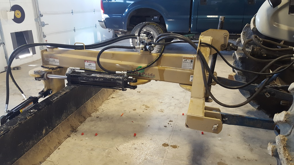

Just a suggestion, but if you position the bolt, to which the rod end of the cylinder attaches, just close enough to the center of the blade pivot so that the cylinder doesn't run out of stroke before the blade rotates to the 90 degree position, you can reverse the blade without getting off the tractor. The momentum of the rotating blade will carry it past 90 degrees and then simply reverse the hydraulic valve lever to continue the rotation to 180 degrees or whatever. I set one up this way several years ago.
Sorry but I wouldn’t do that. It would throw off the geometry drastically, not to mention skewing the ratio off the wrong way which would increase the chance of blowing out the line when the blade catches something. It’s wrong on so many levels.
/ Backblade upgrade! #42
You're right. I wouldn't do it with a small bore cylinder. I used a 3.5" bore x 8" stroke cylinder so would have plenty of power to resist high pressure buildup. The trick, when establishing locations for cylinder pins is to have the blade position at exactly 90 degrees rotation and the cylinder fully extended. Then the rod end pin needs to be far enough off center to allow desired degrees of angle, say 30 perhaps. Also, as someone suggested above, it's a good idea to keep the original pin for blade rotation position for heavy work.

..but be careful with it. Real possibility of blowing a hose if you snag something with the edge of the blade with such a small cylinder.
Before I bought my 584 IH,, I had owned a 404 IH with a loader,,
The loader was "Factory" aftermarket, BUT, someone had DIY adapted a bucket to the loader arms.
The "TILT" for the bucket consisted of a single 2" bore cylinder, mounted at the center of the bucket,,
About every 2 years, I would forget about the weakness caused by the single cylinder,, and I would snag something,,
When the bucket caught something as simple as a small root, while the bucket cutting edge was pointed down,
the pressure that built up in that cylinder easily EXPLODED the hydraulic hose.
I guess the single hose was a cheap safety valve,, BUT,,,
IT was a tremendous shock the first time it threw a mist of hydraulic oil up in the air.
After I blew about 3 hydraulic hoses, I purchased a 3" bore cylinder,, the hose never blew again.

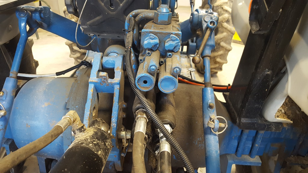

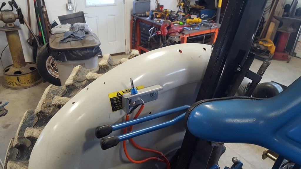

I apologize if this is a distraction. Here's how a diverter valve can come in very handy.
My Ford has two rear hydraulic circuits. With this setup I use three hydraulic cylinders. The second pic shows the electrical disconnect to unhitch the blade from the tractor. The last pic shows the toggle switch mounted on the tractor fender that selects which cylinder the lever closes to the fender controls.

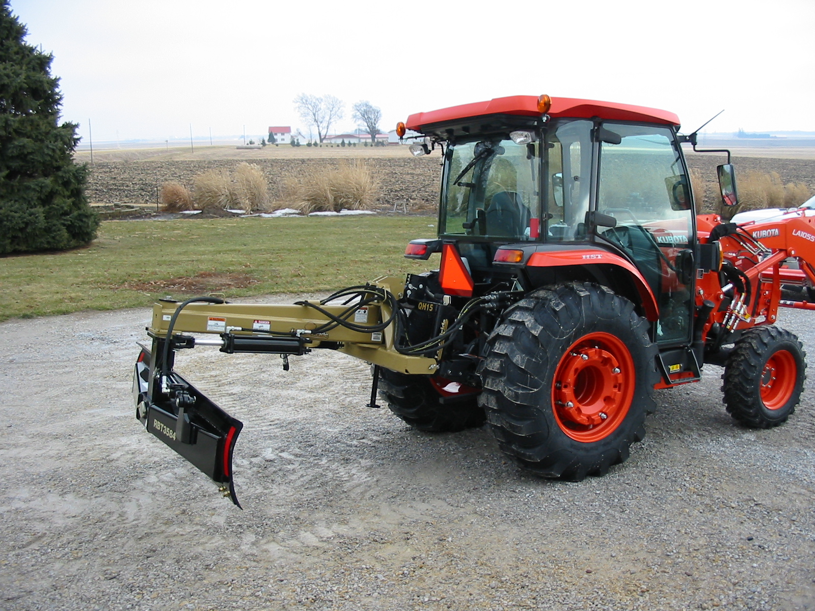

I have a Land Pride RBT 4596 with all three hydraulic cylinders and the dual tail wheel kit ordered for my Kubota M5-091. I kinda like the Land Pride products.
/ Backblade upgrade! #49
I have no complaints with my 3596. I don't think it's heavy enough to withstand the forces my Kubota could put it under. But for my Ford it's fine. I too think Land Pride makes good equipment.

Problem with a rear blade is people only think they need a little cylinder because it don't require much force to rotate the blade
The completely overlook the fact that it's a closed system with no relief and that cylinder has to HOLD that position in use.
It's a common mistake I see so many times

I was aware of it but my options were limited physically while retaining the ability to swing the blade around efficiently by just unhooking one pin. I needed a 10” stroke with the shortest available overall length. Going 12” would give me more leverage but it would force me to position the base deeper into the implement bracing.
Despite knowing the capabilities of hydraulic systems, it’s STILL a good discussion to warn others about blowing out hoses with such high leverages and to build a setup carefully. I learned a thing or two!

I've learned a few thing on this thread.
First I replaced one of my lift arms with a cylinder and utilized the existing lines for my BH to give me adjustable lift arm for blade and BB use. The issue is if the cylinder fully retracts it overpressures and the fitting leaks. Doesn't seem to be a relief valve built into that setup (from Kioti). Should I install a crossover relief valve?
Second, I was unaware of electric diverter valves. If I installed two of these I'd be able to switch between side arm adjustment and top-link adjustment.
I know I could have installed a TnT at the outset but for the price of two hoses and once cylinder I got what I really desired. Now I'm thinking of building on what I have. Any suggestions?
/ Backblade upgrade! #60
Diverter valves are often used to gain 3rd function on a loader. They are a handy tool. I think I paid $125 for my valve.
