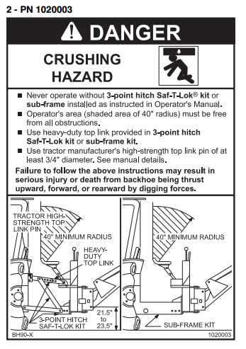

I've a Woods BH70-X, bought for my B7610. While I was looking for a method to use it on my M4700 I was in discussions with technical people at Woods. Their thought was that as you get to larger tractors the subframe was not needed, just an "enhanced" 3pt, with a heavy duty top link.
attachment.php
As far as a source I'd suggest you look at Rosseel's.
Of course, the M4700 is way more tractor than the 7610, even if both come with a Category 1 Three-point hitch.
All new hoe attachments that I am aware of, designed for 3-point use, come with the locking brace
and special stiff toplink. I have a pile of them here.
Note that hoe makers do not warrant tractors for damage caused by the hoe, and tractor makers mostly
void your tractor warranty if you put a hoe on their Cat 1 hitch.
Cat 2 is probably OK.
