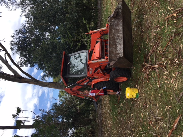

Thanks again for all the input. About a week ago a Kubota L35 came up for sale, a few dollars more than I originally wanted to spend. However support from the her who must be obeyed I am the proud owner. It's got 1250hr, light usage for a 2004 machine, though it is a bit weathered as it's last few years has been outdoors from what understand. Anyhow I picked it up a couple of days ago, the learning curve starts, no doubt I'll have a few question.

Looks GREAT!
Would look REALLY sharp (like new) with a fresh paint job!

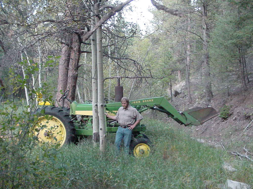

Absolutely you can do that. Larger older Farm tractors are incredibly strong in the 3pt area. And they were built to last nearly forever with minimal repairs - or none. Farm tractors also tend to be long and wide - which really helps with the balance. I'd recommend that you get a tractor with a Category II 3 pt. Those tractors with the cat II 3pt are used for pulling big plows through tough ground, they can take the stress of a small to medium size backhoe directly on the 3pt hitch. If you are using a 3pt hoe larger than small to medium size then that's when you want to think about a full subframe. Or simply don't use it so hard.
Our old 530 John Deere is an excellent example of a medium HP, heavy, durable machine with a category II 3pt hitch. We used a medium small size 3pt backhoe on it for 20+ years and although the backhoe could certainly make the 6000 lb tractor bounce around, there was never any danger of anything breaking. Got a lot of work done and all for a price we could afford. Nothing broke - ever. Stumps out, long rows dug, rocks carried, foundations dug, small pond, planted trees - you name it and we did it with that tractor and hoe. When it didn't have a backhoe on it, the tractor was used as a loader tractor or for pulling a really big rear blade and box.
Hydraulics: Check if the tractor has rear hydraulic outputs. If so, they will power the hoe. If not, then look for a hoe that has a PTO-driven hydraulic pump with a fluid reservoir on the backhoe itself. Both hydraulic styles of 3pt hoes are equally popular.
Downsides: Everything has a downside. For whatever reasons, right now in the USA it has become popular to buy new equipment. You will probably hear a lot of arguments that is the only way to go. It is probably the best, but for a handy guy it is hardly the only way. You need to be assured that a lot of the old equipment is still just as good as ever....and 40 year old machines can be surprisingly modern. They were built to last nearly forever, be easily serviced, and easily repaired.
The downside is that the owner of a good used tractor is likely going to be stuck with it. The US used market is full of good machines; they are hard to sell for anything close to what they are worth. The same goes for implements.
Go for it; you've lots of choices.

Good choice! Those L35's are workhorses. If it's in decent condition it should do everything you want. Not a bad plan to give it a full service and look for anything that's worn or damaged that may become a problem. Since it's got low hours and has been sitting out, there may be controls, linkages, etc., that have become bound or frozen from lack of use and the weather. Get them loose now with penetrating lubricant and a gentle touch will save much frustration later.
   / Backhoe Bargin needed #16
Nice tractor! You couldn't have done better.
