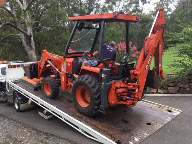

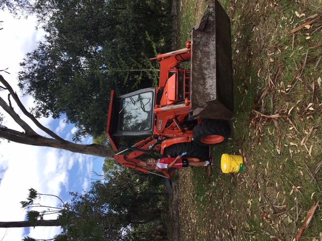

Thanks again for all the input. About a week ago a Kubota L35 came up for sale, a few dollars more than I originally wanted to spend. However support from the her who must be obeyed I am the proud owner. It's got 1250hr, light usage for a 2004 machine, though it is a bit weathered as it's last few years has been outdoors from what understand. Anyhow I picked it up a couple of days ago, the learning curve starts, no doubt I'll have a few question.
Looks GREAT!
Would look REALLY sharp (like new) with a fresh paint job!
Good choice! Those L35's are workhorses. If it's in decent condition it should do everything you want. Not a bad plan to give it a full service and look for anything that's worn or damaged that may become a problem. Since it's got low hours and has been sitting out, there may be controls, linkages, etc., that have become bound or frozen from lack of use and the weather. Get them loose now with penetrating lubricant and a gentle touch will save much frustration later.
