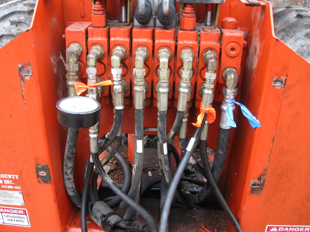

You want to put the gauge on a hose where it would connect to a cylinder. Or on a output from the BH valve,which ever is more convenient. You don't want to dead head the pump,it will harm the pump.
   / Backhoe blowing hoses #38
I would tee the gage at the input to the BH valve. That way, anything you do will be reflected on the gage. I would also check out the QD's and maybe replace.

Guys, I finally got to test some of it this morning with a pressure gauge. On all the fittings after the BH valve, pressures are reading at 2500 psi max. I did not have the fittings to hook to the supply line between the pump and BH Valves.
I'm beginning to wonder if its not just a case of worn hoses but possibly am I getting higher pressures with the AW 46 Hydraulic Fluid vs. the 10w40 motor oil that was in it?

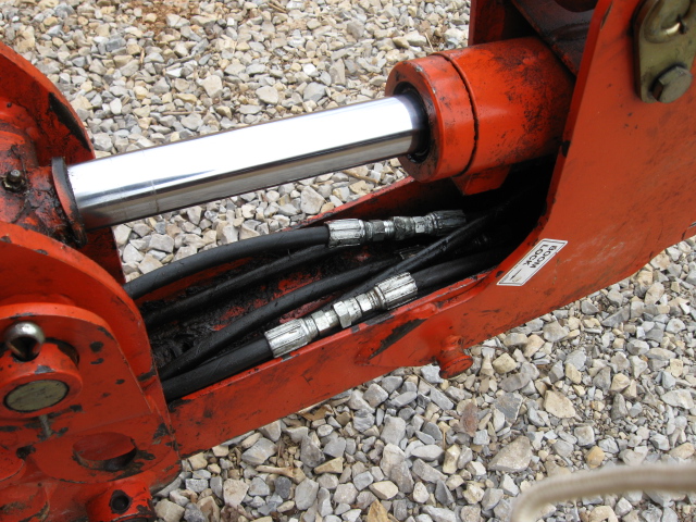

The picture here shows the hoses that have blown. The orange flagging shows which hoses have blown. The two on the right (one is behind the other) is backhoe arm lift cylinder. The two on the left are curl for the backhoe arm. The supply line is marked with blue line.
The second photo shows where most of the "blows" have taken place. With the cluster of fittings here now, I'm sure I just need to replace the hoses. Otherwise all these fittings will rub holes in each other.

No Hydraulic expert for sure , but as mentioned above , If a hose bursts on my BH , I replace entire hose . I only repair hose if I happen to damage a connector , ( which i have done on my stabilizers when retracting ) .
My BH is about the same age and over the last 1+ years have had to replace 3 hoses . Both for Bucket curl and 1 of the swing lines . The Bucket curl lines both burst were they run on top of the boom . Different locations , so no rubbing involved , Nor any bends in line . Most likely just the constant exposure to sun and elements .
I figured if I had to snake that bucket curl line out of there , I was NOT going to just repair it and have it happen again .
