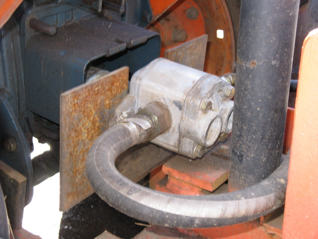

Here are the pictures of the rear of the subframe as mounted to the tractor. The 1/2" plate at the bottom bolts up to the ROPS mounting holes. The 2" tubes that you can see closer to the center of the tractor run the full length of the underbelly and are welded to the 3"X4" cross member that the loader uprights bolt to. I'm also planning on making some tabs along the length of these tubes for the subframe to bolt to more points on the frame of the tractor to add support and stability.
I'm going to try to design something that the backhoe can attach to, but that will still allow the use of the 3pt. hitch. Any bets on if it can be done?
