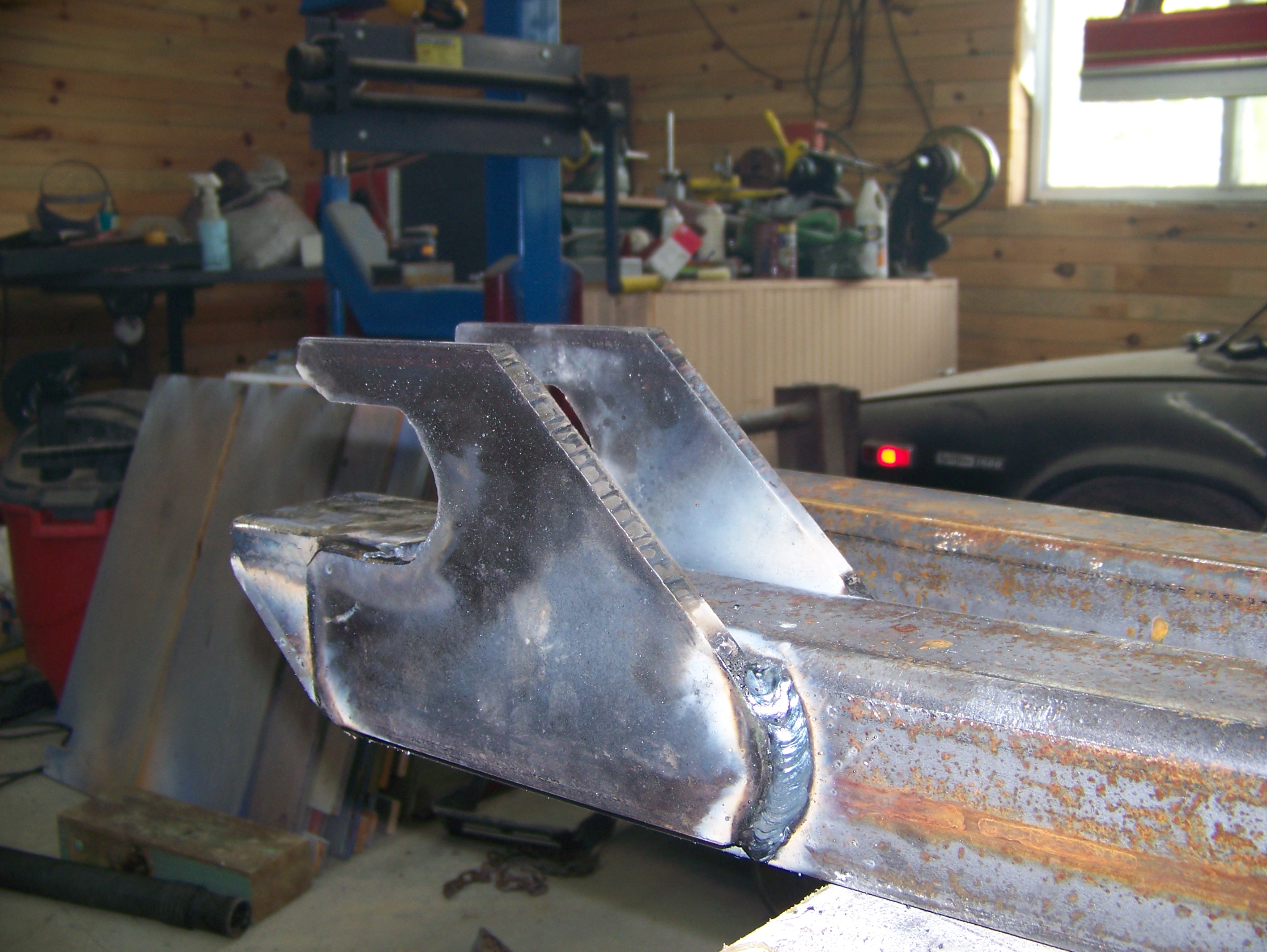

I believe you can see this in my pic here of the rear hoe brackets. The slots are for a cross-bar on the hoe, aligns it up/down and front/rear. The 'ear' sticking out of the side just fits between the rails that run forward to the loader cross member. This aligns left to right. Once I have the pump attached and the cross bar sitting in those notches it is a matter of using the swing and crowd on the hoe to get the front bolts (on the arms that run forward to the loader cross member) to align. Some days it works like cake and other days it can be a pain. The initial alignment of the tractor when backing up to the hoe is the tricky part.
On the Kubotabooks.com site there are several Kubota backhoe parts manuals that might give you some design ideas.

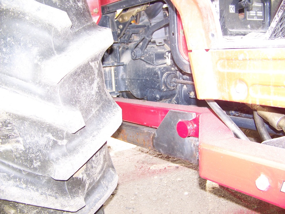

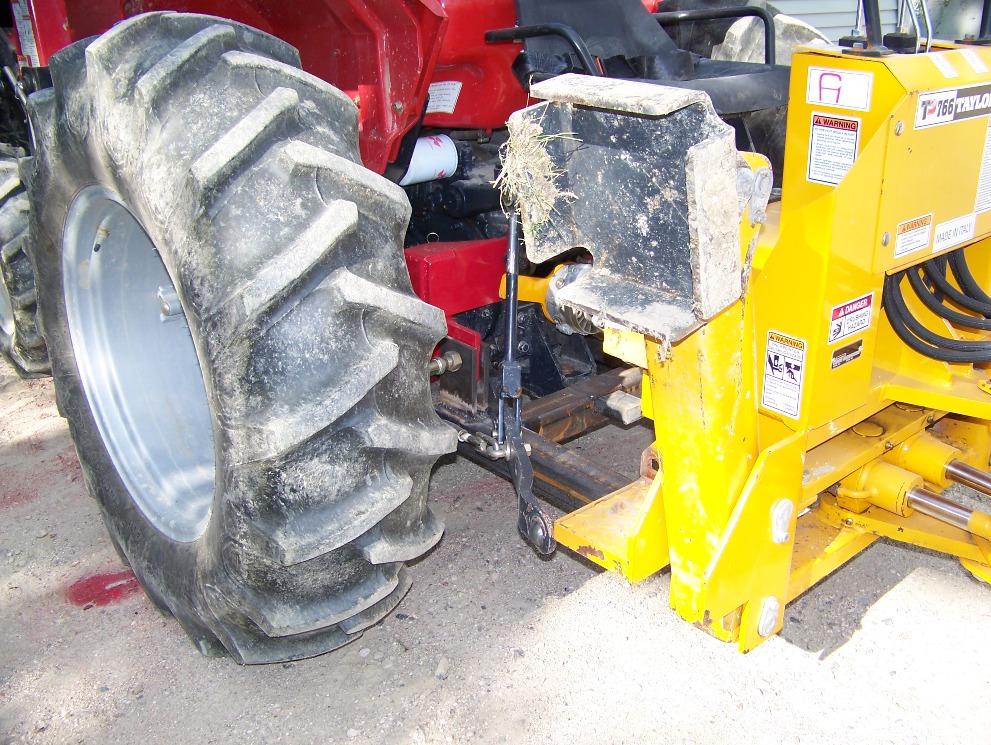

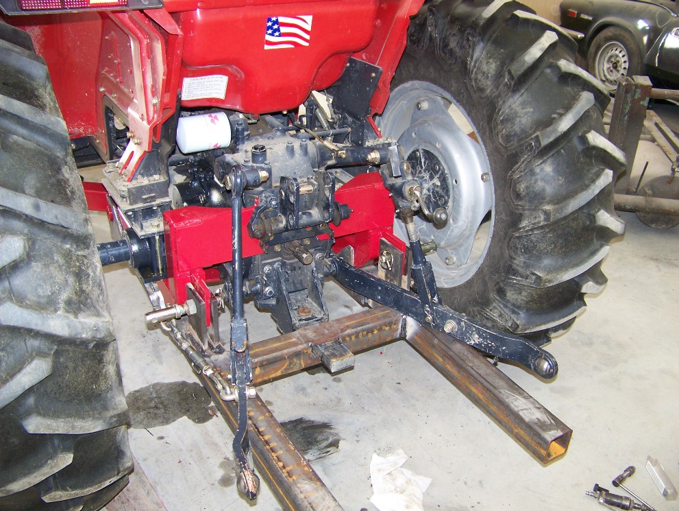

I thought I would post the link to my subframe fab. I had allot of the same concerns and mybe it would give you som ideas. This link started as a repair of my woods loader frame. I hope it helps.

Wow!! Excellent fabrication skills. Thanks for that post. I've got your subframe all figured out, but I'm not sure how your backhoe attaches to your subframe. It almost looks like you have a second subframe that interconnects with the subframe that stays on the tractor.
I'd love to see a picture of the tractor and then a picture of the backhoe when they are not attached to each other. That may help me figure it out a little better.

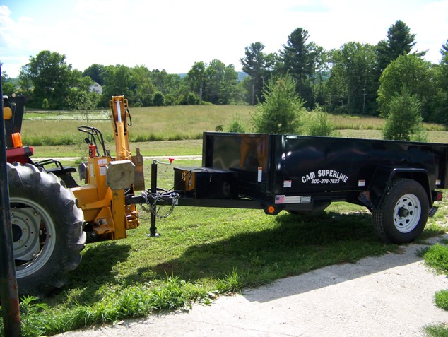

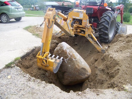

I did make a separate frame that goes under the tractor and slips onto the pins that you see at the mid point. Then I put the riggers down and pin the back. Also note the hitch bar goes though as well.
I went looking to see if I had some more pictures and I have found a few. They were posted before but I can't remember where.
pond5 28 07 004.jpg,pond6 9 18 07 002.jpg,pond6 16 07 055.jpg.
I added the last few to show some of the uses.
The rock was heavy and it pulled it out without trouble. I thought that you would like to see the trailor attached. This has worked very nice. I did lower the hitch some for easer loading. With the offset I can dig and load without unhooking.
Phil

Holy Cow, Phil!! That's a big rock!
Thank you very much for those pics. That's a big help.
