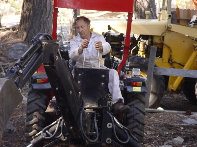

The reservoir is set on mine is about 7inches higher, he made stand offs, to clear the hydraulic pump. It must be a bigger pump. I like the way yours is set, easier to use the foot rests. Richard
   / Backhoe first time! #38
I found that one, the one by stumppuller, not sure how it would help with downward pressure. Richard
As the boom comes up, either lifting or ripping, the base frame of the backhoe, which is resting on the outriggers, wants to rotate outward from the rear of the tractor. It is like you put your elbow on a table and try and curl a heavy weight upward from the table surface and toward your shoulder, your shoulder wants to move toward your hand if your body dosn't resist this force. On these backhoes, The only thing resisting this movement is the backhoe frame bolted to the subframe rails. These rails are not all that strong, and will flex. A bracket attached to the toplink on the rear of the tractor will help the subframe resist this force.
As for your tank, on all the pics I have seen, the tank top is at the same height as the footrests. Got any closeup pics of your tank arangement and installed pump?
#39
here is a shot showing that the tank is above the footrests. I'll put up with that. I think the next thing I do would be to arrange for less pressure on the return line. Richard I just looked at the picture, it doesn't show the tank.

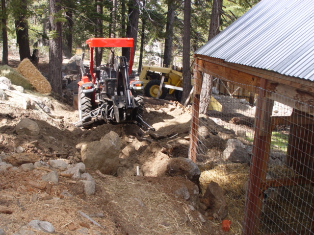

#40
I think you can see it in this shot. Richard
