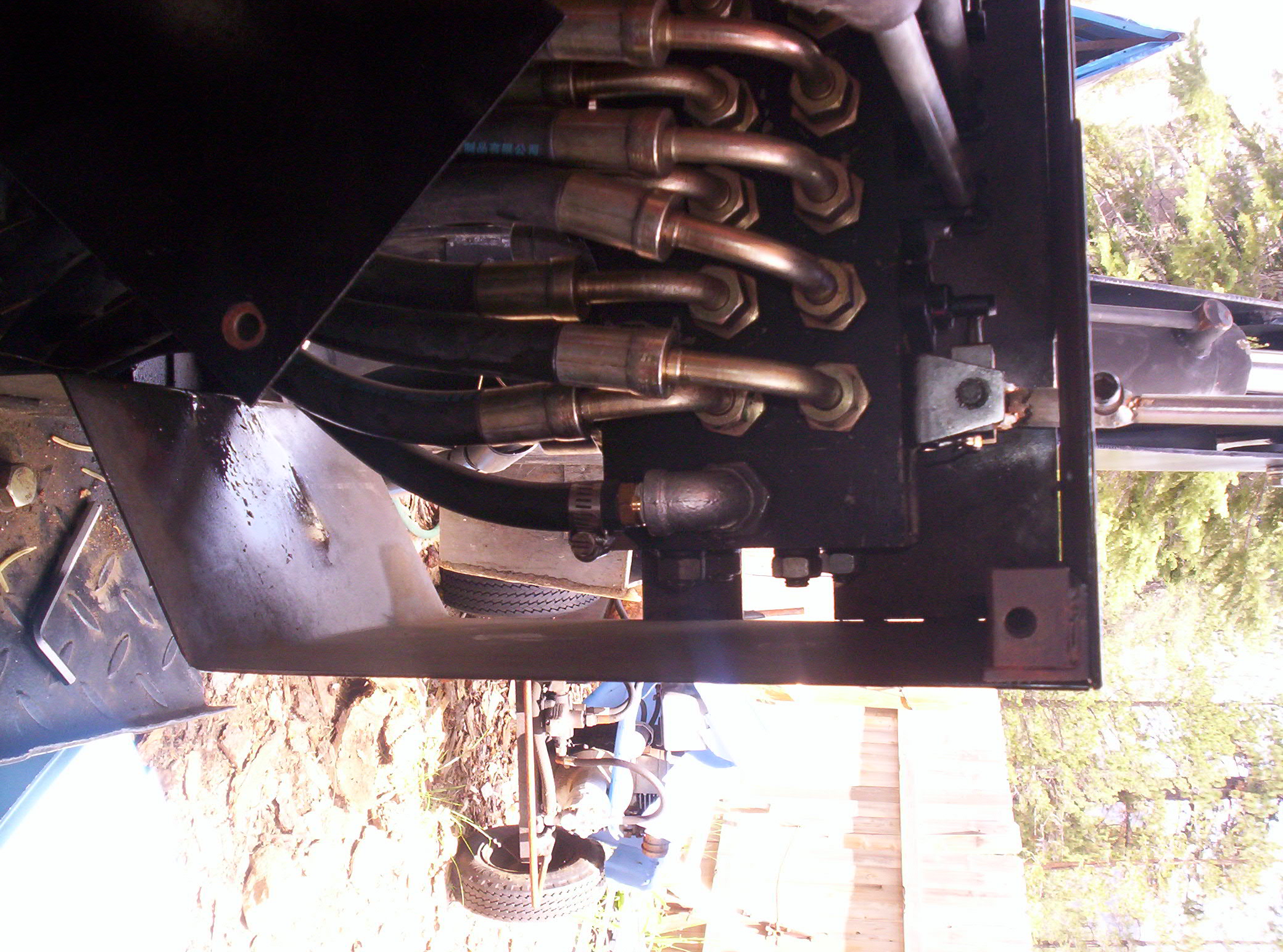

   / Backhoe first time!
#53
Tank installed hose attached.

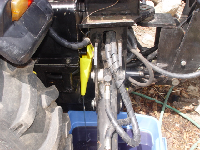

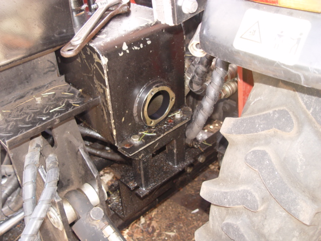

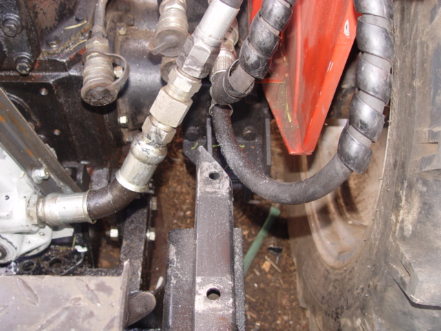

#54
Bracket and tank were trimmed to stop chaffing of auxillary hose to FEL. Pictures taken with a different camera could not be posted. But enough could be shown to give a picture of the work done. The Backhoe worked very well with no hydraulic oil oozing from the top of the tank.

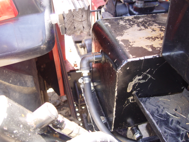

#55
Here a shot of the original fitting installed on the valve body with 3/8" ell and barbed brass fitting.

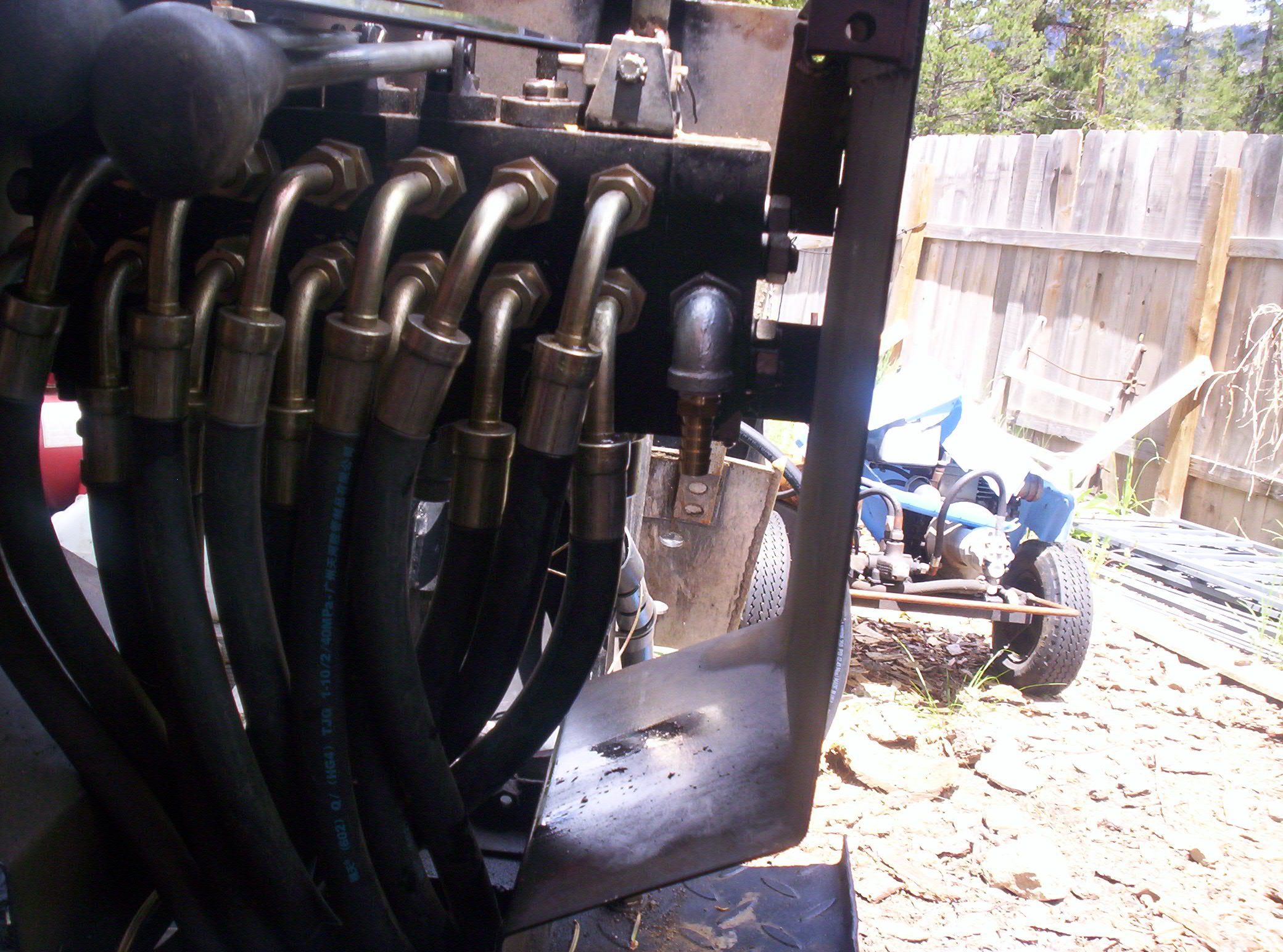

#56
Been having trouble posting pictures from this one camera. This should be a pic with the hose installed.
