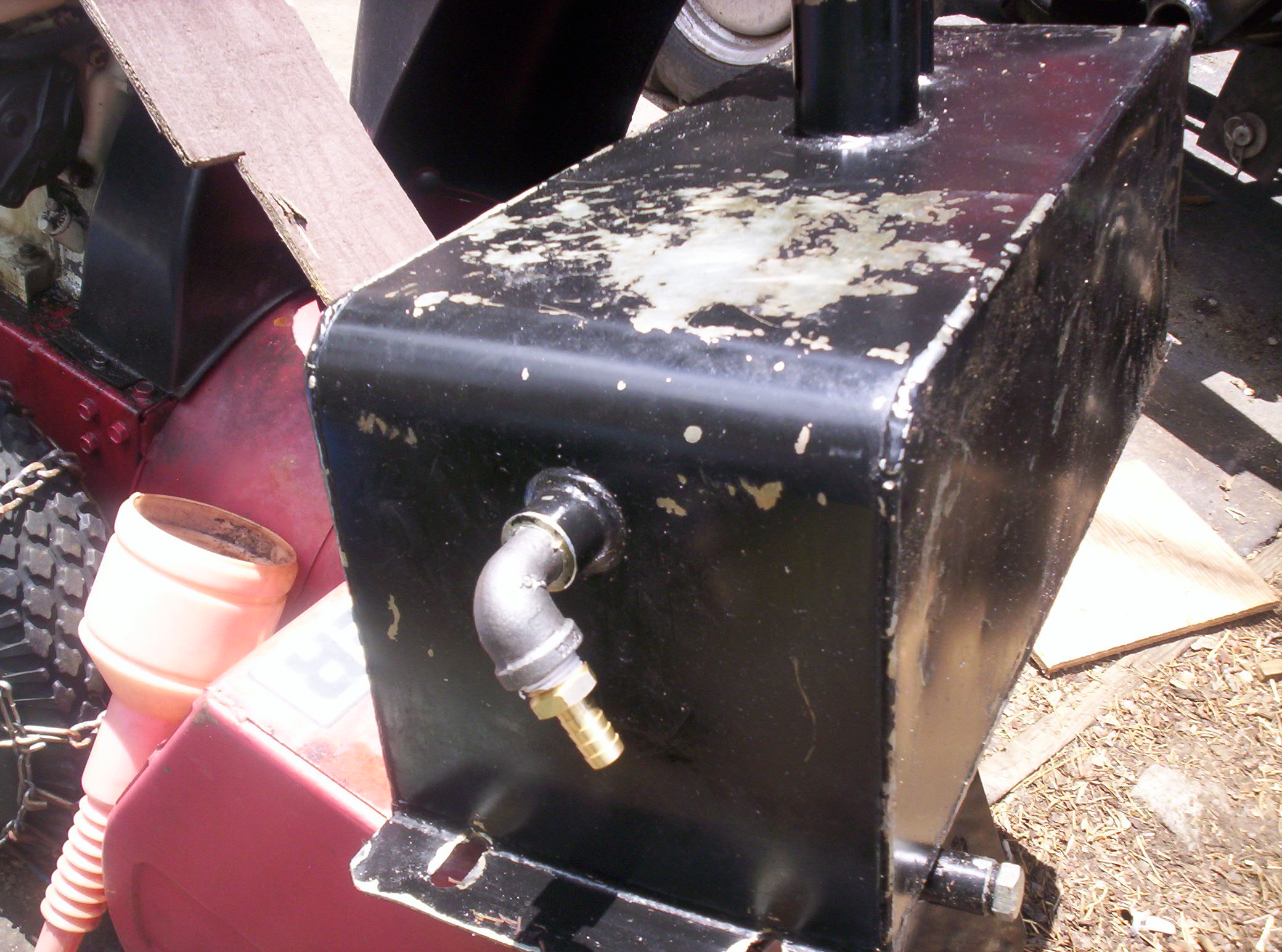

#42
Ron, Re: your post #27: I ordered a 45/64" drill bit I'll tap the return 1/2" NPT and instal a 1/2" street ell. I haven't looked at the return line origin is it at the valve body? If I can open that up I'll do that also. Richard
   / Backhoe first time! #43
Yesw, it is up on the valve body, on the right as viewed from the operators seat. If I recall the fittings are 18MM. You should be able to get an 18MM-NPT adapter at your local hydraulic shop, and you could replace the whole hose quite easilly with an oil rated 1/2" hose.

#46
Drilled the return, threaded to 1/2" NPT.
Can't post a picture. Richard
#48
Hardpan, punched a hole in the filler tube below the tank top as you discribed. Richard
#49
Hydraulic tank return. Tapped to 1/2" NPT. Shown with street ell and barbed fitting installed.
