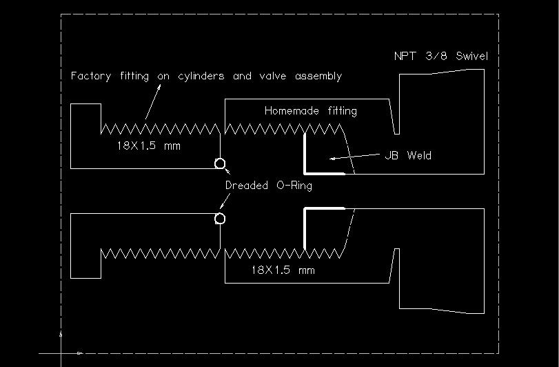

I have a Guilin backhoe that I've posted about before. The problem is the hydraulic fittings when the hoses fail. And the fact that there is very little parts available (ok, next to nothing). I was able to get 4 adapters to convert them over to American JIC37 1/2inch. But now the dealer I got them from does not even respond to email. And nobody else seems interested.
So heres what I've researched.
It would appear that the male fittings are 18mm at 1.5 pitch with a flat face and O-ring seal. Has anybody found anything to convert these other than the Chinese adapters that appear to be extremely rare? The typical internet based metric hydraulic fitting companys have nothing for this that I can tell.
I'm in the process of making my own adapters with swivel 3/8 NPT fittings on the ends which will allow for TSC and Bomgaar's type hoses to work.
I'm wondering if the current LW's backhoes have this same fitting on them. And if anyone has retrofitted theirs to take hose's that are widely available.

Try http://www.fittingsandadapters.com/metric.html
Get the 18mmX1.5 thread male to 3/8 pipe female. Then order 3/8 pipe hoses and connectors from http://www.northerntool.com
You can also order 3/8 male to 1/2 male and change everything else to 1/2 pipe from Northern also (you will have to buy some 1/2 pipe female X 1/2 pipe female). Gets expensive though, when you have to buy 4 of everything.

Thanks for the info. What I need is a 18mm @ 1.5 p FEMALE with a flat surface end for the oring seal. All the connections on the cylinders are male 18mm @ 1.5 with a o-ring groove (containing the o ring) machine around the diameter of the hole.
I have a 18mm tap on order. I bought some 18mm 1.5 metric nuts and they seem to fit somewhat loose on the connections, but they do fit the treads fine. I bought several 3/8 NPT swivel connectors at Surplus Center when I was in Lincoln the other day. They were only 1.40 each. I will use these to make the new adapters.
I'm going to try and make some adapters. I have a lathe, welder. Right now I'm trying to not take off the cylinders and weld on new connections. If I'm going that route I will probably try and fit on a new valve body assembly. Since this one is so goofy but it does seem to work. The biggest problem with the valve body is the valve rod for the left-right pivot has some kind of built in pressure limiter on it. It is not very strong. I took it apart last summer to see if there was something that I could modify. When I get more time I'll play with it more. Mine is not like the valve body on the current LW's. But I think the hose connections may be the same.

Update on the fittings.
I made 4 adapters using these from Surplus Center.
http://www.surpluscenter.com/item.asp?UID=2005030306530510&item=914&catname=hydraulic
I drilled them out to 21/32 for the 18X1.5m tap. Then used JB weld to fill them to the apropriate depth. Then machined the JB Weld to a flat surface for the O-ring to mate against. And drilled out the centers.
So far I have installed 2 of these Rube Goldberg fittings. And tested the backhoe. They are on the push side of the main cylinder. They did not leak. Got to say that JB Weld is some really fantastic epoxy.

Thats probably not too out of line for the price of custom fittings. Considering I spent $65 for 2 custom hoses with some fittings to make a tilt cylinder. These are $1.50 each. Then probably .75 for the JB in each one. They are just a trial and error to fix mine.

</font><font color="blue" class="small">( Yo Jim,
Check this site out Browse the entire site you may find what you are looking for - let me know.
)</font>
As far as I can tell they don't have anything. Heres a cad side pic of what I have to work with. The right hand fitting is the one I made up out of a 3/8 F to 3/8 F swivel connector. You can see the o-ring in a groove around the passage on the factory fitting.
