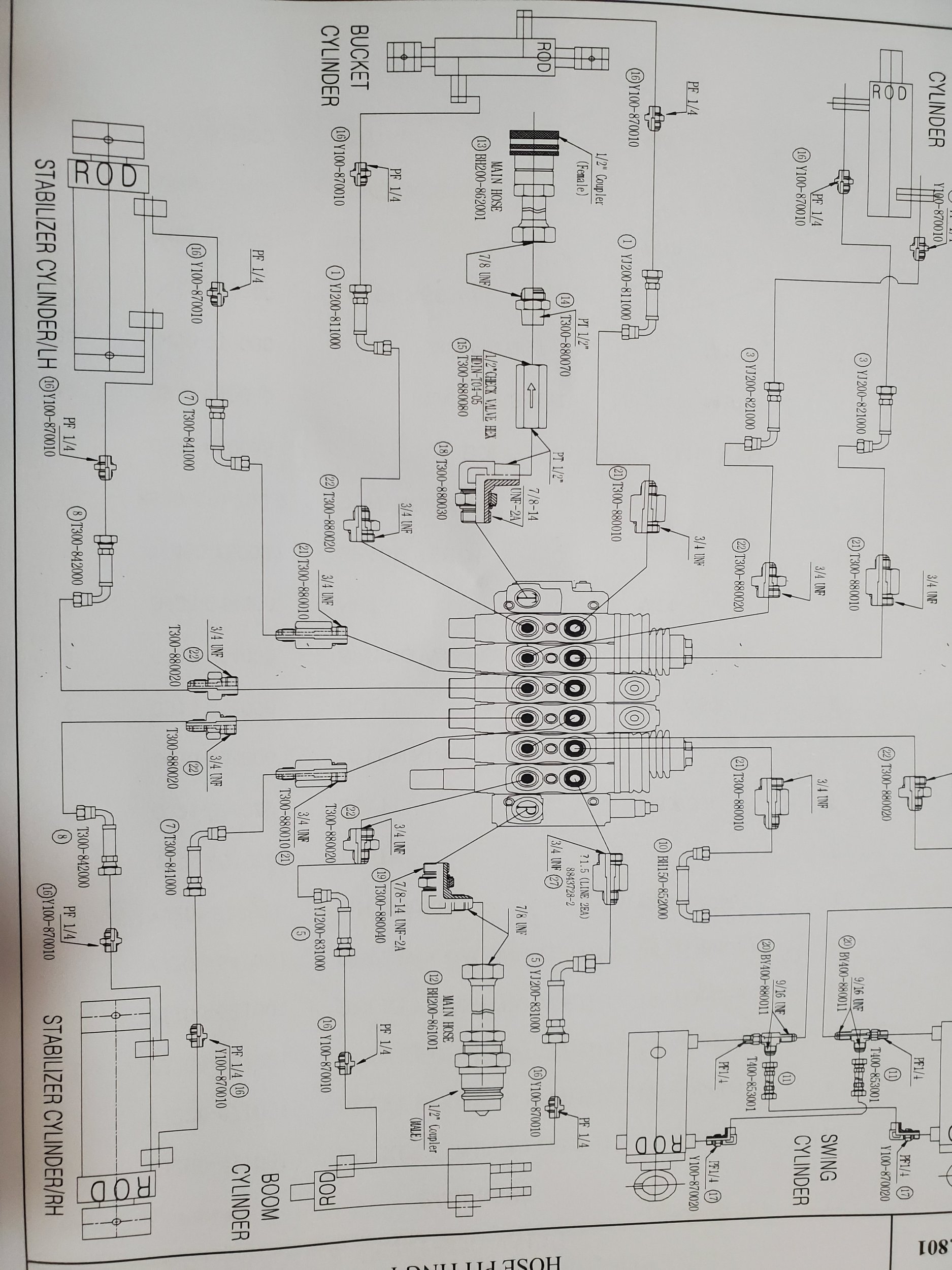

How does the Branson BH design their swing geometry? Got a diagram? Some BH use one swing cylinder and some two. Geometries vary. Your dealer sounds great; the tech team sounds a bit lame. That is partly a generational decline in mechanical abilities everywhere ..... but luckily here on TBN we have an advantage over traditional shop mechanics.
rScotty
I posted the diagram a couple of days ago and will attach it again. Is it what you are looking for?
Yes, it uses two rams. And my dealer is a great guy, however, he is not super knowledgeable in mechanics, it is why he parrots what BS he was feed by Branson geniuses.

ok, tried some things today:
1. Disconnected the rams from the boom. The BH swings freely by hand. So, no problem here.
2. Ran the rams without connecting them to the boom. Interesting note. The rams are connected between them hydraulically (llok the the diagram on the "Swing Cylinder" part) The oil coming out of one cylinder under the pressure goes to another cylinder to help in the movement, but the movement is not correlated between them as i would expect. They act like there is air inside. When one rod extends, it takes a while for another to start retracting,. I would expect it would to it immediately since all oil coming out of one cylinder immediately goes to another. But they behave with delay like there is a cushion or an absorber.
3. Swapped the hoses with the outrigger valves. no change.

Since the swing cylinders were not mechanically tied together when you did your test the cylinder with least resistance will move first and then 2nd cylinder. One cylinder would have pressure to blind end the other to rod end so blind end would have greater working area and probably extend before other cylinder with pressure in rod end.
Be nice if TYM - Branson had a detailed schematic for the valve stack vs all of us trying to guess what is going on

Yes, I did see the original diagram. It's interesting. I've not seen a hydraulic diagram quite like that before. It looks to be set up for ordering parts rather than hydraulic info. What we could use for troubleshooting is a little more detail on how the various valves regulate the flows.
BTW, I believe that the diagram you posted disagrees with the description of how you describe the flow in #2 above. It is hard to be 100% sure without a flow or schematic diagram - and without more details about the T part BY400-8800111.....but if it is a simple T....then the way I see it, that diagram doesn't show that the oil coming out of one cyinder goes to the other cylinder to help in the movement. That's good. It would be odd if it did.
My guess is that in each extension direction the combined expelled flow from the cylinders is returned back through the valve to the sump without any regeneration. Take another look and see what you think.
