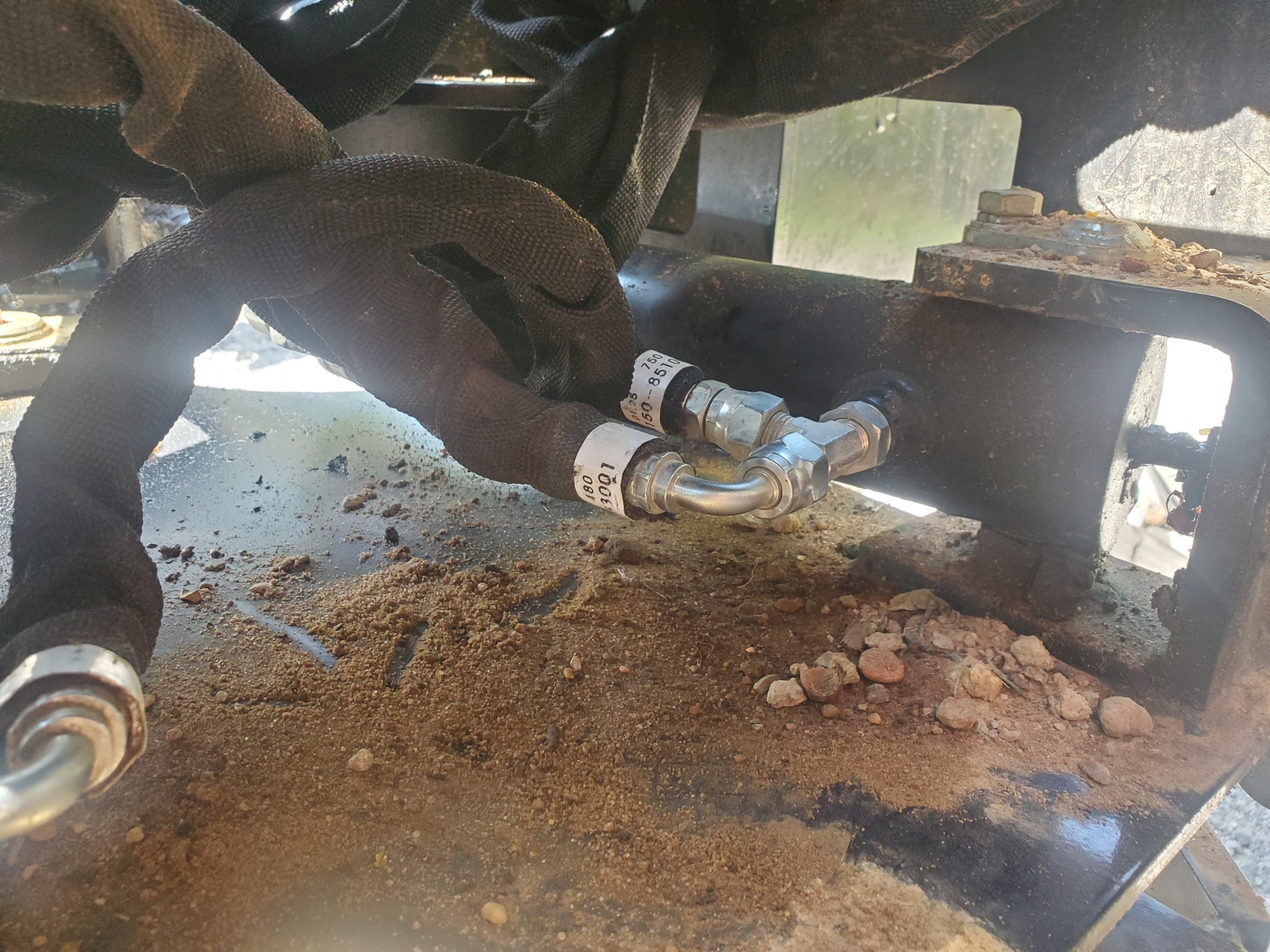

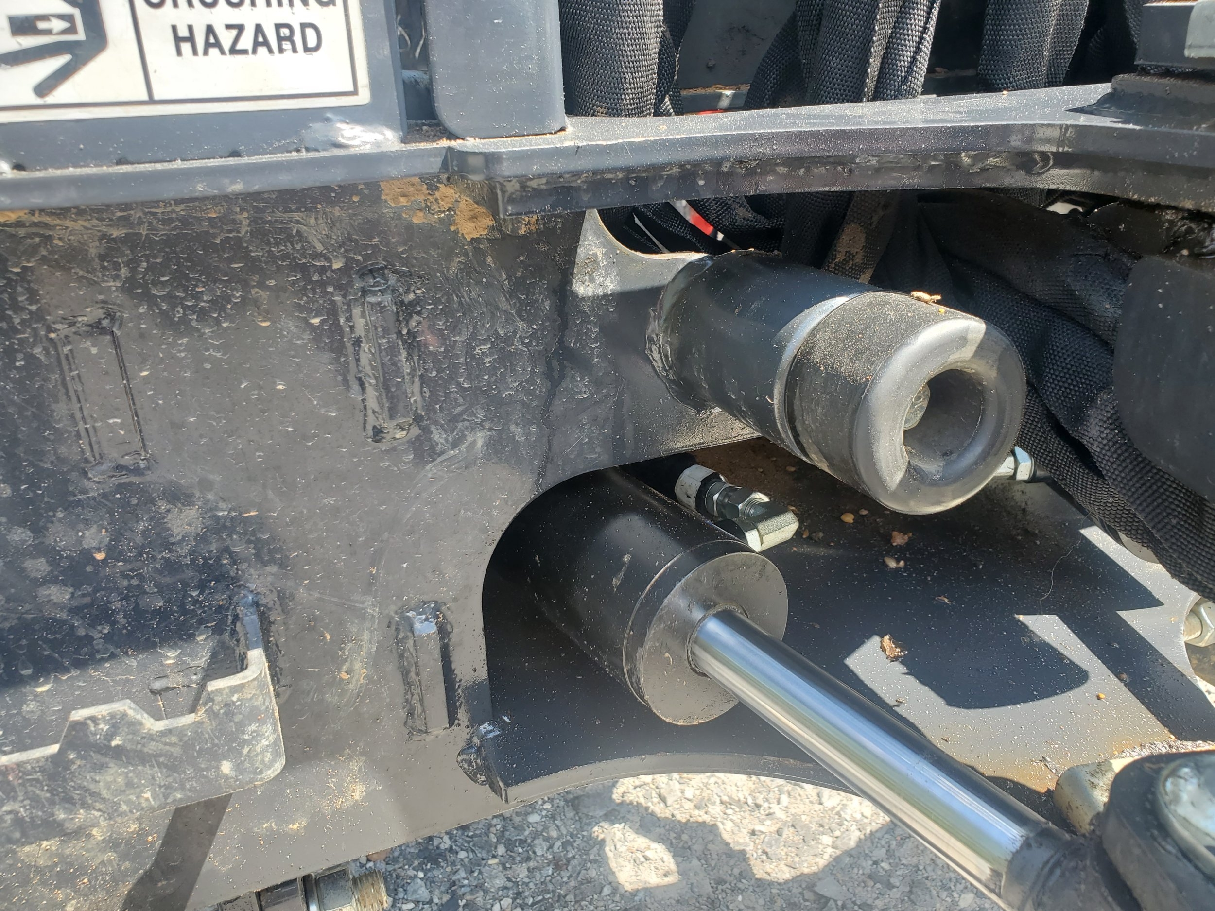

Another reason i'm thinking about trapped air is the connections to the cylinders not on the top of it, but on the side which theoretically can trap some air above the fitting. But again, it is my theory which is most likely wrong.
there are the pictures
I like your theory. Swing cylinders tend to sit horizontal and pivot at the end. So one could argue the port should be up on top where air would accumulate. I went out and looked at our hoes.... On the Kubota the retract port is on the side and the extend ports are on the bottom of the cylinder. Well, that seems odd.
It makes me wonder if that bottom port could have any bearing on why the M59 does have that occasional loss of swing force problem that nobody has ever figured out.
Then I looked at our JD 310. Uh oh... it has the swing ports on the side just like your Branson. An internet seach shows the same for the Case 580, other JD 310s, and the Cat 416 - as a group probably the world's best known backhoes. They all have the swing ports on the side. No Joy for the theory.

Typically any air that leaks into a cylinder gets compressed under pressure then when the pressure releases the compressed air forms many little bubbles instead of one big one. This allows the fluid to hold the air and carry it out of the cylinder on the next cycle. I think this is one of the things that fluid chemist strive for. At least that is my understanding.
Interesting thing about the swing cylinders is that my BH only has single acting cylinders for swing. They are plumbed to the valve as if it were one double acting cylinder. So in this case there is no difference in cylinder volume from extend to retract. There is also only the push from one cylinder and no "pull" provided by the other one. Trade offs...
One other thing to consider when observing speed changes of the swing is the pivot point geometry. As the rod end extends past the center line of the boom pivot the effective distance from the rod end to the center pivot gets shorter. Even though the rod is extending at a fixed rate, the rate of rotation of the pivot changes. This will be most obvious when the bucket is out all the way. Perhaps this is what Branson was referring too when they said it was normal.
