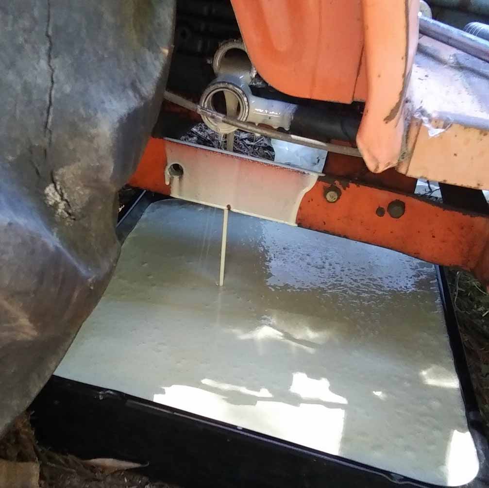

The overflowing pipe in pic #2 is on the tractor? Try running the tractor with pto on and at the engine speed that corresponds to 540 rpm at the pto, without putting the BH's pump on the pto. Maybe you ran the post hole digger at low rpms or not long enough to show the problem.
Overfilling the tractor's transmission could cause oil frothing which could make some oil come out the breather. But the pump on the pto shaft can't put pressure or oil into the transmission.

I've wondered if the peculiar milkiness is due to the detergents in modern oil.
Yes, and the detergents and other additives seem to keep the water in suspension indefinitely. I drained 6 gallons out of the above Kubota B8200, and put it all into clear 1-gal jugs. After more than a month waiting for recycling, there is no oil/water separation.
What this means is the OP could have water in the oil for years, and not suffer from major deleterious effects due to separation.
For the B8200, I drained the sump, and added "SOUNDGUY's Elixer", a mix of isopropyl alcohol, ATF, and diesel. Then ran the tractor a while and drained that. After adding real THF, it will be drained again in maybe 10hr of use.
I also heated a small sample of the milky fluid to see if I could boil off the water. It worked, but a LOT of water was in there.

Looking at the 2nd photo, that circled part doesn't look stock to me. Does it only overflow when the PTO is operating? It sort of looks like a home-brew part attached to either the suction or pressure port on one of the tractor's internal oil pumps. I don't know the Jinma 554, but a diagram of the tractor's working parts should show that port. Tractors with powershift sometimes have an extra hydraulic pump in the transmission. But it is usually not related to the PTO and certainly not to the backhoe.

I will have to post more specific pics Tomorrow. The PTO pump fits on a small shaft up above the main PTO shaft (the large, splined shaft). I pulled the pump this evening, and clean hydraulic oil came running out around the small shaft on the tractor (flowed out for a good 10 minutes...at least a couple gallons). Backhoe sump is way down. So, it appears the pump was definitely driving fluid into the tractor.
