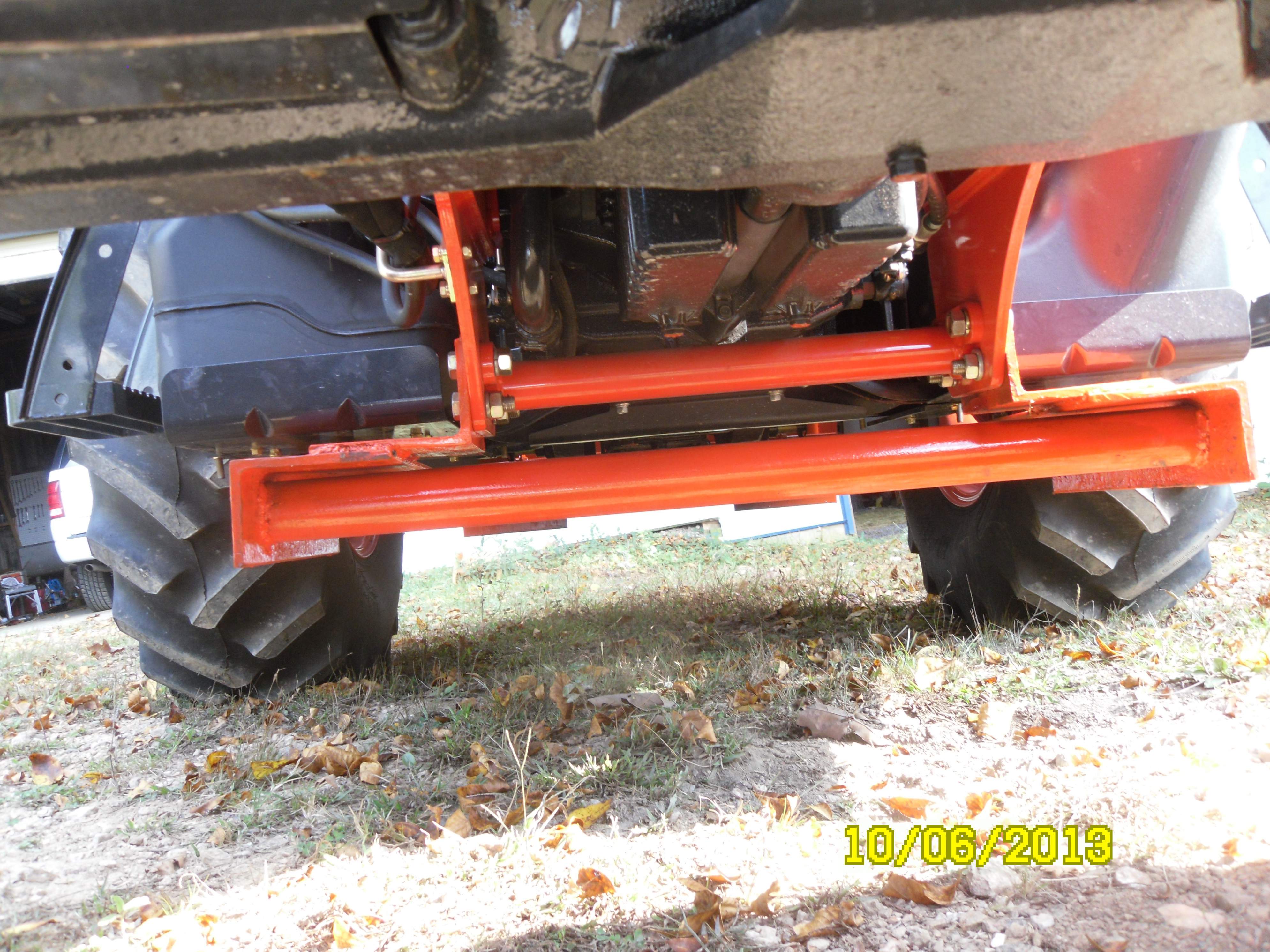

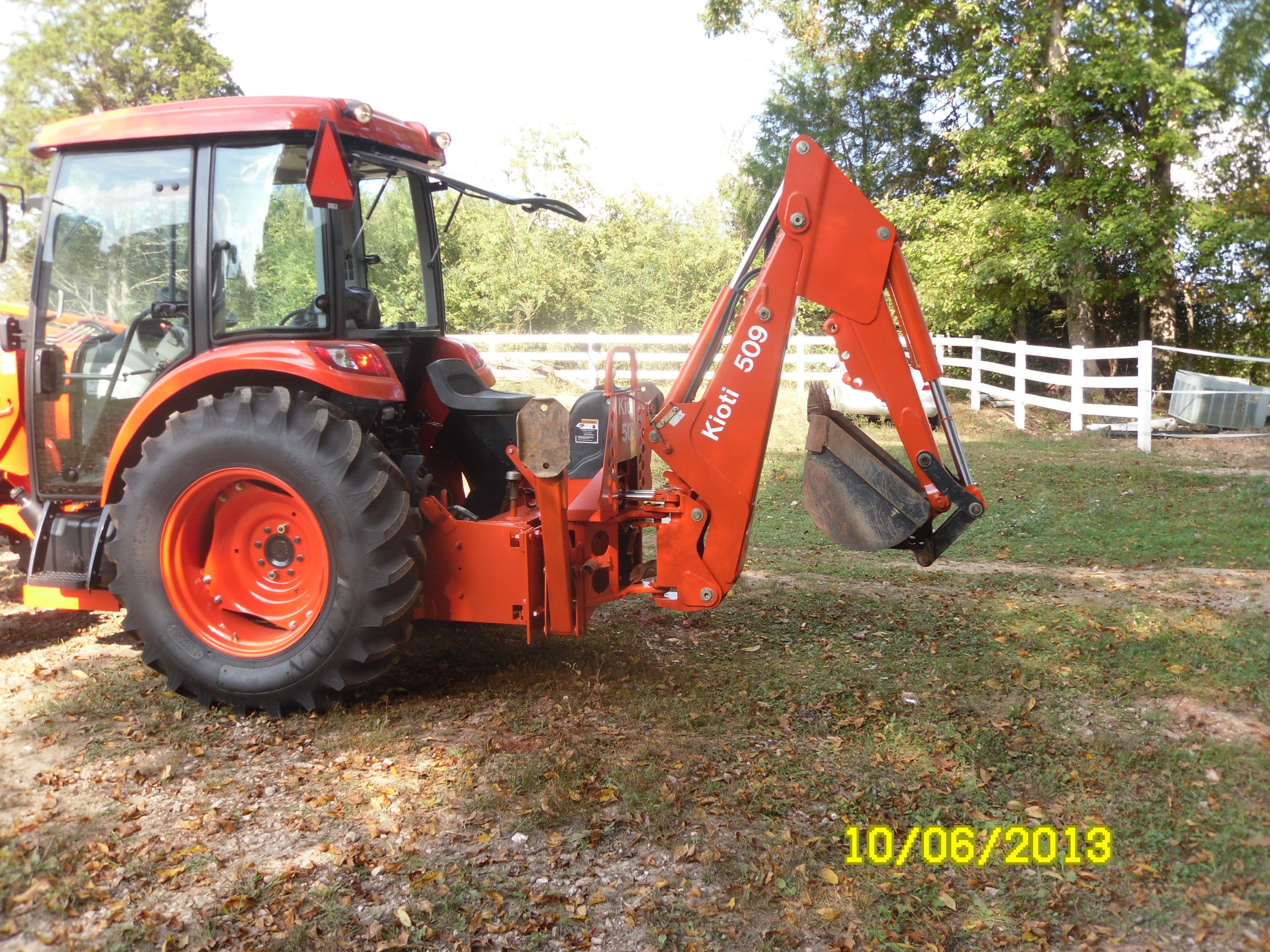

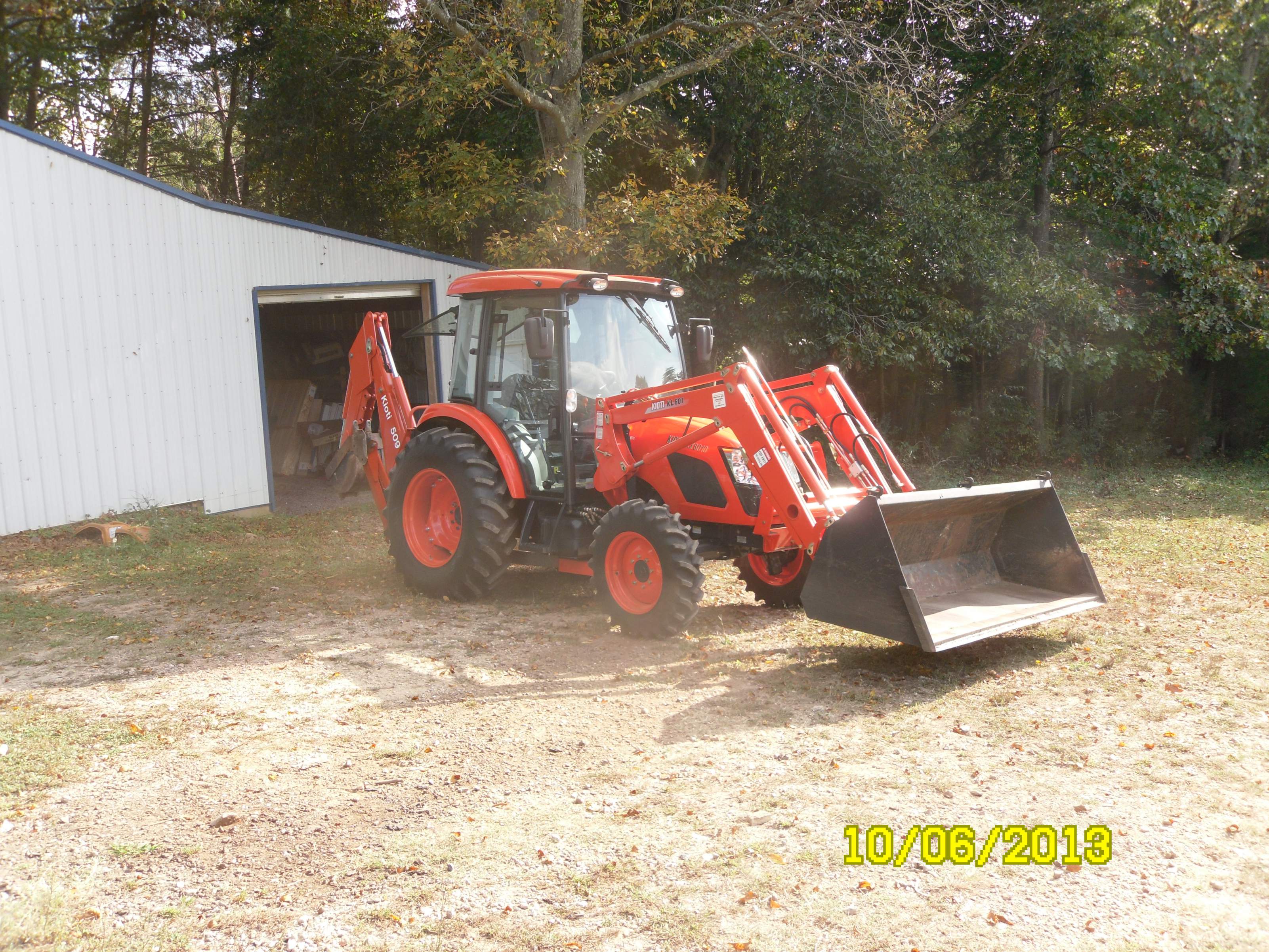

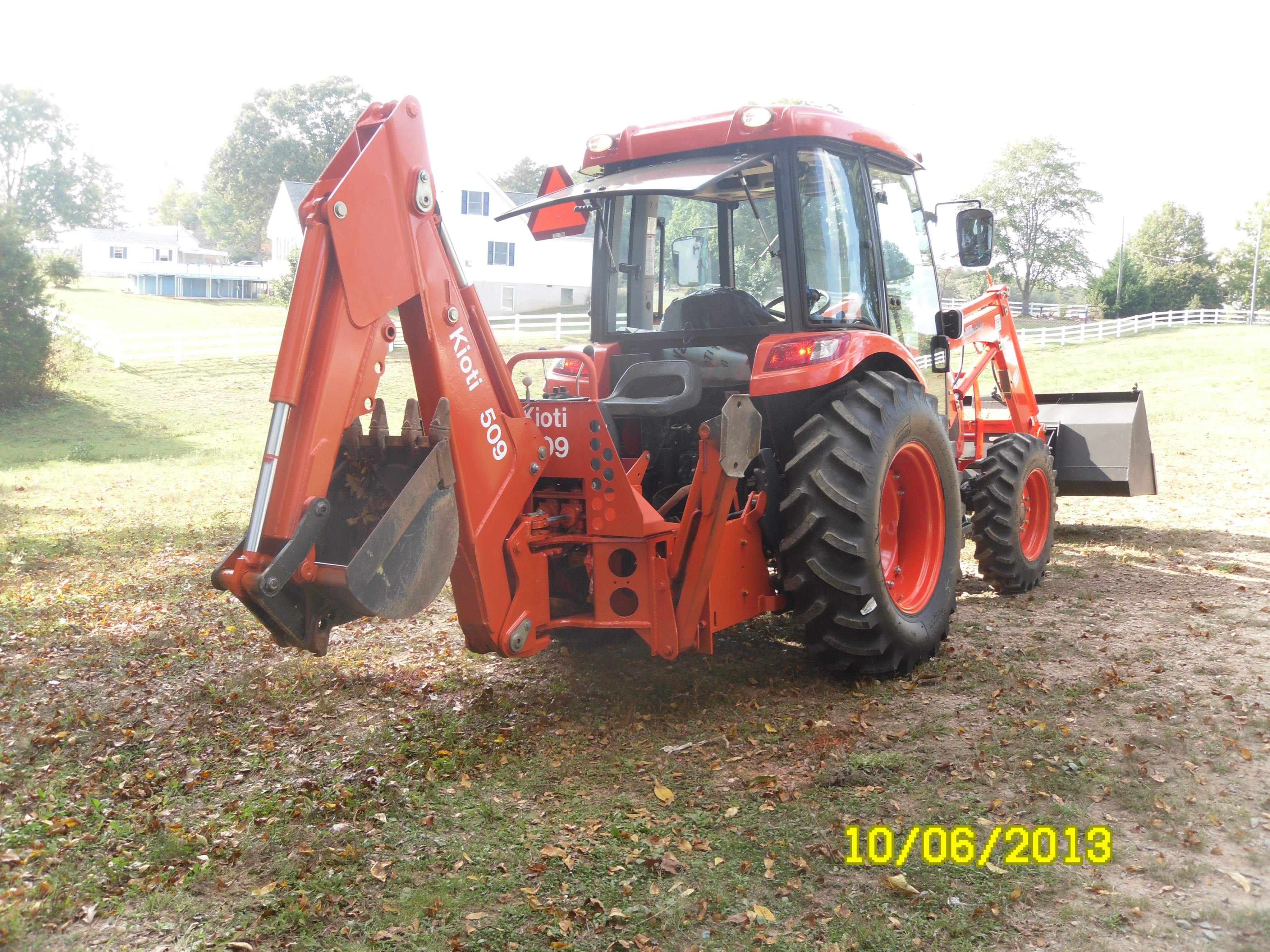

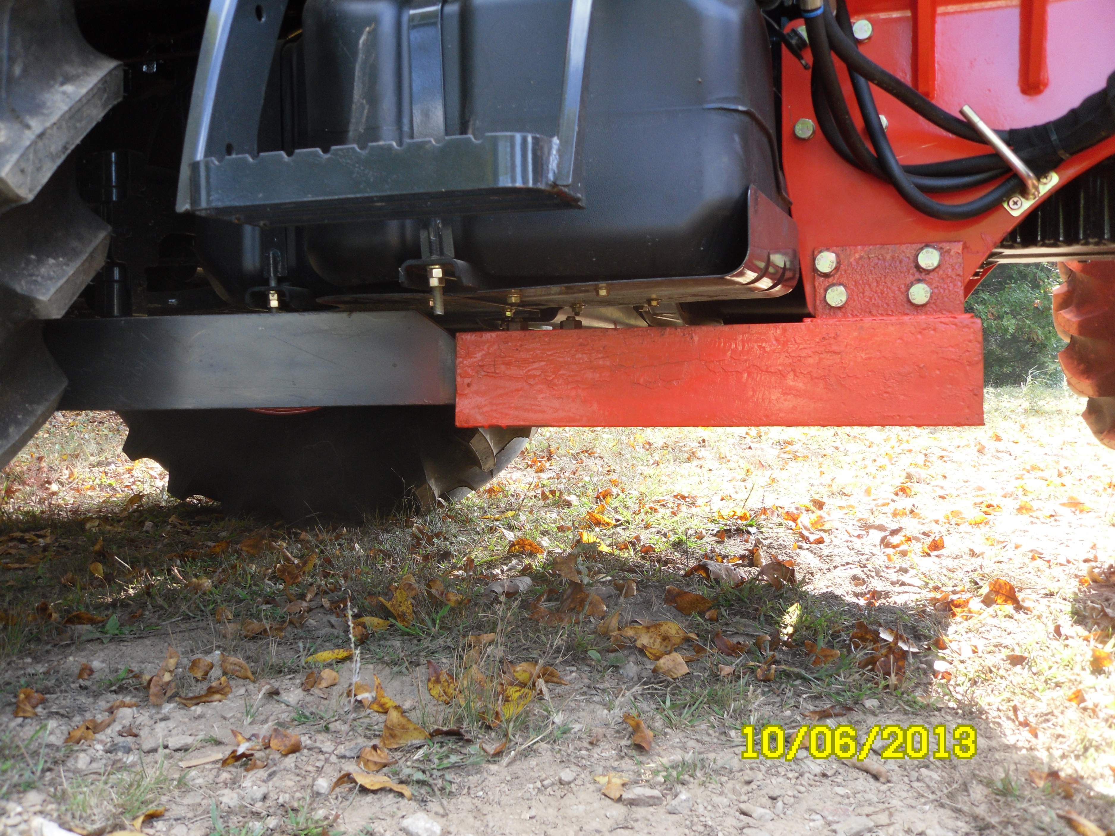

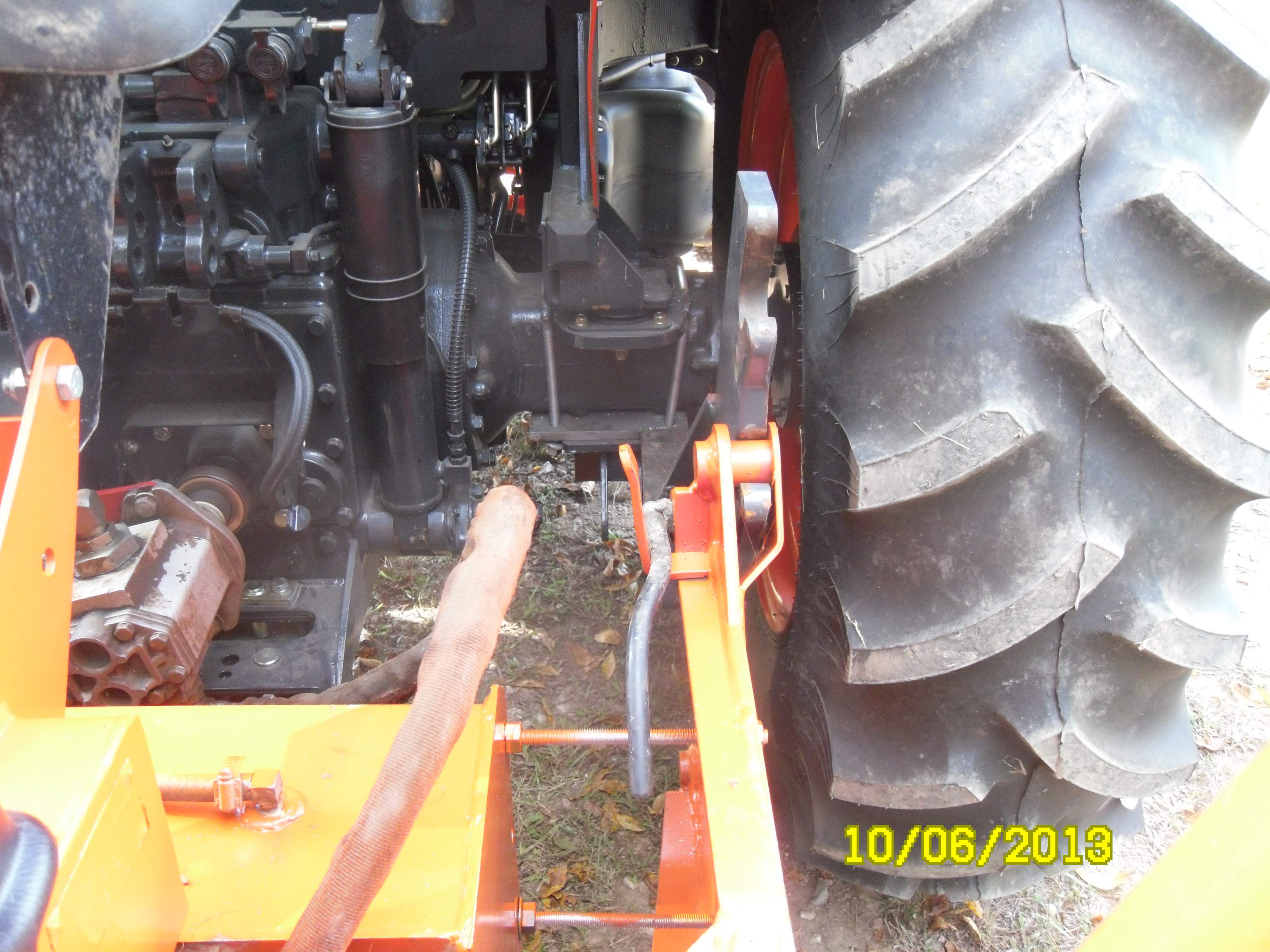

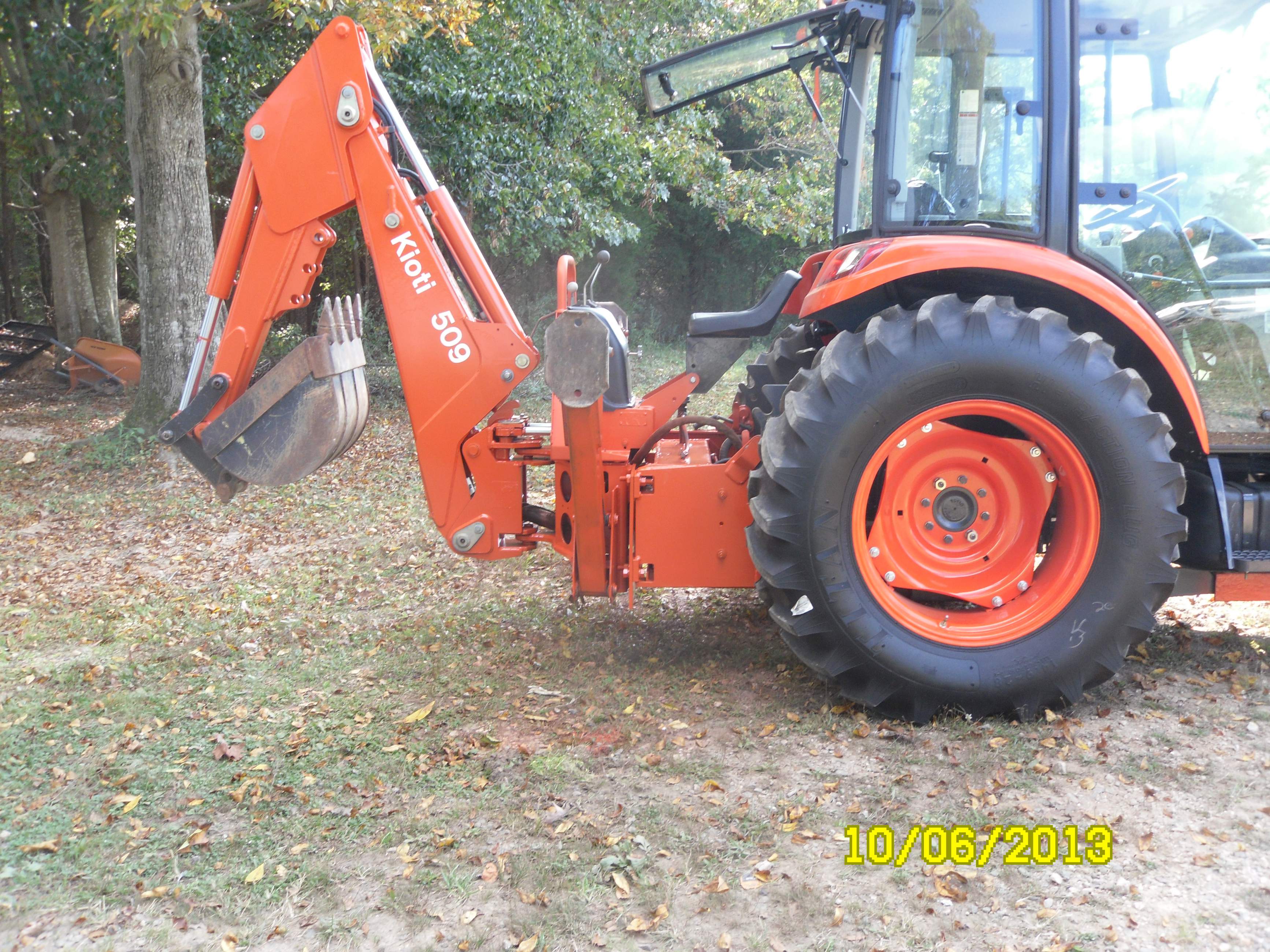

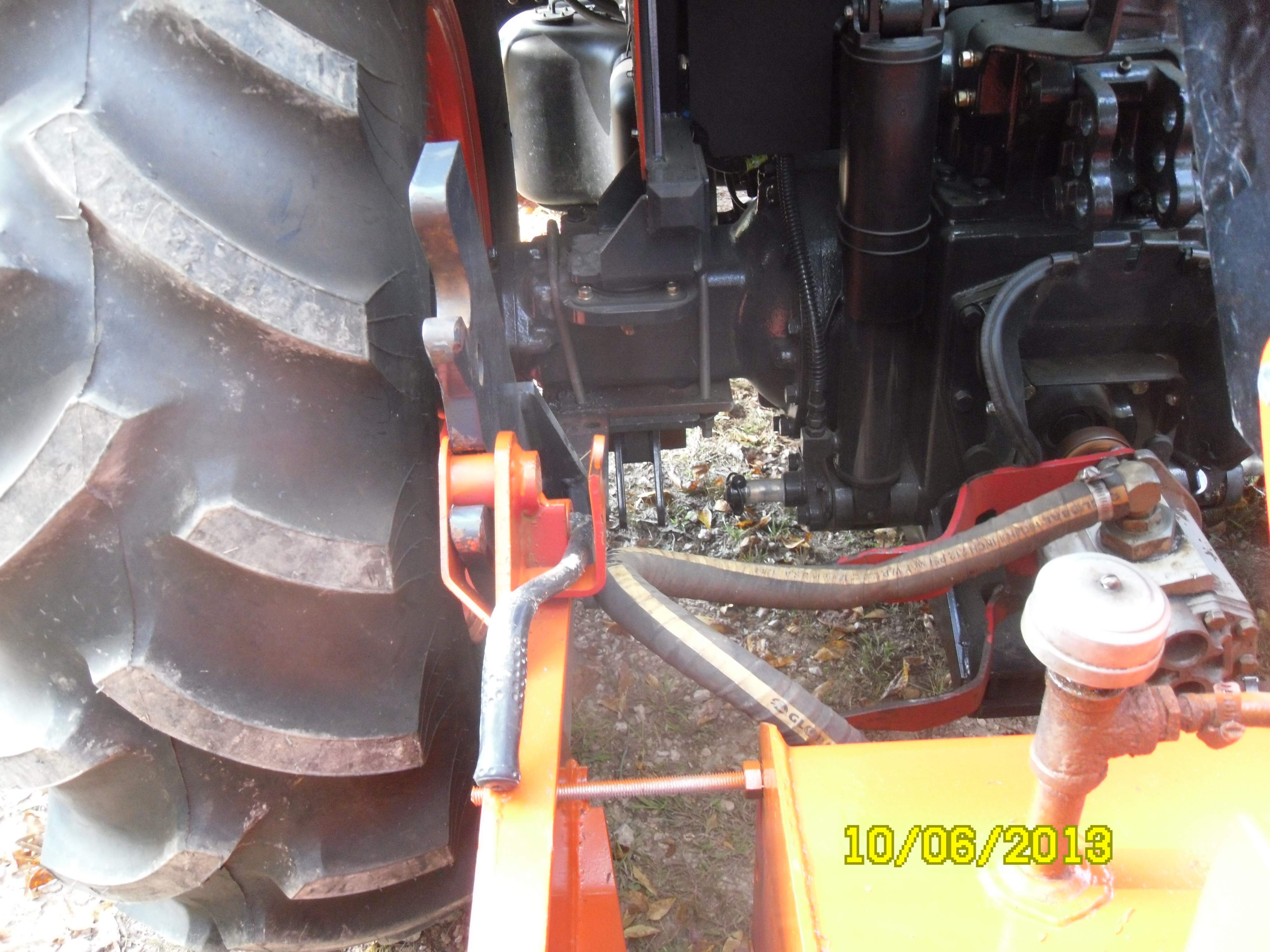

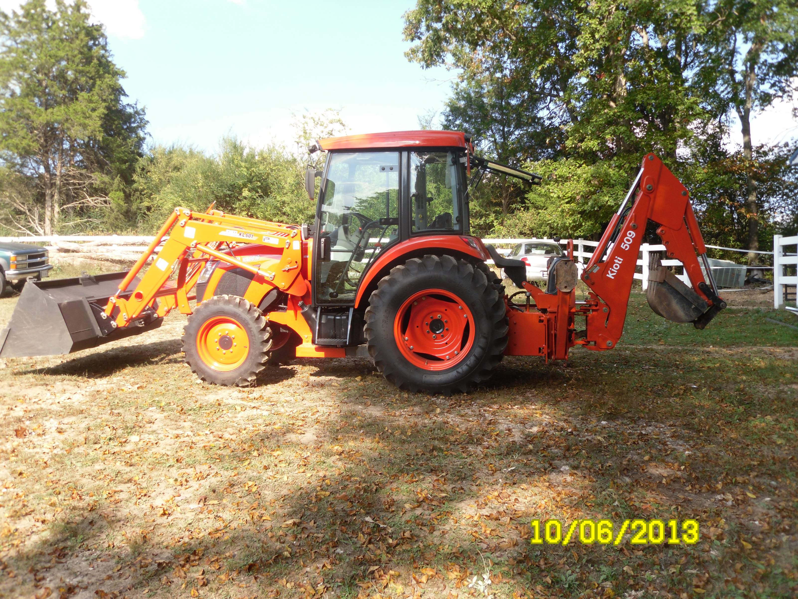

I completed the retrofit and installation of the Bradco (Mahindra) 509 backhoe. I painted it Thursday, I was able to get the paint scanned by a local autobody shop and it matches pretty well. On my Mahindra I had it set in the top slots of the subframe bracket but, that is way too high on the 6010, so I have the backhoe in the bottom slots that seems to be a good height. Here are some pictures.

Looks Great! Nice job adapting it.

So the hoe you have has it's own PTO driven pump and hydraulic reservoir?

The subframe is also a Bradco unit, I removed it from my Mahindra and extended it to fit the 6010. The original bars that run from the loader arms to the rearend were removed in order to make room for the Bradco subframe. I painted the backhoe to match and added the "Kioti 509" decals that I made with a sign machine. Nothing from a Kioti subframe is used on my setup, I hope I answered your question.

1). The original bars that run from the loader arms to the rearend were removed in order to make room for the Bradco subframe (Yes I removed the 2 orange rails that run the length from FEL bracket to rearend)
2). So the two slot brackets that you chose the lower slot to connect to at the rear, are they a quick connect for 3PH type items or something different? (They aren't quick disconnect and not designed for the 3ph, the hoe is very easy to install and remove. You simply remove the 2 black pins with handles at the top and lift the hoe out by using the outriggers.)
3). Your model is the only one I've seen those on to date. Is it because it's a bigger tractor and can pull bigger implements? (No, I used this same mount on a 35hp Mahindra. The subframe is very heavy and well made by Bradco.)
4). I looked on the Kioti website and it shows the KB-2485; same model I had on my DK-35, and swapped over to my current DK-40 fits your 6010 as a subframe mounted hoe. (I agree the KB-2485 is what Kioti has listed on their website as fitting the 6010, that is probably a very nice setup and I would have went that route if I didn't already have the Bradco unit.)
