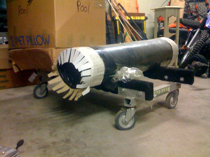

   / Backhoe Storage #9
I've been thinking about building one of these myself. I have what is called an AquaCart used for storing jet ski's. Seems to be a perfect size, just needs a deck. I don't know what the load rating of it is and it is all aluminum but seeing some of the others posted here I think it might work. Does anybody know what a jet ski weighs? It is a great cart and I don't want to mess it up so, I've been just looking and thinking about it but. Think this would work? My backhoe is about 1200 lbs.
   / Backhoe Storage #10
Jet skis, (sit down) weight up to 1000 lbs. The new ones are heavy! That doesnt mean that the cart is rated for that either..
by the way that is a nice cart. I have to build one for my ski...
