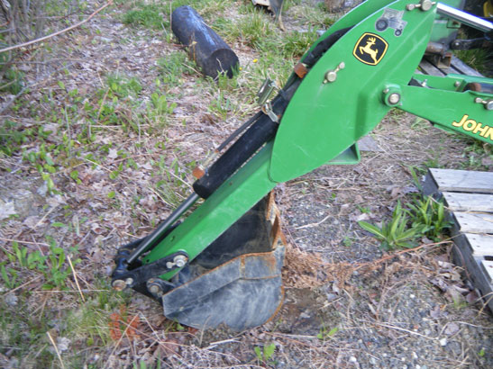

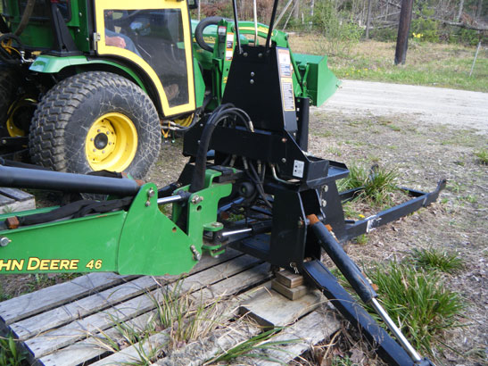

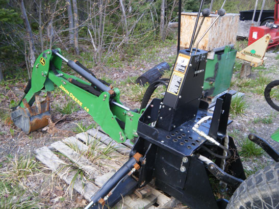

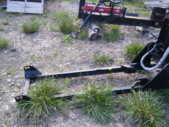

Ok not being Backhoe knowledgeable here is what I found out in my own words!
It looked like it was in good shape to my eyes (always a good sign to me), and was equipped with the optional 13" bucket
If you look close you can see surface rust on the fittings where the hydro hoses attatch to the cylinders, and also at the end where each cylinder attaches to the main setion of the b
Backhoe.
All the pistons were without any rust, but clean and shiny, and according to the owner do not leak any fluid.
I asked to see it operate and the owner backed his tractor up to the backhoe without attaching it to the tractor just connecting the hydro hoses, and demonstrated all the Backhoe boom movements up and down left and right followed by moving the bucket. All the movements were smooth yet responsive. His tractor was not at a fast idle.
The seat is not in the picture. The owner had removed it as it interfered with his Curtis cab. He showed me the seat and all the attaching hardware that are in as new condition. He also had the safety plackard and the instruction manual.
It appears that those spots where the surface rust had formed must have originally been unpainted metal as all the pistons seemed to have it in exactly the same area. on the closed end of the cylinders.
I was thinking that some PB blaster might help me clean up those spots along with a tiny buffing wheel on a dremel followed by some fresh primer/paint.
It did not appear to have been worked to death, but unfortunately left outside hence the surface rust.
So now it's just a matter of arranging help to transpost the unit.
Which begs another very important question just how would you lift this thing onto a trailer. The seller offered to lift if using his 2520.
I believe the backhoe is 900lbs all assembled, and the 2520 can lift 1031lbs to 59" at pivot pin. I hope that means we can lift it onto low car hauler.
Not sure yet where to even hook onto the backhoe or even if we should try to dissemble some parts before loading.
Anyway It has a 13" bucket and more importantly the 2520 sub frame for my 2520. The only thing I need other than ordering the power beyond is the bracket that needs to be changed out on the rear of my yet to arrive 2520. I'll check with the dealer tomorrow AM.
I offered and he accepted $3,200. I think I made a good purchase.

More importantly don't forget to get the loader arm brackets from the guy that are used to attach the front of the backhoe sub-frame to the tractor and also the two large front pins, they ain't cheap...I know.
