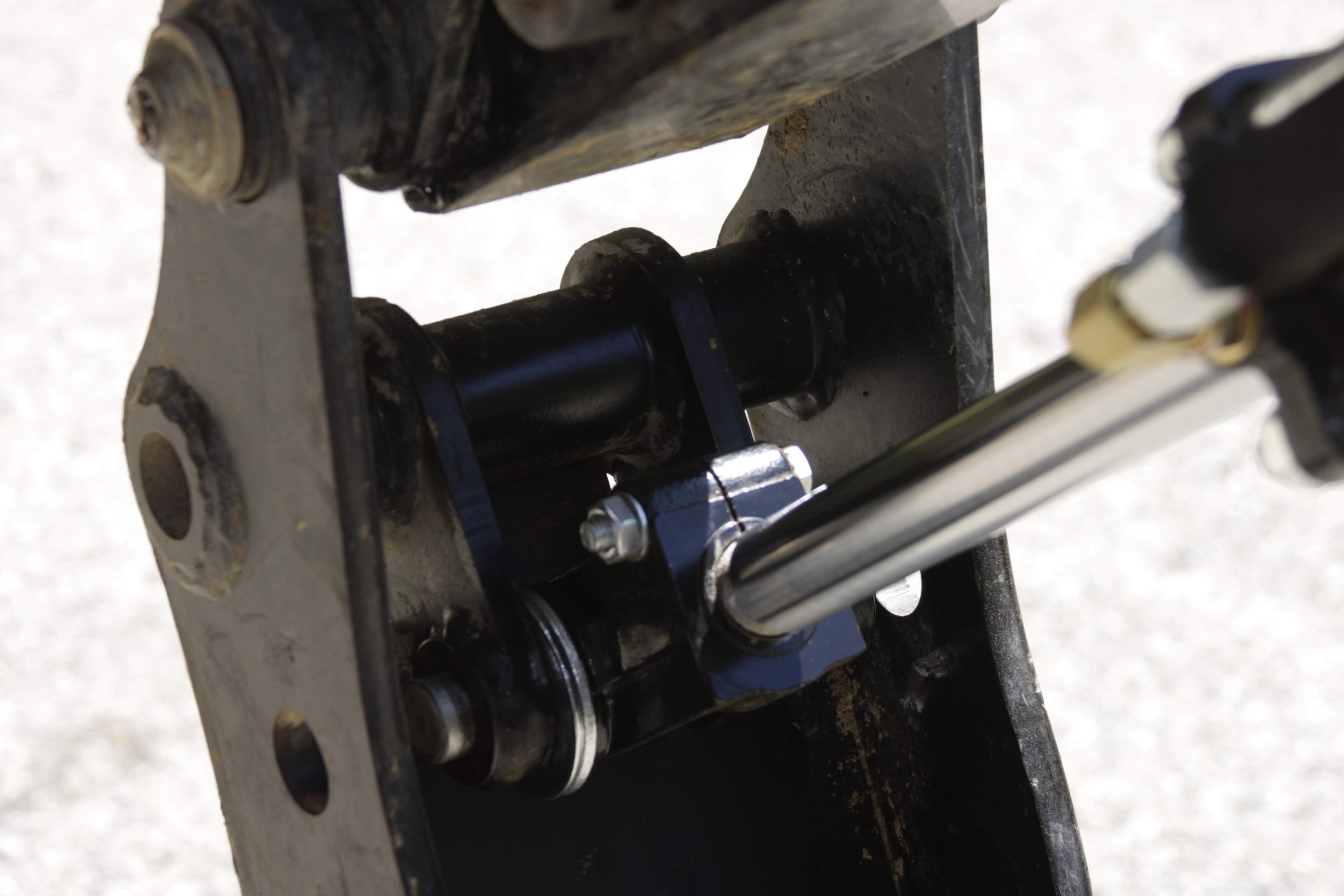

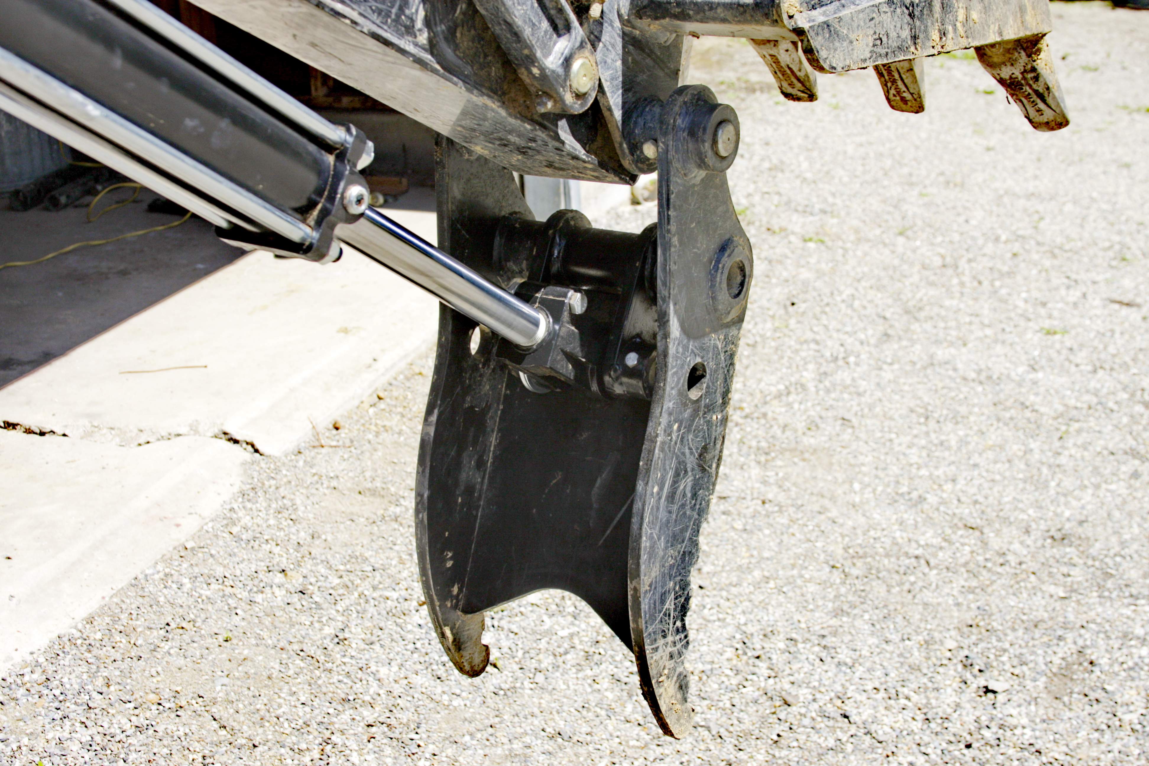

Speaking to the idea that the pins are installed incorrectly, they are not. The pin for the hyd cylinder is installed exactly as the manual tube was installed. There are no extra holes. The unit is a weldment and given the fact that the hoe is still under warranty, i would not start changing things .I have included some pics to show the setup. I have also included a woods / Kubota 9' hoe setup with the hydraulic thumb.

   / Backhoe thumb retrofit #22
I now see what you are talking about . You are right. That is an odd way to connect the rod end. As I said before, mine has three holes for mounting the cyl, and the closest one to the pivot point will generate the lesser force. It looks like you will have to install the relief valve, or bore some new holes for the thumb. Another option is to change out the cyl for one that is not as strong.
