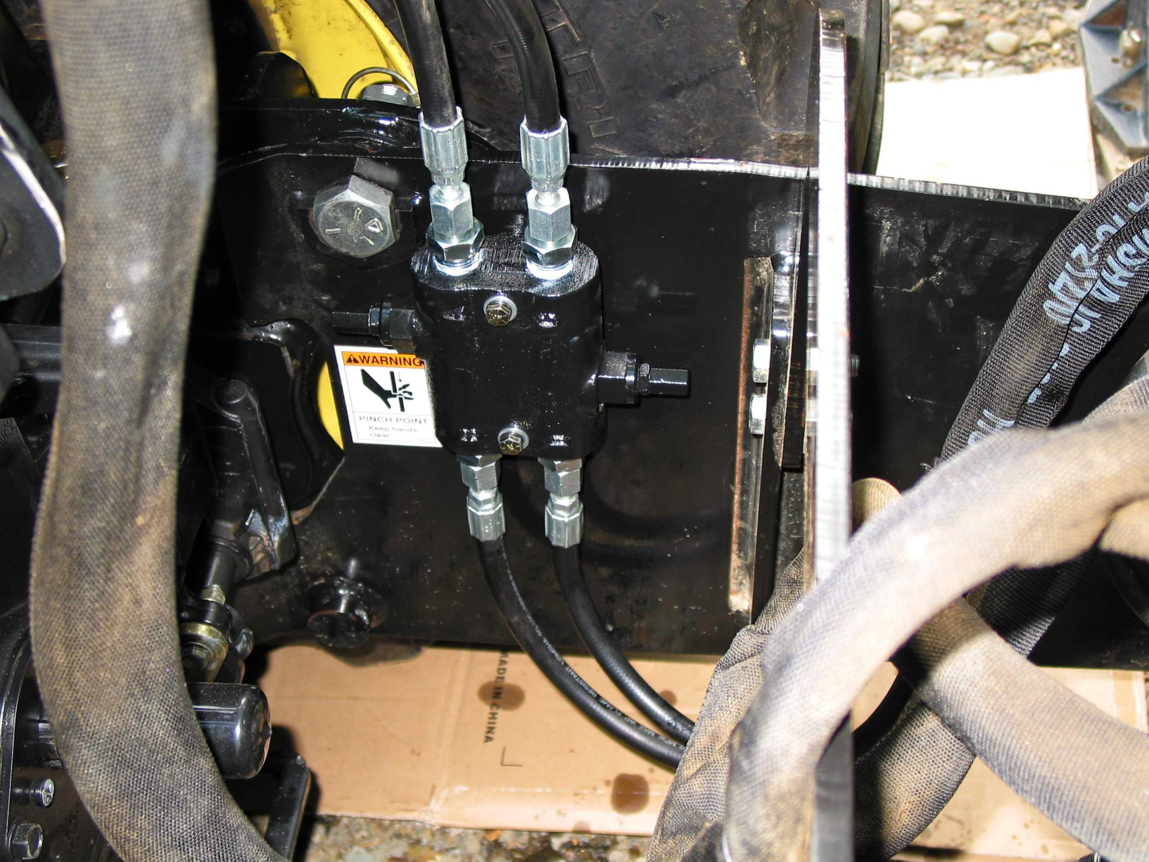

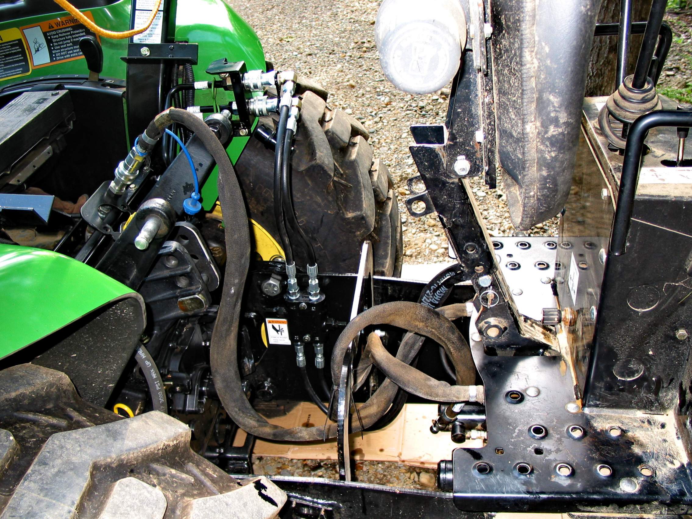

I plumbed up the crossover valve tonight and I have to report that it works awesome. I was able to adjust the extend circuit of the thumb cylinder so that no matter where it is, it cannot move the bucket and vice-versa. Thanks KennyD for the fix and thanks to all those that chimed in to help.

Nice job Bob:thumbsup: Thanks for reporting back.
