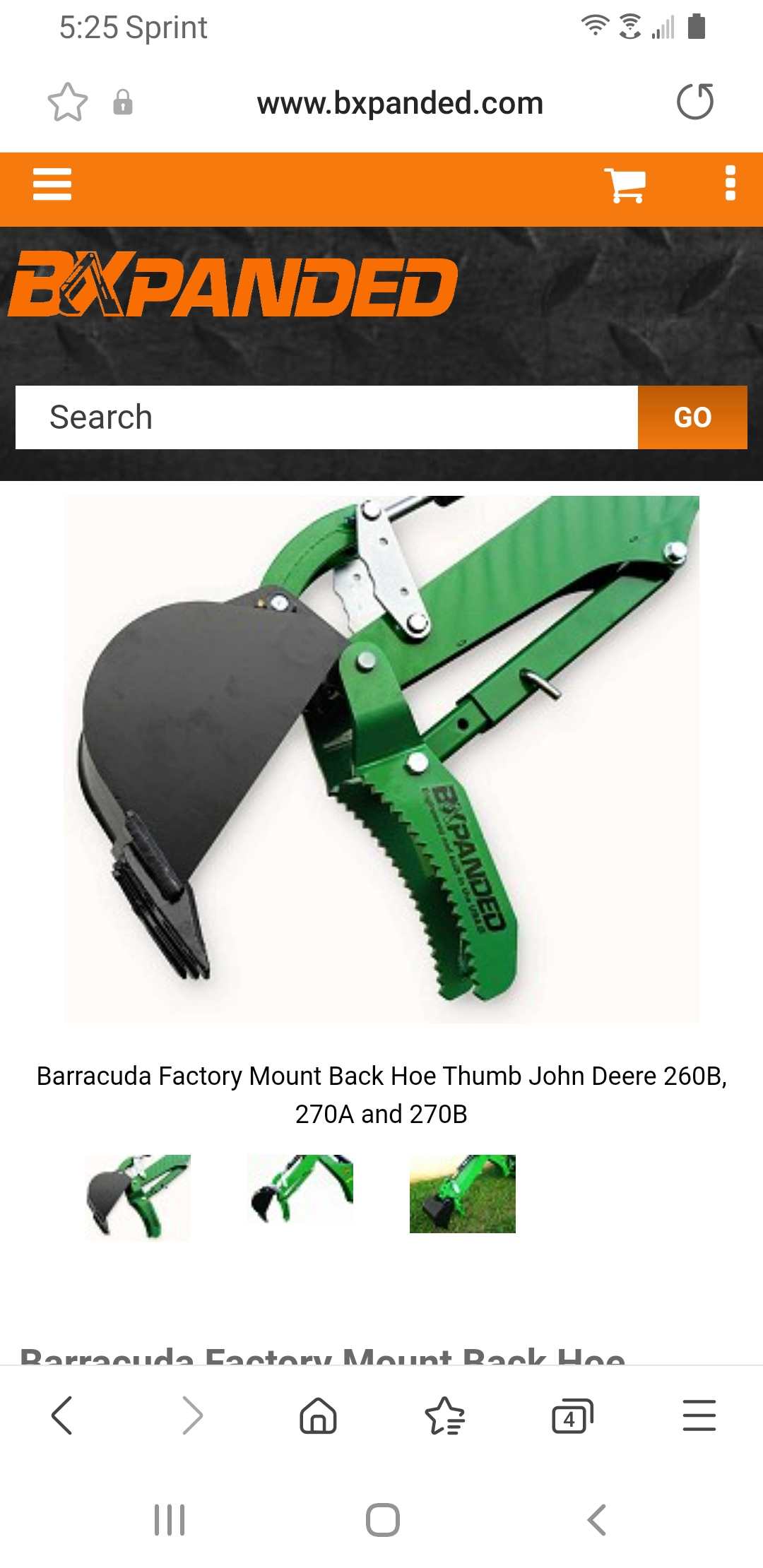

Great question. I'm also looking at adding a thumb to a 26B. The Mahindra thumb seems like big $$$, if you can find one.
BXpanded has one that supposedly fits Mahindra's two small backhoes.

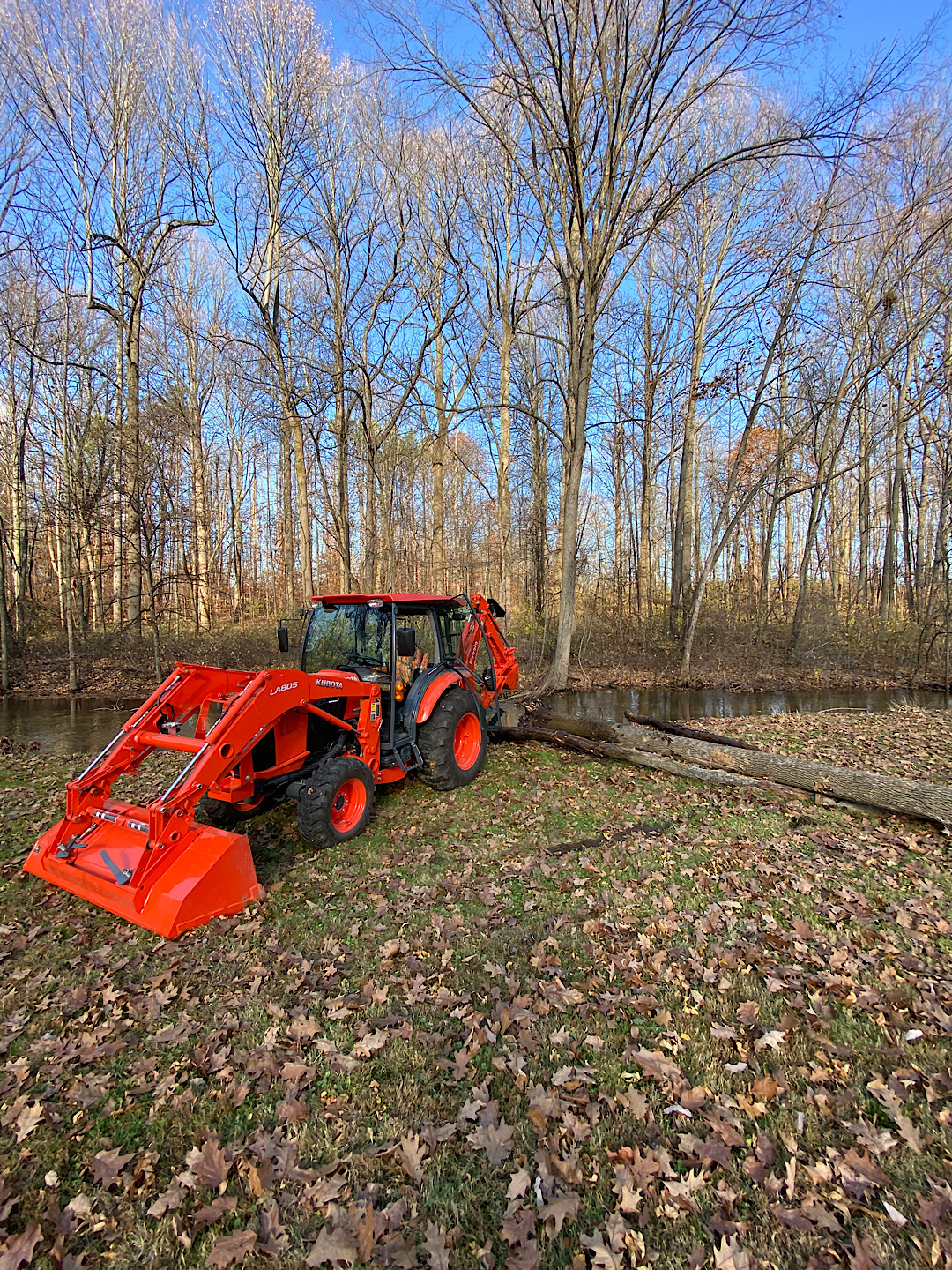

Thumb is a must - dragged this tree across that fell in creek from the other side. Hydraulic would really be nice but I’m getting by ok. It’s really easy to pull stumps and shrubs with the thumb, after digging around them.

Welp, I just ordered a thumb from BXpanded. Had to call as it's not on the website. Was told it's fashioned (bent) like the JD 260b. Only difference for the Mahindra 26B is the telescoping bracket hole is in a different position.
Had them in stock, Mahindra red too. Ship by end of the week.
